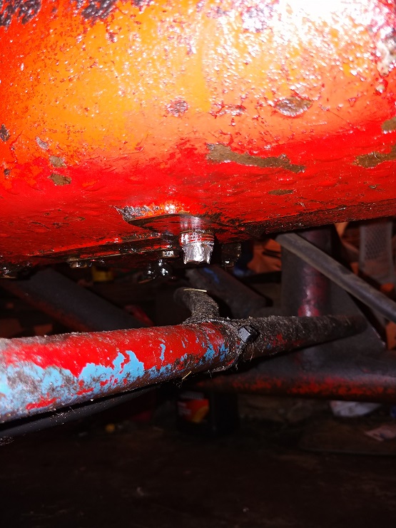

Except Kando(oo) has already tried that most ancient of tools (the pipe-wrench) and, not only did it not work, it was the main cause of the drain plug being rounded.

Last resort...
1) 50 ton bottle jack under plug
2) that will push plug up into case
3) drill and tap hole next size larger
4) fish old plug out larger hole with magnet
