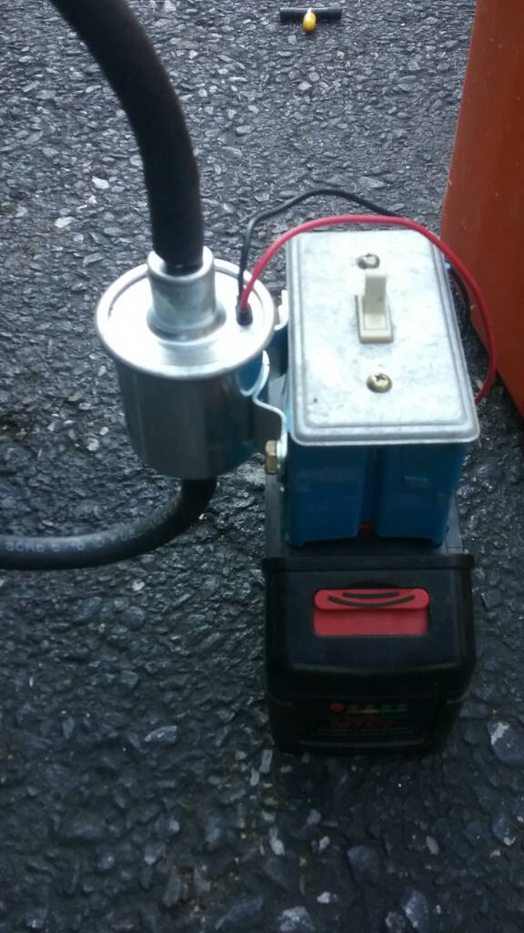

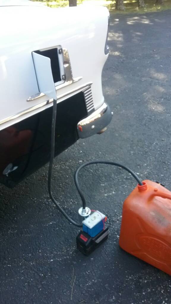

A universal fuel pump like this works also, self contained like this using a battery or just clip lead it to a car/tractor battery.20181023_152619.jpeg20181023_152608.jpeg
