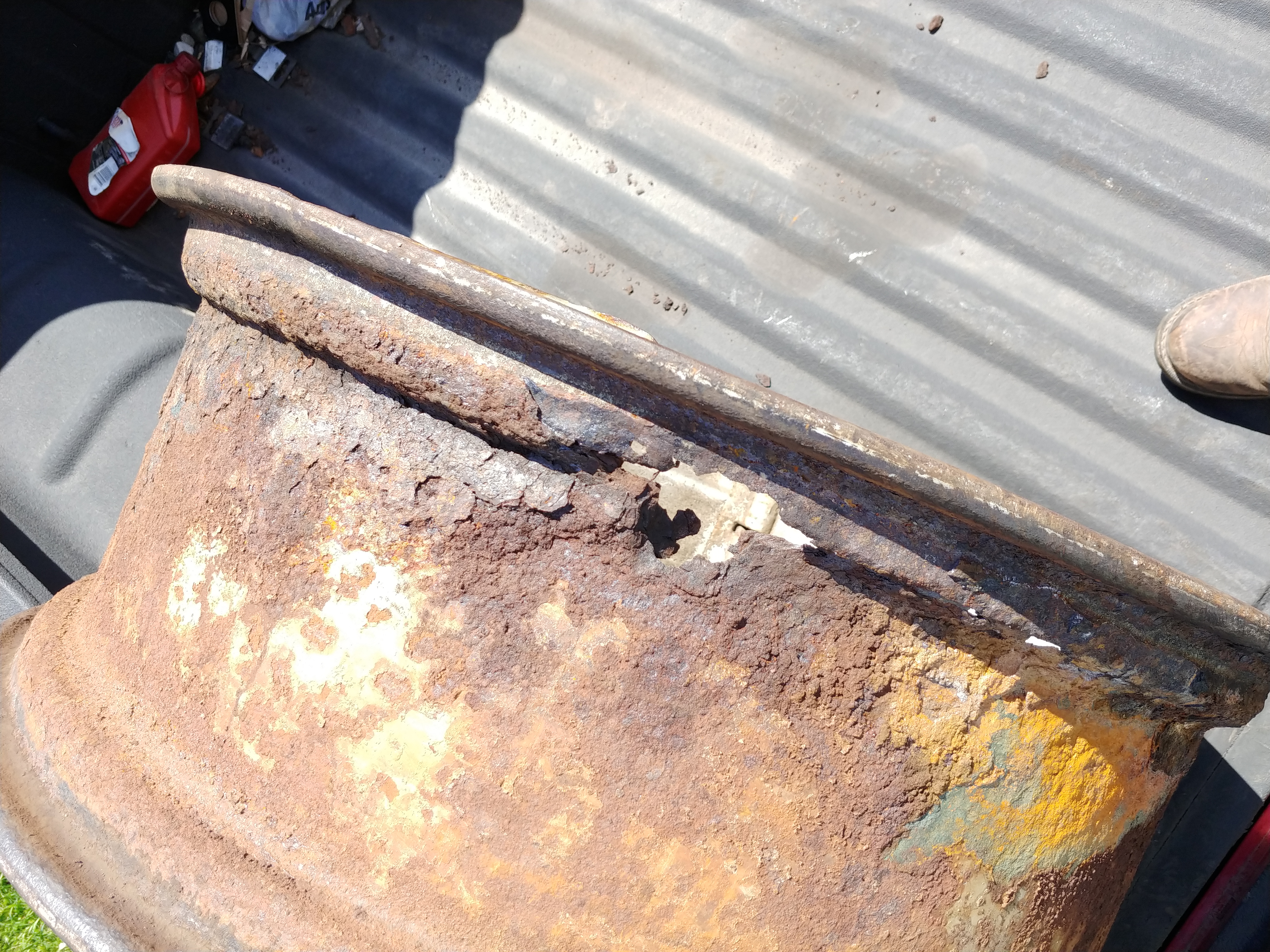

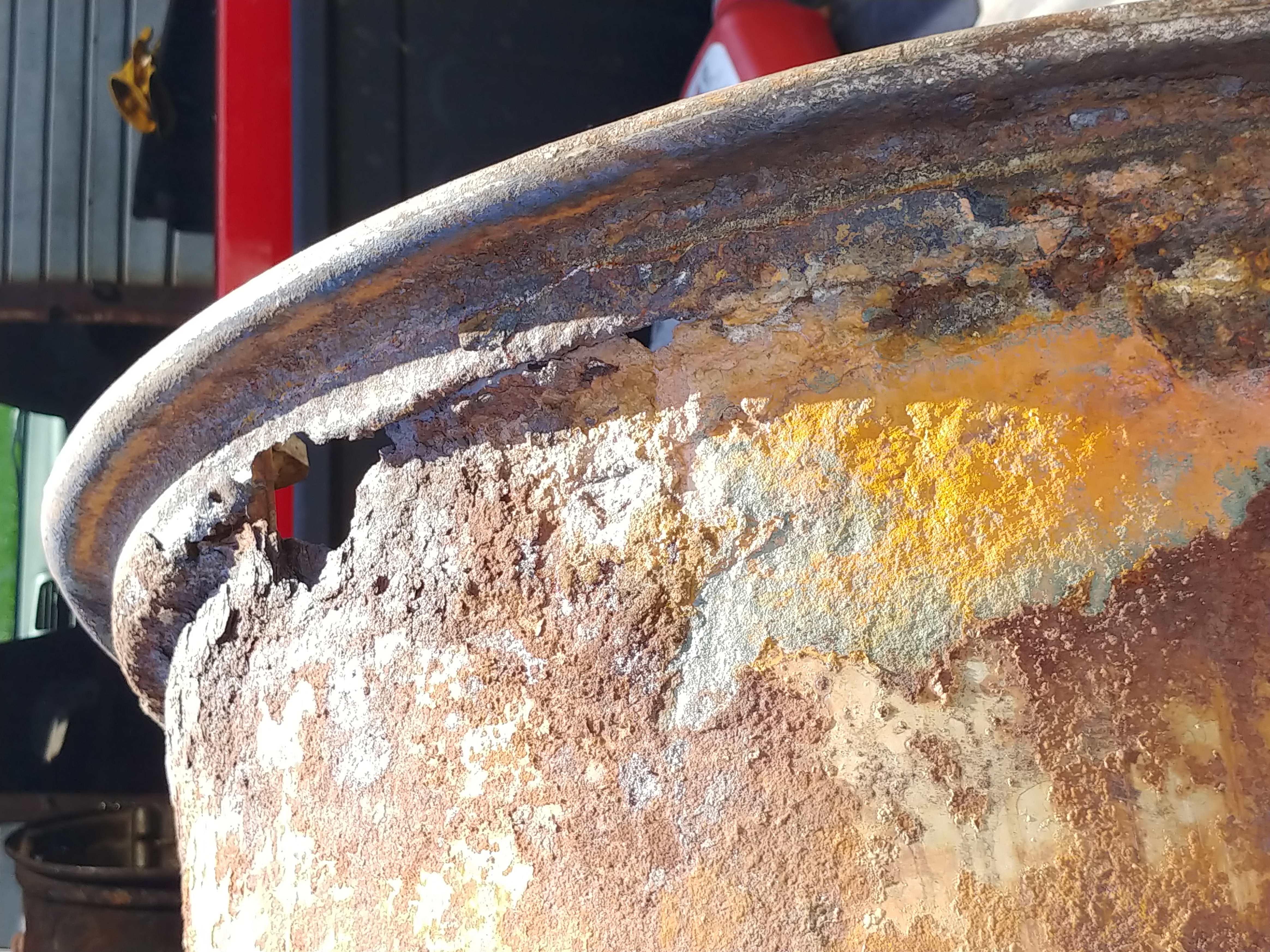

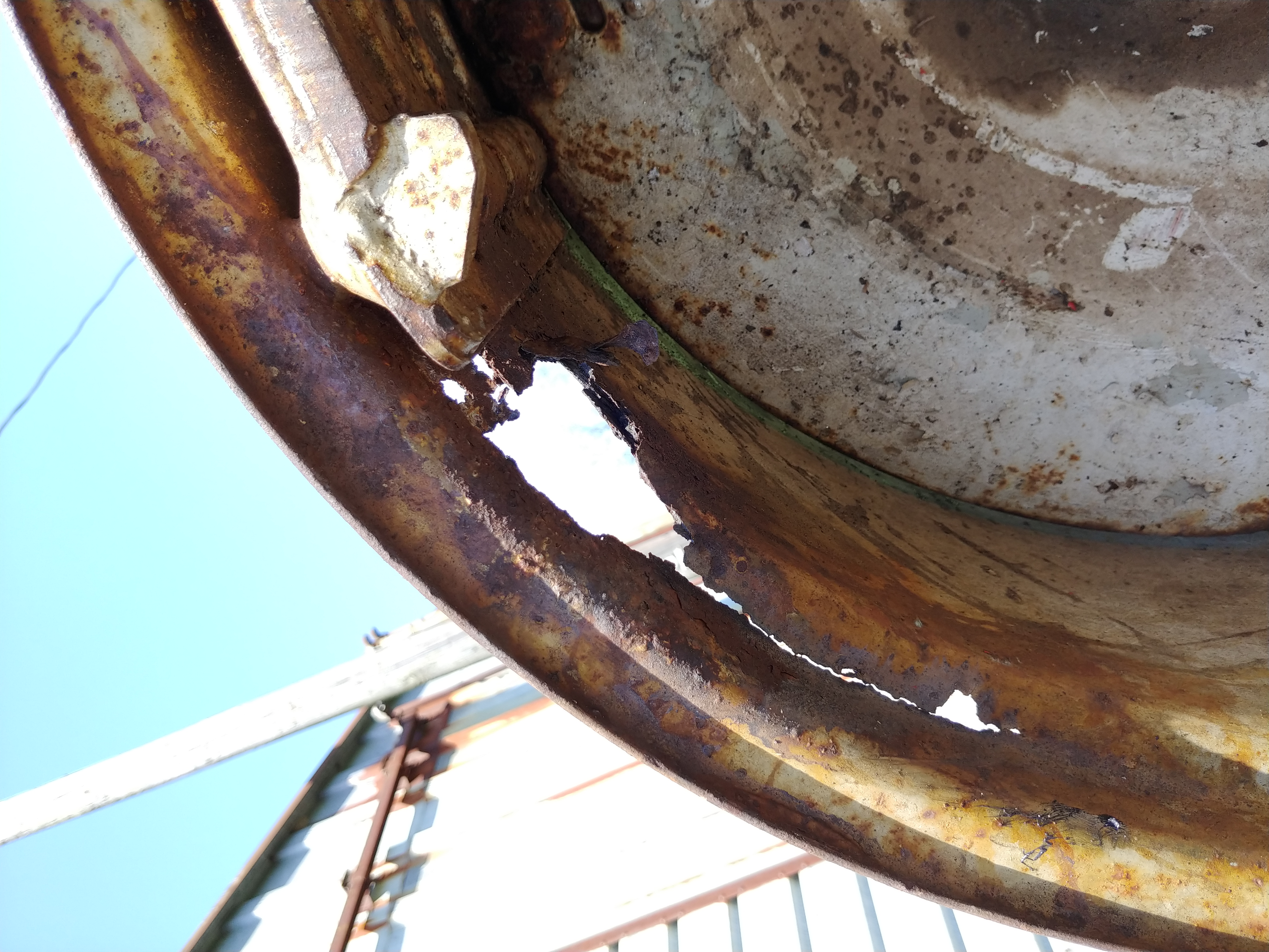

Here's the state of the rim. I don't know if it would be worth sandblasting and patching at this point. Getting a normal set of rims wouldn't be an issue unless I want to use the plow. Current rims were adjusted for the 2 bottom we have.
There's a bit more cracks and thin spots on the side wall of the rim that I didn't take a picture of.
/ Rounded off drain plug #227
Those are about the worst wheel I have ever seen. I'm going with buy new ones unless you are a capable welder with experience and a pile of sheet steel plus a press to make those repairs. Owning equipment sometimes costs money for repairs and this looks like one of those times but that's just my opinion.

What is the reason you can't leave them set at the plowing width all the time? Do you need them spaced different for some type of row-crop work?

I would only attempt to fix that if there was no way to buy an new one. Repair will cost more than a new rim if you have to take it to a shop.

Those rims don't even qualify as JUNK !!!

Putting air in the tire would give me the willies after that was was repaired!!

For the cost of new wheel loops, I'd just go with new ones. I don't even remember what kind of tractor the OP has anymore, but even if he had to buy wheel loops that had the incorrect fastener spacing and just have a weld shop relocate them to the proper positions he'd still be money ahead of trying to repair those.
What I meant was that new unadjustable rims might not have the proper width set for the plow. However, I'm sure I can repurpose the other spin out rim on the tractor and switch it to the other side, then adjust it where I would need it and put a normal rim on the left side.
/ Rounded off drain plug #236
I think even if you have to go with new loop style rims, they will still be fully adjustable in 4 inch increments (2" per side) and can be set up for a 2-bottom plow. You should be able to set them either 52" or 56" for the plow.
I would not go with solid fixed/non-adjustable rims if you can avoid it.
/ Rounded off drain plug #237
I've welded on several rims, last summer I spent 10-12 hours welding and grinding on one for my 574 that said, I would consider that rim almost unrepairable and replace it with new or good used.

I think the op's situation is that his rims are the early style Ford spin-outs, not loop type. It can be hard to find new rims to match the spin-out center rails. That would be the way to go, if available.
Some times if only a sector of the tim is rotted you can weld in a section cut from another used rim of the ssme size, relocate valve hole, etc.
