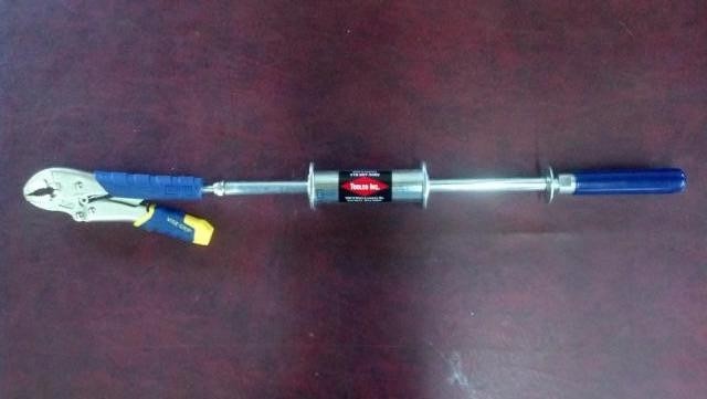

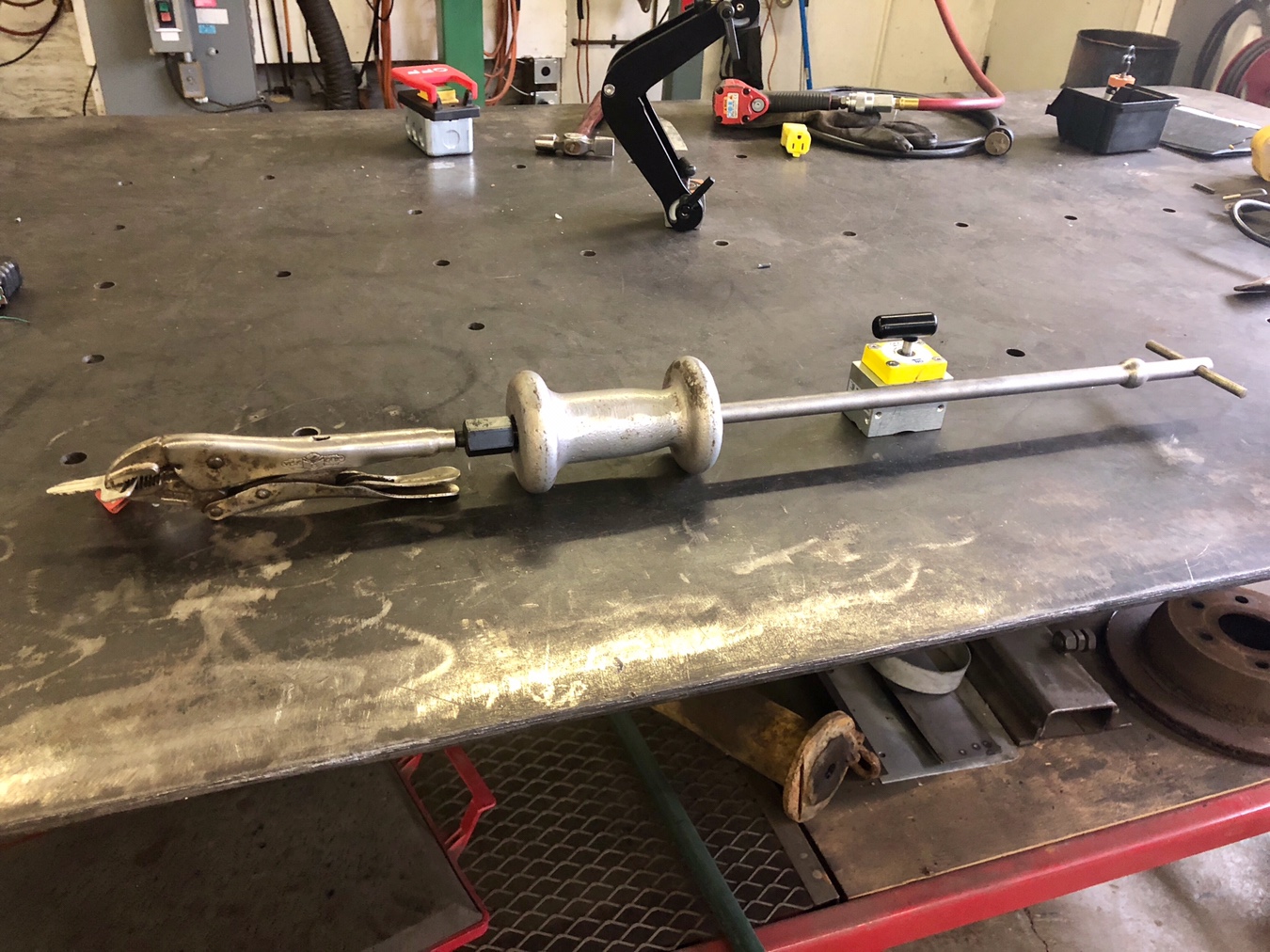

Did you fabricate that? That's a useful device!
No, I知 not smart enough for that. The vise grip adapter came with the slide hammer.

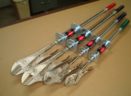

I also bought one that is made for vise grips:
They come in different sizes:

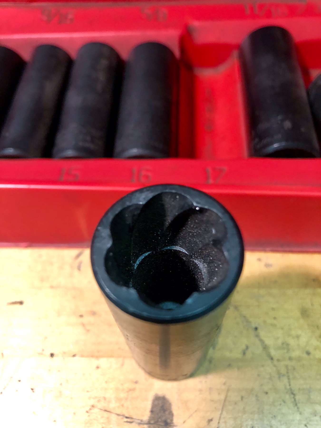

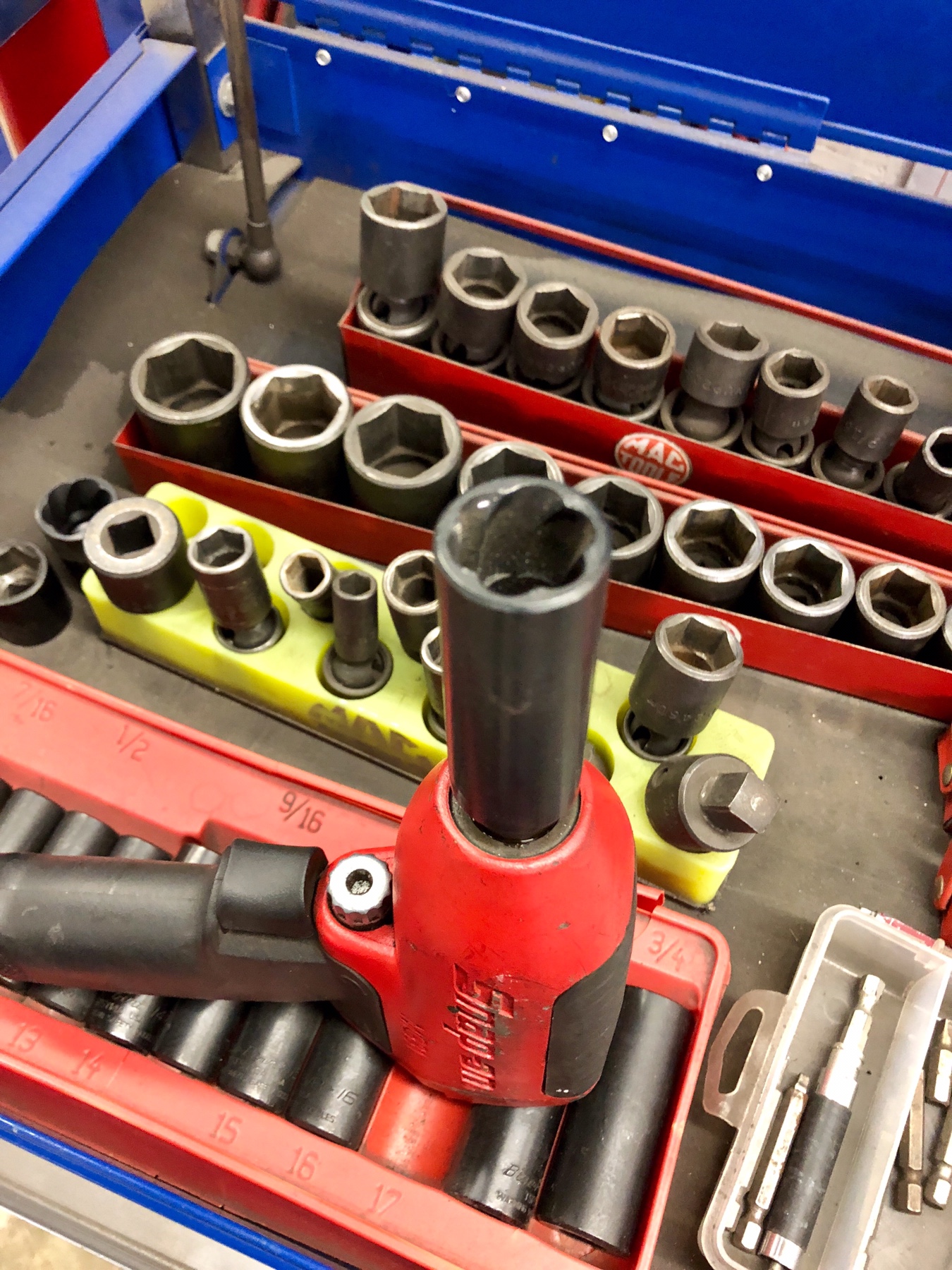

Probably not that anyone even cares at this point, but these “damaged head bolt extractors” would most likely remove the plug no problem with the aid of an impact wrench.
No sooner said than done. I do believe we found our Huckleberry.
   / Rounded off drain plug #1,189

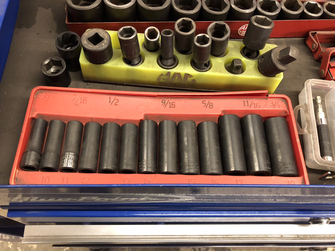

How about sending the first one that show's he has proper tools?
No way, you should be disqualified....:muttering::muttering:.....keeping Mac tools in a snapon box AND using a snapon impact wrench with Mac tools :shocked:.

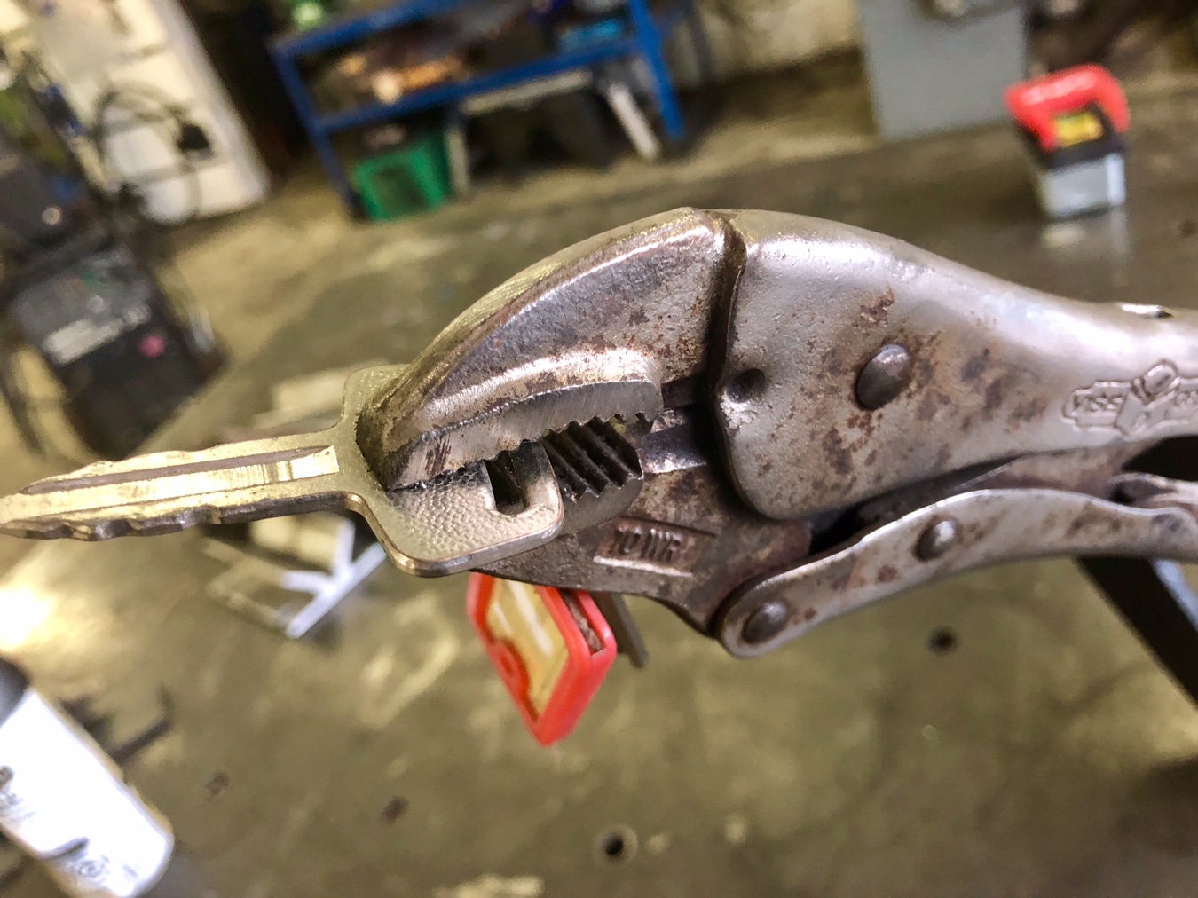

I said that twice already. Gave up and went ridgid pipe wrench.
