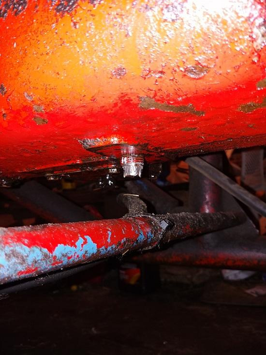

Hello TBN,
Trying to change the fluids in my Ford 960 and ended up rounding off the head of the transmission drain plug. Haven't tried channel locks yet but I don't think it'll help. Beyond removing the plug, what could I use to replace it? Would a short bolt work? Looked through messicks and new Holland's parts but the plug itself seems to no longer exist.

Not to dredge up the past but I stumbled onto this clip of how to get a stuck oil pan plug out that is too buggered up to get a wrench on. It's how to weld a nut on to the old plug and then back it out. You should watch from the beginning because we go the pliers and wrench route that both fail and then on to the success of welding a castellated spindle nut on. Anyway, it came out.

Here's how you do it.

Just a couple of comments,
I usually try and hold the nut with my ground clamp.
I don't like passing that current through threads and fittings.
Also if he could have let it cool between welding and trying to unscrew it would have worked better.
