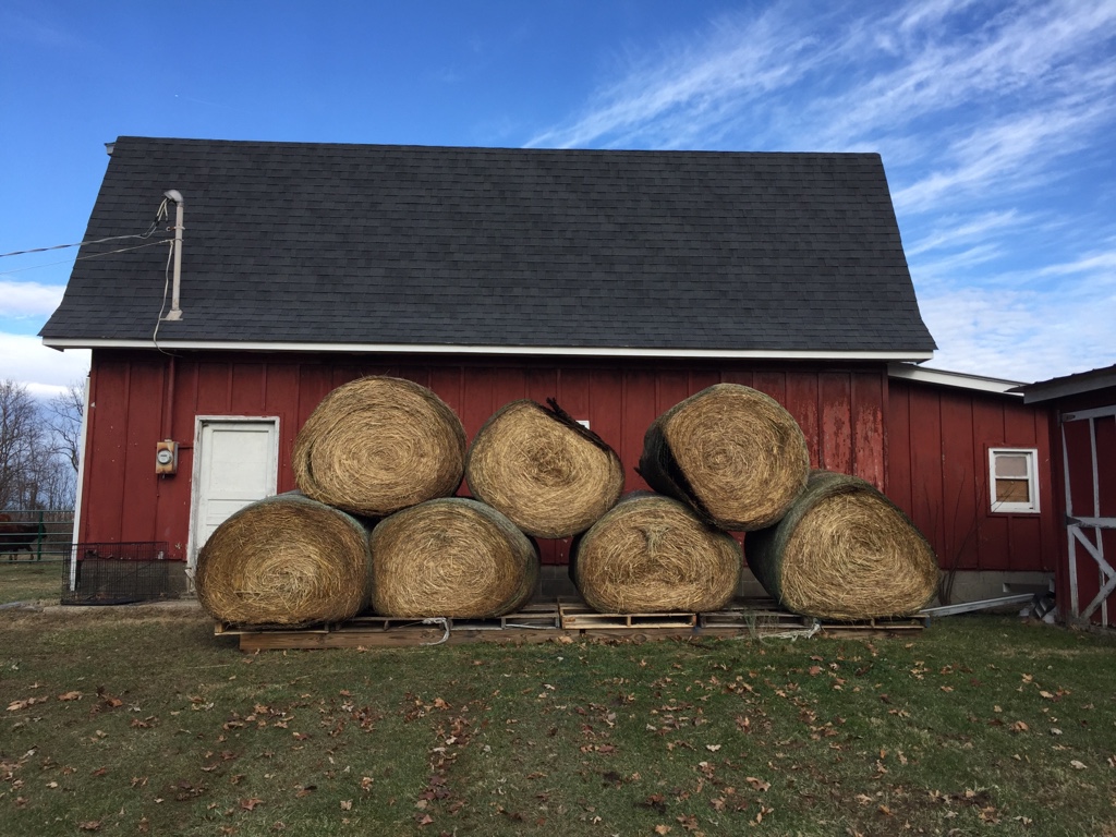

Just got it all stacked today and covered with a big blue tarp. It will be all gone in 7-10 weeks by the way my cattle eat.

John - if I may ask, where are you getting you bales? I ask as they sure look loose. Being that way they will spoil quickly as can be seen in the photo. If your bailing them yourself, check you tensioner.

I'm buying them from a local guy for $20 each to get me threw the winter, the cattle eat it just fine, there not very good examples of round bales but there cheap.

just saw the thread. You may be OK like that as long as your tarp is taut and sheds the rain/melting snow.
In the future; as others have suggested don't stack bales so the sides touch. Put them tight end to end and separate the rows by a foot or two. On the ground is fine where I live, maybe not where you live. Net wrap bales shed moisture really well. Your climate is different than mine, but stacking round bales like that in my climate is about the poorest way possible because they gather rain and snow and the moisture has no place to go except into the bales.
Even bales placed randomly with air flow around them will keep well, especially net-wrapped ones.
If you insist on stacking bales one should go on edge and the other on its side on top. This isn't even acceptable with net-wrap, IMO. Only marginally acceptable with twine.
Make sure your tarp stays in good shape and you'll be fine this time.
I stack hundreds and hundreds of bales in rows every winter. I have tried several ways over the years. The worst luck I've had is in a "pyramid". I only did that to save space. Once. Ventilation and high ground is king. Unfortunately, we plan on 220 days feed a year around here because we need 210. Seriously. Unless your climate is very wet the bales can just sit out. Spaced out.
And tight bales keep a lot better, as already pointed out. 20 bucks is cheap hay. Cows need good food just like you and me. In fact better, cause we don't have babies. Hungry animals will eat anything if they are forced.
