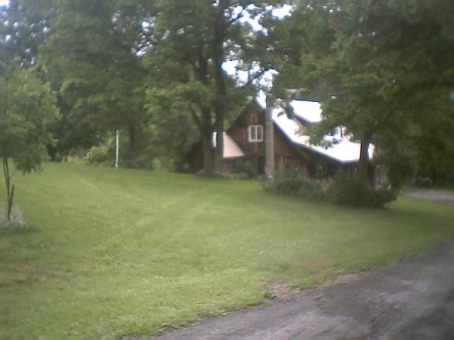

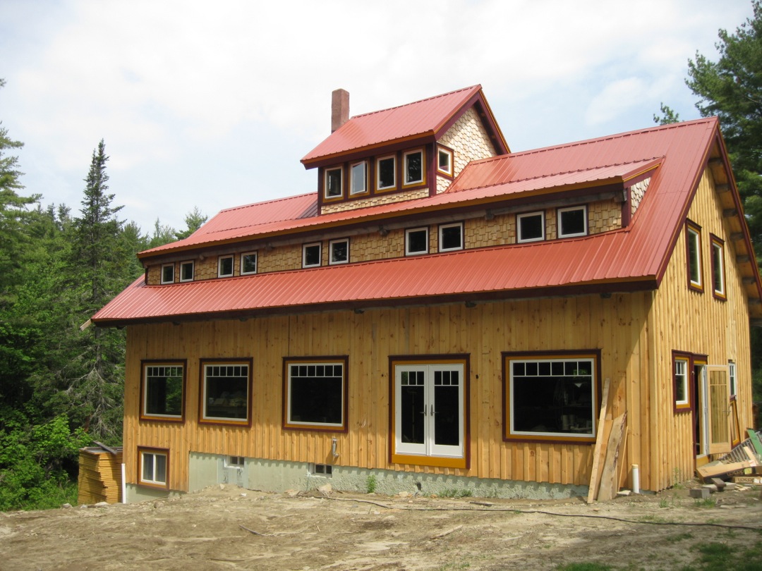

If I were to build a house like your neighbors(and I probably wouldn't) , I would do it under a 3ft overhang on a one story house. Overhang is a key ingredient to protecting the boards and I strongly recommend as much overhang as you can handle for any construction. Your siding and paint will last much longer. Traditionally, overhang was avoided in cold climes do to ice damning but with modern insulation and cold roofs this is much less of an issue . But I digress, if I was your neighbor I would also bevel the top of the horizontal batten so that it would shed any water that hit it(I do do this on horizontal window and door trim). If I was your neighbor I probably would have just installed the boards like clapboards if I was that broke, but I would have put some let in braces up before I put the siding on
If I was building an entire structure from green lumber, I would frame conventionally, but run the sheathing boards at a 45 degree angle to keep the structure from racking. If this sheathing splits later on it isn't of much consequence as the fibers of the wood are still intact. I would then wrap this in tyvec and side with whatever. vertical furring strips under raw wood under an overhang is an excellent decision as the clapboards stay dry andany moisture that does find it's way in there can easily evaporate
If money was real tight, I would let in brace my frame as mentioned above, and then install nailers avery 3 ft horizontal to the ground and either B&B or cut 1/2 boards (used to be very common for barns in these parts) and install board and board.

If you have decent overhang I would keep it raw wood. I am sticking with raw wood on my house. LOts of old barns in my area, over 100 years old still have their original pine siding that has never seen a drop of paint. I'm not saying the siding looks brand new, but in 100 years I doubt you will care much what your ATV shed looks like. Pine will chocolate brown over time. IF you don't have overhang, put a gutter on it and drain to a rain barrel.
