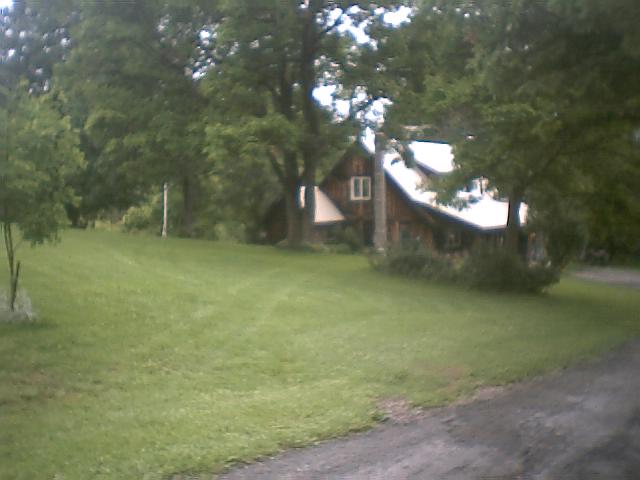

I agree with shinnliger for the most part except when we built my house 35 yrs ago, we nailed both sides of the boards, angling toward the center, but nailed only one side of the battens, then went back the following year and nailed the other side. Most of the lumber came right off the mill that was set up about 100 ft away. We used blowdown pine trees they gave us from the waterworks next door, but we had to skid with a horse. The greenest one we used was the 32 ft main carrier that wasn't quite a blowdown yet. You know it takes quite a while to quietly fell and limb a 50 -60 ft tree with a bowsaw, after dark. The horse couldn't quite handle that one, but 400 ft of cable and a tractor did. It was peeled and in set in place within 1/2 hour after it hit the ground.
We also used a lot of our own poplar for framing, barn siding and even built a stockade style log cabin with it. It's great wood as long as water can't stand on it or it will rot quickly. An old time builder neighbor said it was the prefered wood for dance hall floor joists, as it is very springy when dry.
Not a great photo but no problems after 35 yrs.
