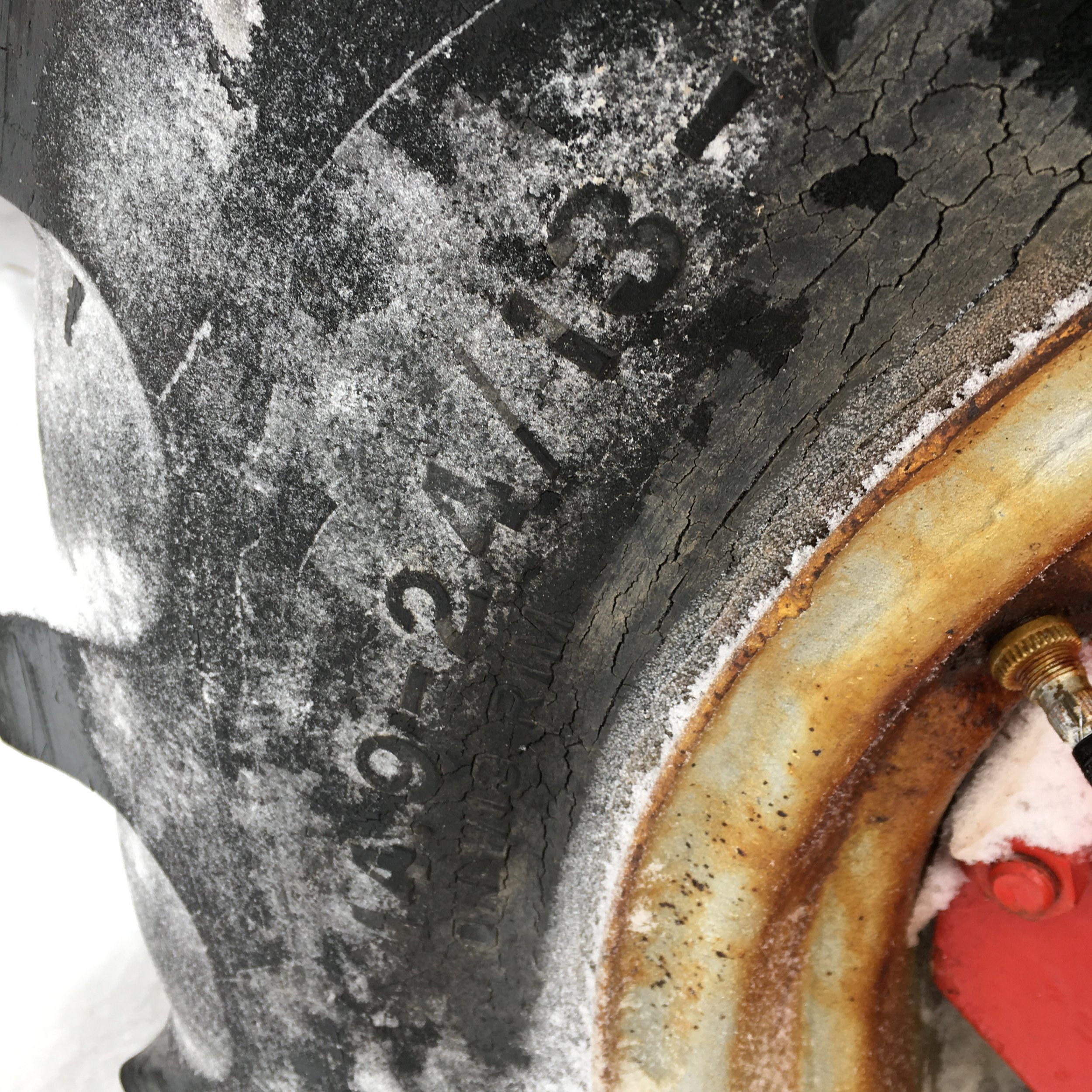

Did you find your rims? I am looking for 13” x 24” rims as well. My tires are 14.9 x 24 and like yours said on 13” rim. Been looking at US made Carlisle tires which also call for 13” rims. All I see are 10”-12” wide rims.
   / Rotten rims, two sizes on tires #14

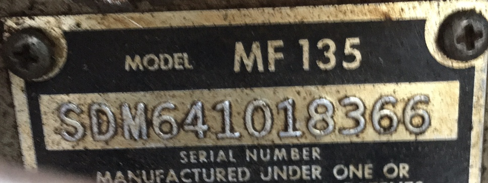

What year and model is your 135?
   / Rotten rims, two sizes on tires #15
1966 model MF135, at least I think so…

Different ways of measuring tires, there have been several over the years.
This article explains it quite well,
a link to the article; Tractor Tire Size: Find the Right Tire for Your Antique Tractor
Tractor Tire Size: Find the Right Tire for Your Antique Tractor​

After rubber tires on tractors became more accepted, it was discovered that wider rims contributed to better tire performance. The wider rims actually made the tire wider because the beads were no longer pulling the tire together. Tires labeled “11.25” were 13 inches across at the shoulders. The tread was allowed to flatten out some and the tires became more efficient.
As recommended rim width increased, tire numbers followed – but tires remained the same​
The industry resized tire numbers to reflect the new recommended rim width. As an example, let’s use the 11.25-24 tire, as used on the early WCs with 8-inch-wide wheels. This became the 13-24 when used on a 12-inch-wide rim.
It seems to be the same exact tire from basically the same mold as the old 11.25-24, only renumbered to reflect the recommended use on the wider rim and the corresponding increase in effective tread width gained by the wider rim.
Tires renumbered once again to reflect overall carcass width​
Later on, in the late ’50s or early ’60s, the tire manufacturers again renumbered their tires. These new numbers referred to overall carcass width when mounted on the recommended rim width. With this change, our 13-24 grew to a 14.9-24. Keep in mind this is still the same size tire, physically, from basically the same mold. It’s just labeled according to the new numbering system.
The tires on each line were the same size and formed in basically the same molds but they were numbered differently to reflect: first, the increase in recommended rim widths; and second, to reflect over all carcass width rather than shoulder-to-shoulder width across the tread.
If you will notice, some really old tires are labeled with both sizes. I have a pair of Goodrich that shows 13-24, replaces 11.25-24.
