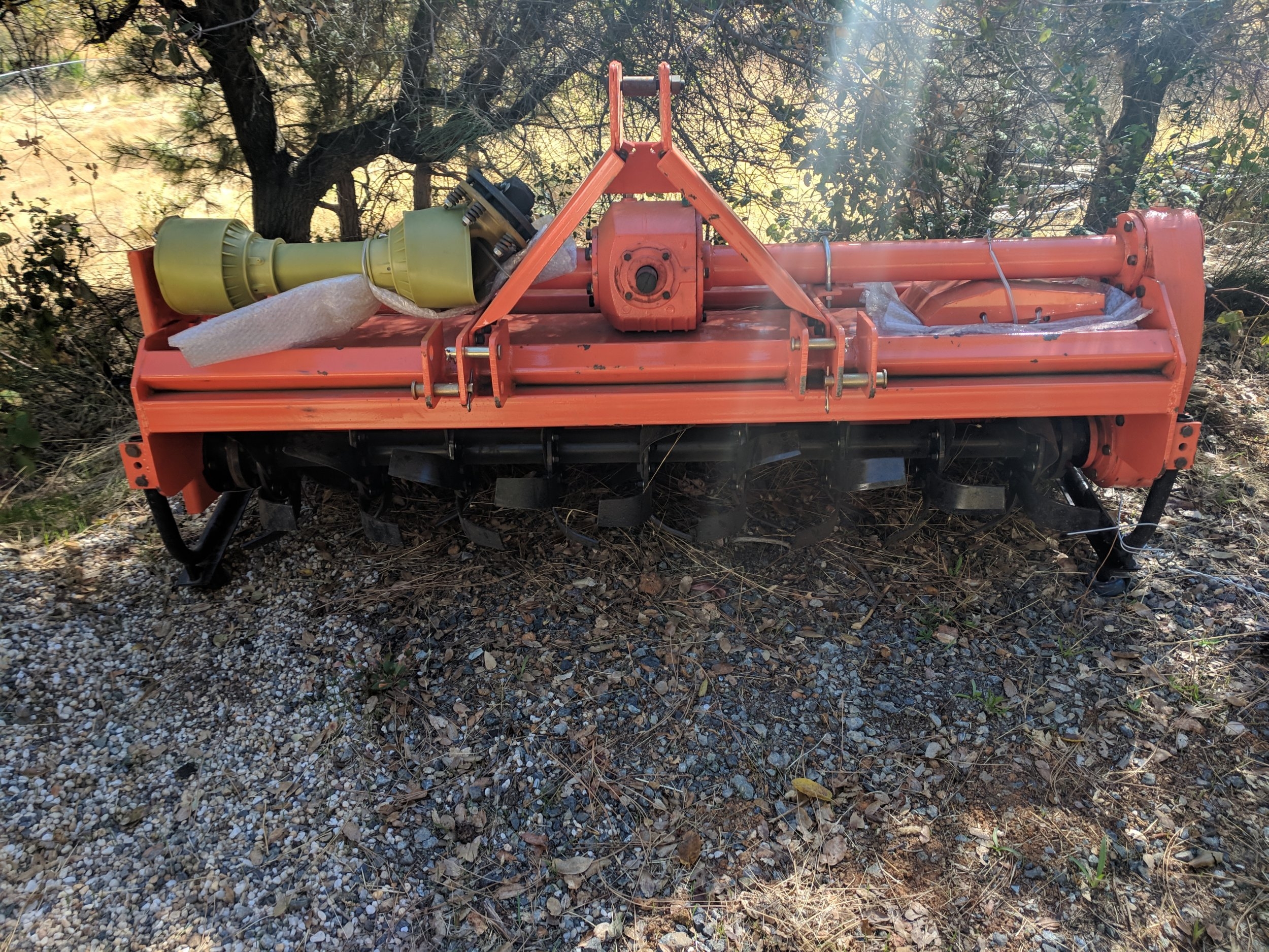

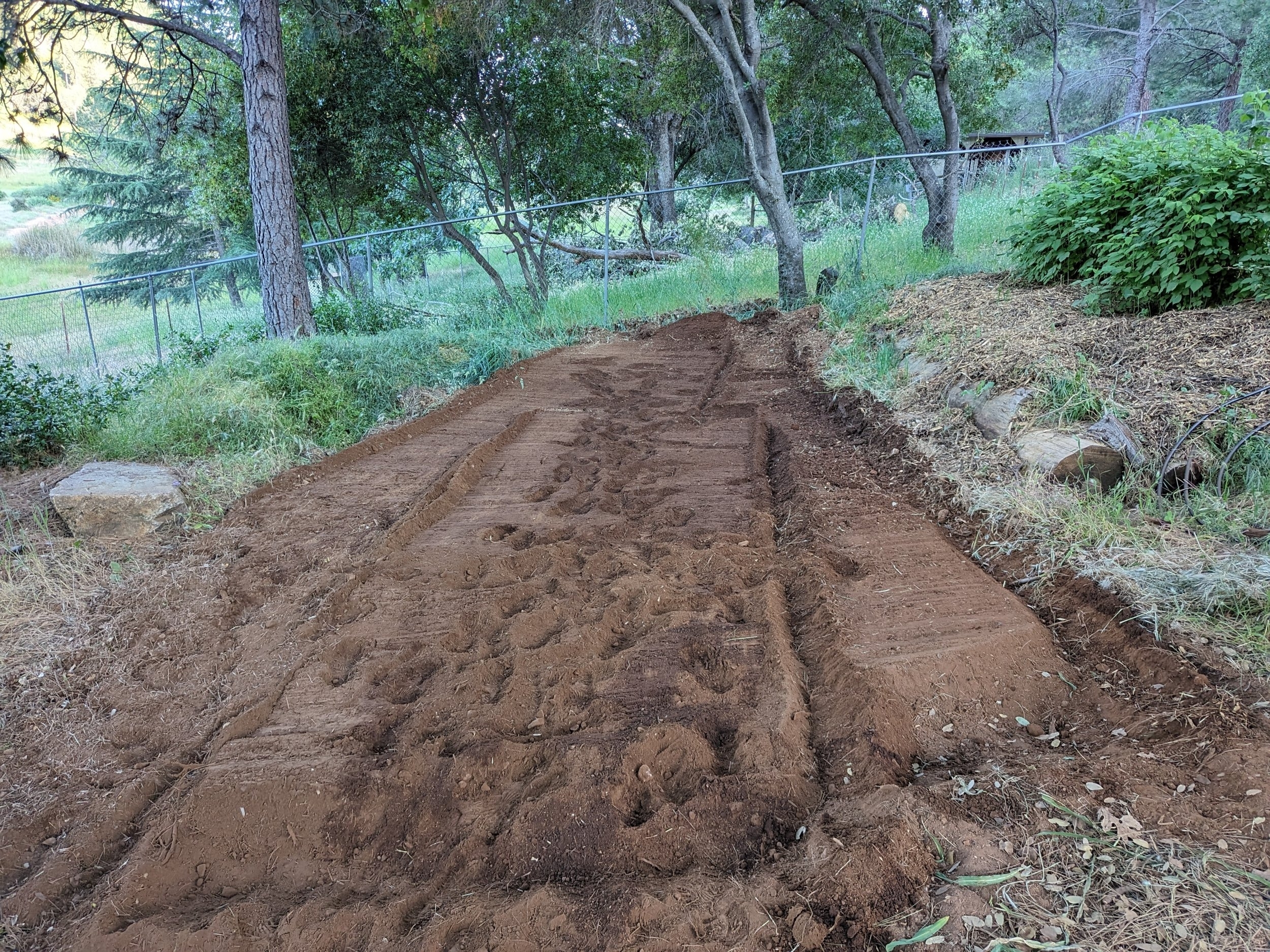

If you're patient, you can use a pretty good-sized tiller.
My tractor has ~30 pto HP, and while I definitely make good use of the hydrostatic in low gear, I can chop up hard clay with this monster (first pic from before I used it). Slow going on the first pass but very effective anyways.
There are a number of very similar threads on this site, a quick read of them may suit you well.
FWIW, check local auctions. This one set me back $1000 including auction fees.
