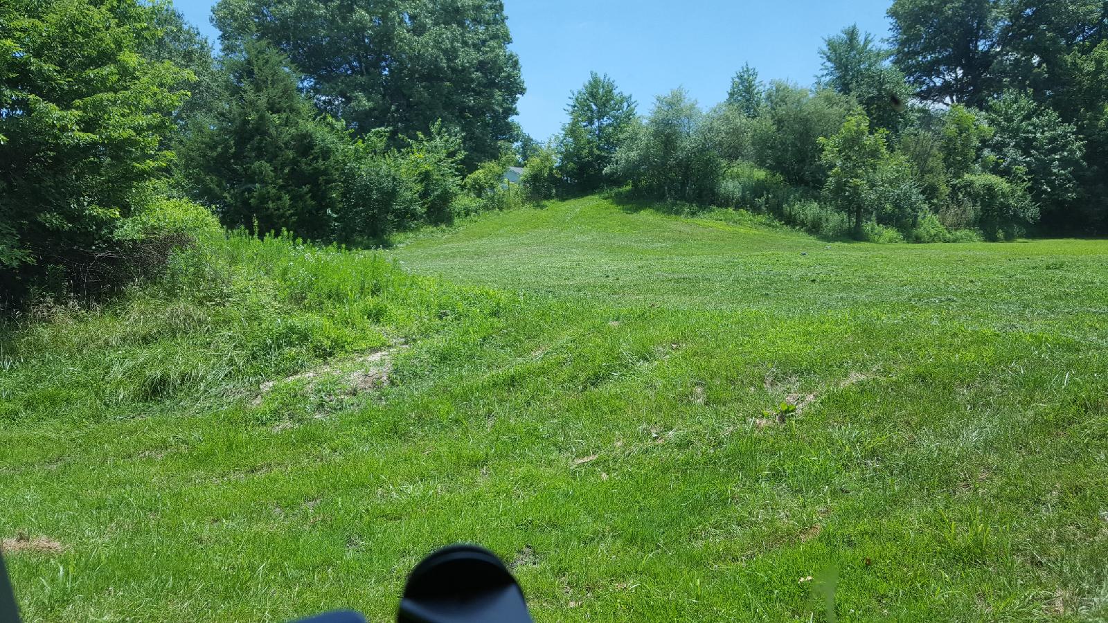

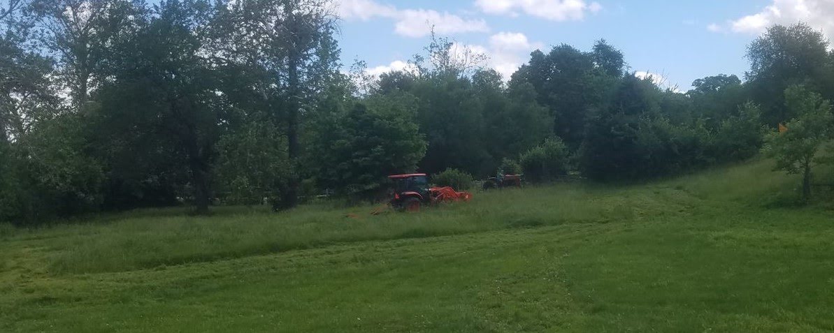

On coarse weeds that your picture shows I wouldn't be overly concerned about blades being sharp even rounded over they will cut good.
Also chopping that heavy course stuff in one pass I'd give the deck more slope getting the rear of the deck 4-6 inches higher then the front.
Also I am guessing that you have a floating hitch for the top link attachment point that will allow the wheels to stay in contact with the ground while you are mowing
and you can adjust the height of cut with your lift arms. Quite often you don't need the full 540 rpm on the pto to do a good job, that said the faster the pto is turning the faster you can mow. Running through those tall weeds keep a good eye on the radiator condition and engine temp the chaff and dander will plug up a radiator quickly some days.
Thanks for all that. Yes, I can adjust the cutter height with the PTO adjust from the driver's seat. I'd agree that more angle might help with cuttings ejection and that would likely lead to a better cut, although like you said...in stuff this high and tangley there isn't much you can do.
I did keep an eye on the temp gauge (never moved once warmed up), but had a front grille covered in grass seed when I was done! I took my big backpack blower and cleared it all away.
