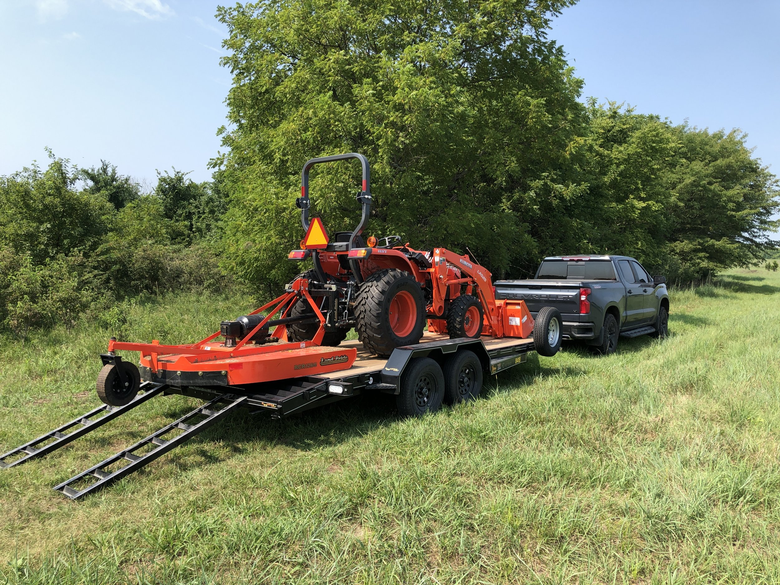

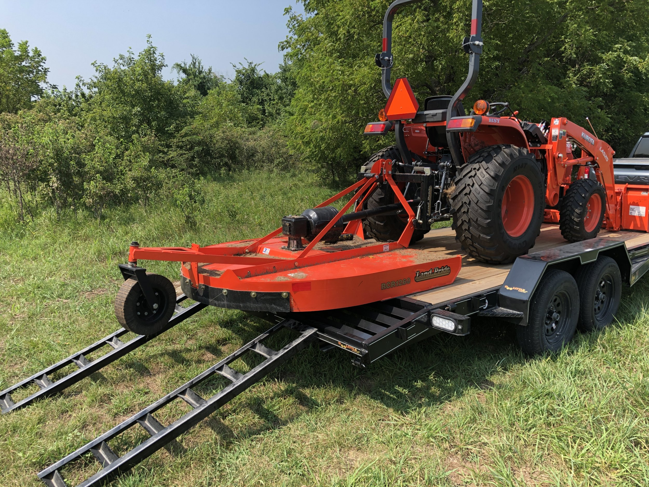

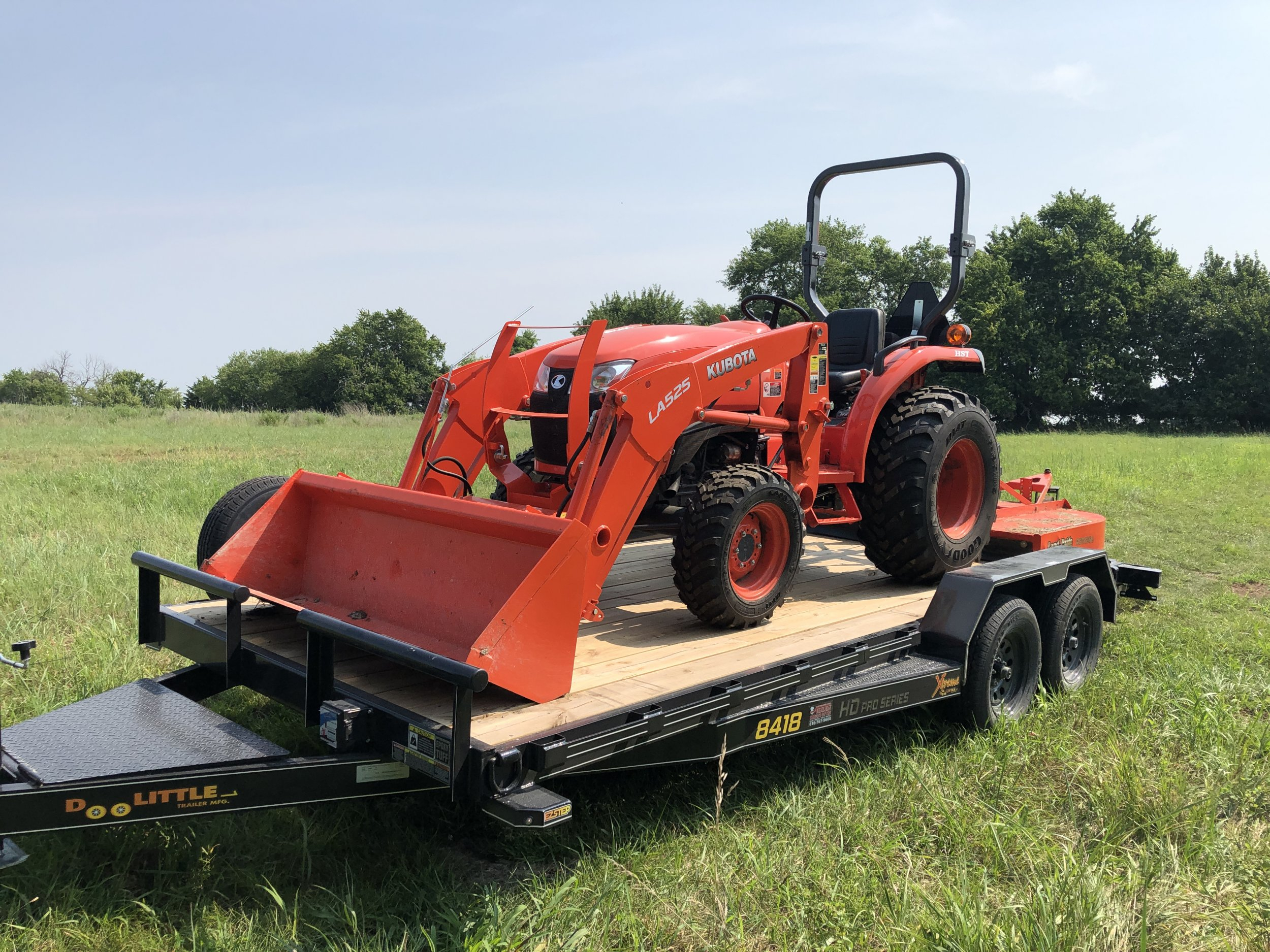

Recently bought a Doolittle 18’ (16’ + 2’ dovetail) equipment trailer. I figured that my rotary cutter would stick out past the trailer some, but should I be concerned? My tie down plan is 4 points on the tractor with 5/16” grade 70 and ratcheting binders with a 2” strap over the bucket and 2” strap over the rotary cutter. I have corner protectors for the strap. I will also be attaching a red flag to the rotary cutter wheel. I think I’m okay here, but looking for 2nd opinions by experienced tractor owners/haulers. BTW, the silver spare is getting swapped out for a matching black one by the dealer, they just didn’t have a black rim when I bought it. I had TPMS monitors installed in all four tires and the trailer pulls like a dream empty. I plan on using it to occasionally haul my tractor and I plan on building some side boards to haul mulch and topsoil and other odds-n-ends.

I wouldn't be concerned at all , you have a sound plan to bind down the tractor and you are planning on flagging the overhanging mower, you will be fine, one thing I am curious about I am always trying to figure a way around TPMS on vehicles due to failing batteries or sensors or the sensors themselves failing and now people are getting them installed on trailers, I guess being raised on a farm and coming up long before TPMS I got into the habit of doing a walk around and checking my tires, lights etc, and while I guess it's nice when it works, it's just been aggravating for me, wasn't trying to hi-jack your thread, just curious.

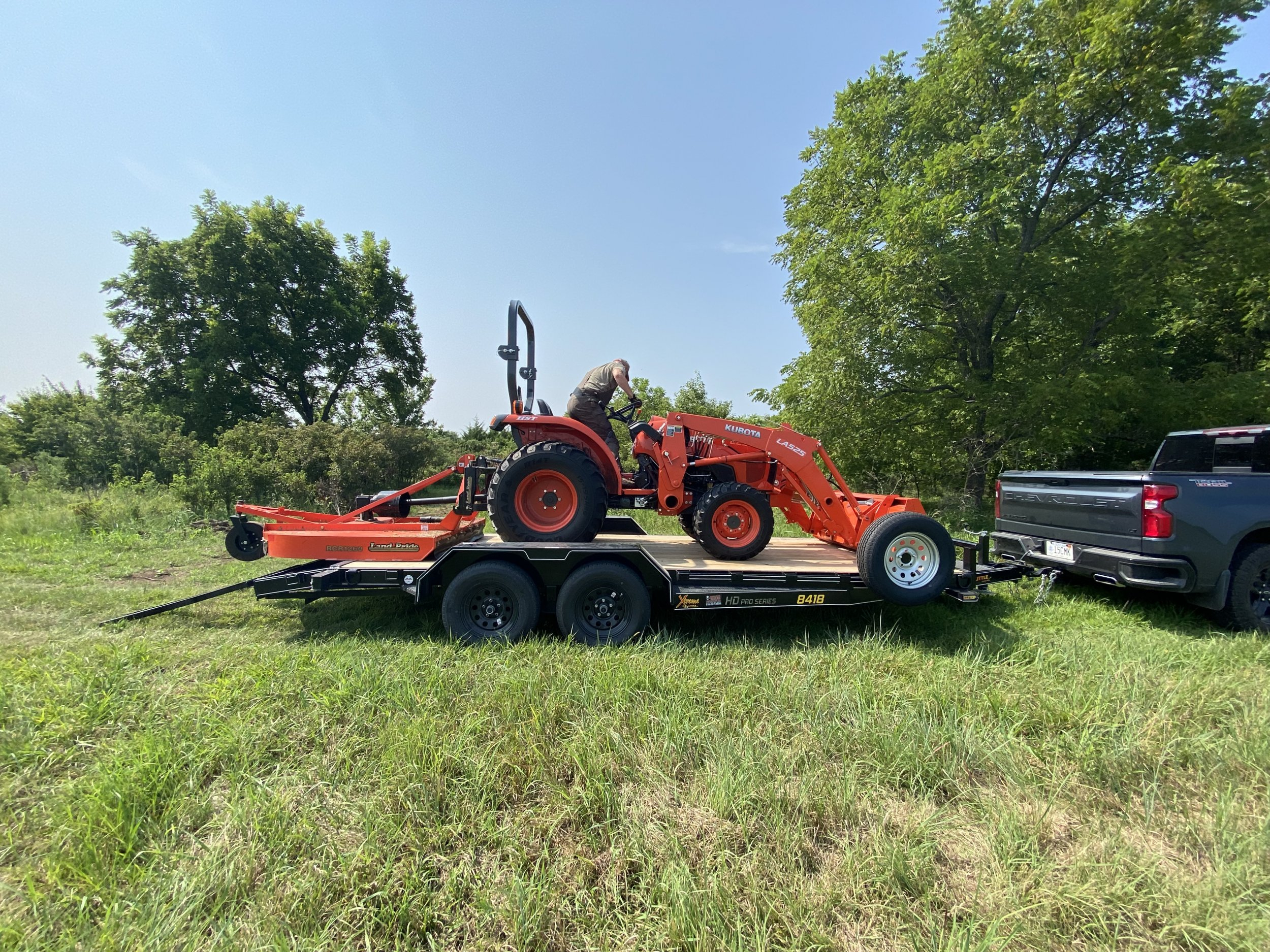

Niice trailer, but I'm think it's just the wrong trailer. IMHO, I think you bought a too-small of a trailer. A 16' is about 4' too short to allow positioning the tractor properly for correct weight distribution. The 16' you have appears to put too much weight on the tongue.
Just so you don't feel so badly, I made the same mistake when I bought my Kubota L3400. Ended up selling the 16'-er trailer and going to a 20'-er. Sold my diesel C2500 Chevy and left with only a C1500 half-ton - which is greatly undersized to haul my tractor. One of these days I'll get it all just right.

You should be fine. I do pretty much the same thing on my 18' trailer. I don't bother with a strap across the bucket or mower though. They are both attached to the tractor, and it's chained down on 4 corners with separate chains and binders. As long as you put a flag on the back of the mower (which you are doing) no one will give it a second look (other than to check out your cool tractor).
My next trailer is going to be a 30' gooseneck, so I can carry additional attachments with me to off property work sites.

I think with the weight of the bush hog hanging out the back, that your tongue weight is probably OK, but it sure wouldn't hurt to check it.
I'd also run a strap from the shaft (that accepts the bush hog wheel axle) to some immobile point on the tractor.

Mine hangs over 3’ on my 18’. I know ( or think I know) that 4’ is max in Texas and I’ve heard the same for others. Be sure you are legal - I KNOW Texas state troopers target private trailers for enforcement.
Otherwise check tongue weight and go.

Legality-wise check ur state laws. For instance, in my state, the maximum overhang allowed is four feet past the trailer end.
You may also want to measure the tongue weight just to be sure u have enough with that particular placement.

Thanks! My state is 4' as well. The times I will need to haul the tractor, FEL, and brush hog will be rare. This is the only property that I maintain. I primarily bought the trailer for other tasks, but wanted to be sure IF I needed to haul it I could safely and legally. I've still got some room at the front to play with. I was trying to be generous with how much room the bucket will need as I've ordered the Piranha toothbar.

To me it looks ok. But i might tilt bucket down to see if resting on cutting edge gave me any more forward position. Or I might try pvc (slotted) over the front guards and rest bucket on it. Just some things i might try....

Tongue weight is my only concern, probably depends on how much is there with the trailer empty. Other than that flagging your over hanging load and you should be okay. Not ideal if but okay.

You might try something I have seen several times, try backing it on with the tail wheel hanging over the tongue, might not give you enough tongue weight or make the trailer tail heavy but you don't know till you try.
As for how it looks now, I would not give it a second thought.
