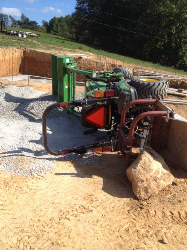

The Boulder in scoop didn't shift, but the whole 3pt was a little wobbly. Turn buckles needed tightened. A small stabilizer bar would be nice too.
I turned it back over with a chain and ford 841. I didn't let it sit long enough before trying to start. The starter would only start to turn over then stop. Waited about 30 min and it started and burnt off the oil. Finished spreading gravel next day without incident.
Phew, yeah, you have to be careful -- you can bend a rod trying to start an engine after it has been tipped over. Maybe you got lucky the starter didn't have enough guts to do that. Normally you can remove the glow plugs or injectors (whatever's easier) and turn it over to expel the oil. Then button back up, check fluid levels, and start.

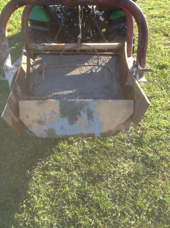

Trying a new ballast set up. It will still utilize the dirt scoop, but using concrete. I oiled everything up real good to keep from sticking to scoop. Also inserted som rebar to help secure and pulling out. If concrete is out, should be able to scoop it back up. Put a cpl pieces of wood form in to cover the two big bolts to keep from getting hung up. I'll find out after it dries image-1378012766.jpg

Trying a new ballast set up. It will still utilize the dirt scoop, but using concrete. I oiled everything up real good to keep from sticking to scoop. Also inserted som rebar to help secure and pulling out. If concrete is out, should be able to scoop it back up. Put a cpl pieces of wood form in to cover the two big bolts to keep from getting hung up. I'll find out after it dries <img src="http://www.tractorbynet.com/forums/files/safety/442900-rops-seatbelts-work-image-1378012766-jpg"/> <img src="http://www.tractorbynet.com/forums/files/safety/442905-rops-seatbelts-work-image-1993827629-jpg"/>
I found out today it's Not coming out? Removed the forms , did a little chiseling, and taping bucket with 3 lb sledge. I hooked a chain to rebar and trailer hitch of my truck to try and pull out. All it did was drag the truck. It WILL come out at some point, just not sure best method. Any suggestions??
Meanwhile I have around 5-600 lbs ballast.

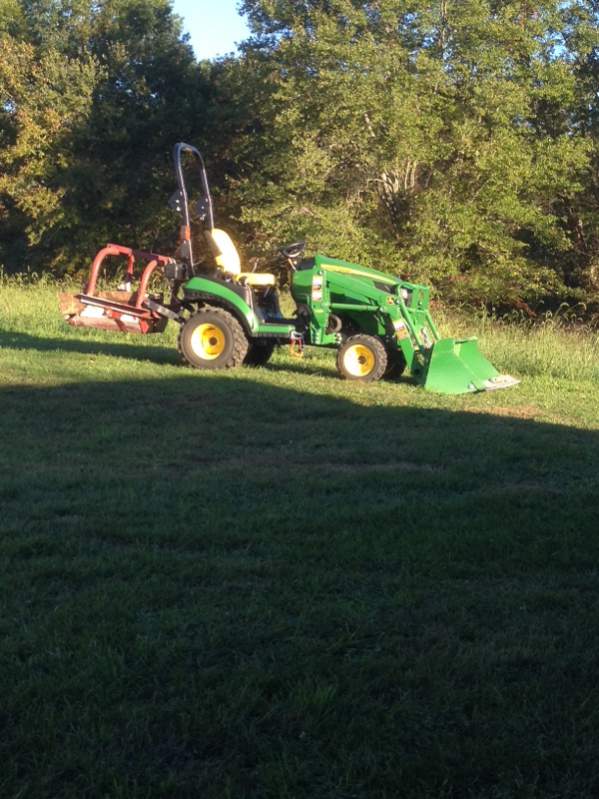

I don't think I had quite enough ballast either. It had been fine up till then though. Also a good point about a rollover on "flat" ground. You never know when you might hit s soft spot, rut, rock, groundhog hole etc. I handy been using ROPS & belt when mowing but may start. As to relying on a park brake I had set it last week and was in front of, behind another tractor when it popped & released. It's nose was sloped down into the barn and had been set about 5 min when it released. More ballast is on my next agenda. View attachment 441580
Also as I look at the pic, my bucket wasn't low enough either. Crap!
Well, just be thankful that you had your seat belt on, a good ROPS and everything worked as intended and you are just fine now and no one else got hurt either. Live and learn. :)

1) are you able to flip the scoop upside down so it stays upside down? If so , then hold the frame with the bucket so it doesn't roll on you and sledge hammer the underside (steel) as this is the easiest way to loosen concrete. I used to relief drive a concrete truck and used the technique to remove lumps of concrete when I got issued a dirty truck.
