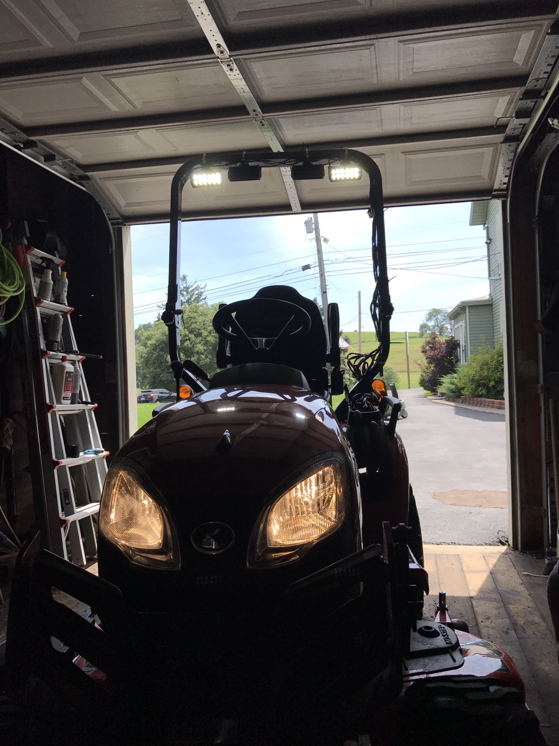

New 2017 BX23S installed four led lights now trying to figure what to do with excess wires and were to install switch IMG_0620.JPG
/ Rops lights #2
well I will say I don't think you will have and issue with overloading the wiring. on all of the LEDs I have installed on my tractors I have always tied into existing light switch with LED draw being so much less than Conventional lights I have never had an Issue with it.

G'day Mate and welcome to TBN from Downunder.
You may be able to simply access a pre-existing wiring connection at the rear of your tractor. On my 4105, it's a 'folded back & capped' 2 line wire. It's there IOT hook up front/rear lights (a factory option) and is already wired to the four-position main light switch = Off/Hazard/Hazard&Headlight/Hazard&Headlight&Worklights.
Ask at your Dealership if a connection like this is already there or perhaps another Member knows of this and can chime in.

New 2017 BX23S installed four led lights now trying to figure what to do with excess wires and were to install switchView attachment 516604
In my case, I used zip ties attached to small flat magnets and ran the wire down the inward face of the ROPS. I left a small loop at the hinge to allow the ROPS to fold down. I used a magnet to attach the switch as well and hooked it up to the work light wiring circuit in the harness under the right fender. I also wired a disconnect plug so the lights and wiring can be easily removed when working in the woods.
/ Rops lights
Nice job. I did similar on wiring but cut off excess and made a switch box but definitely not removable as yours
