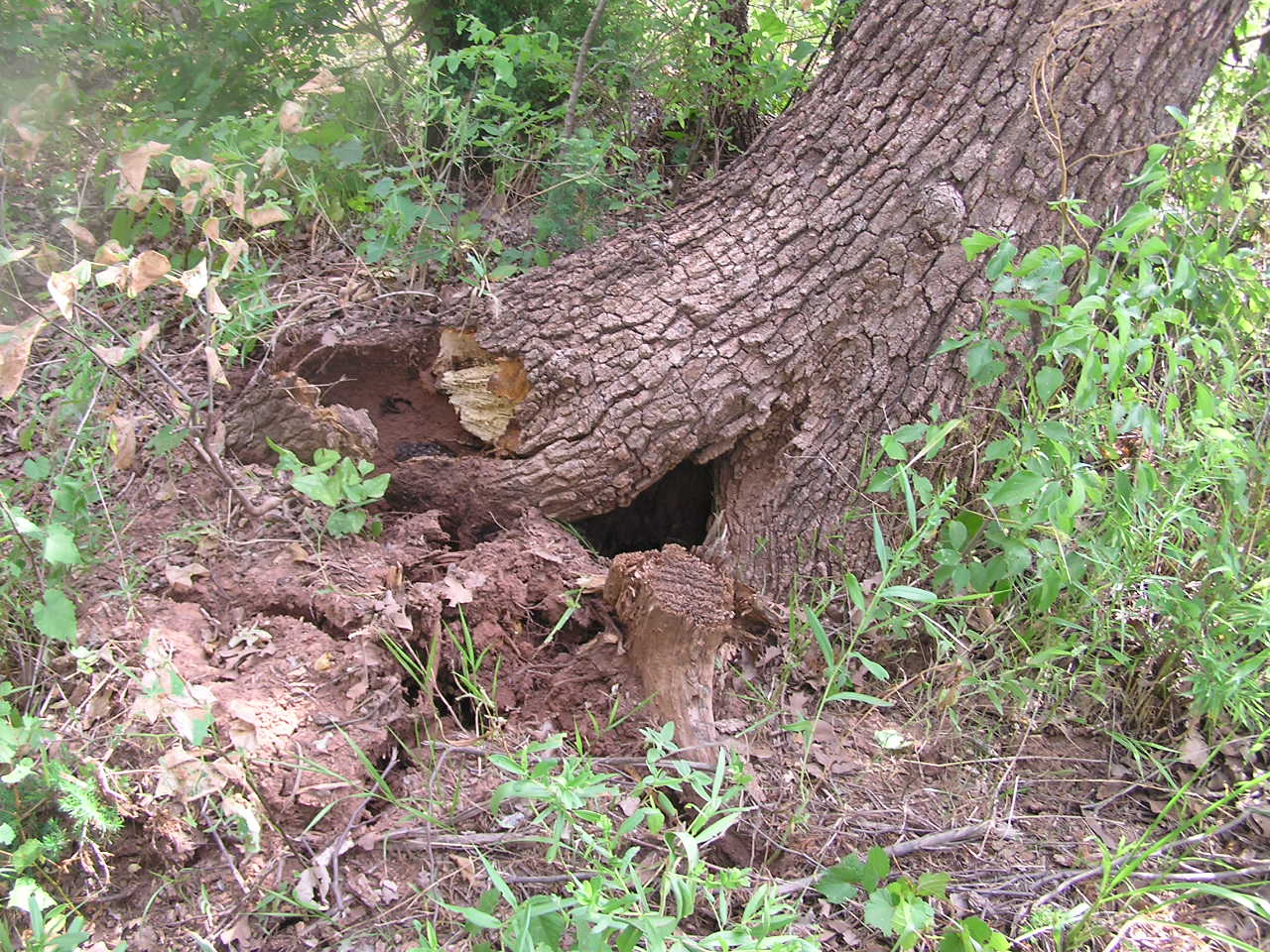

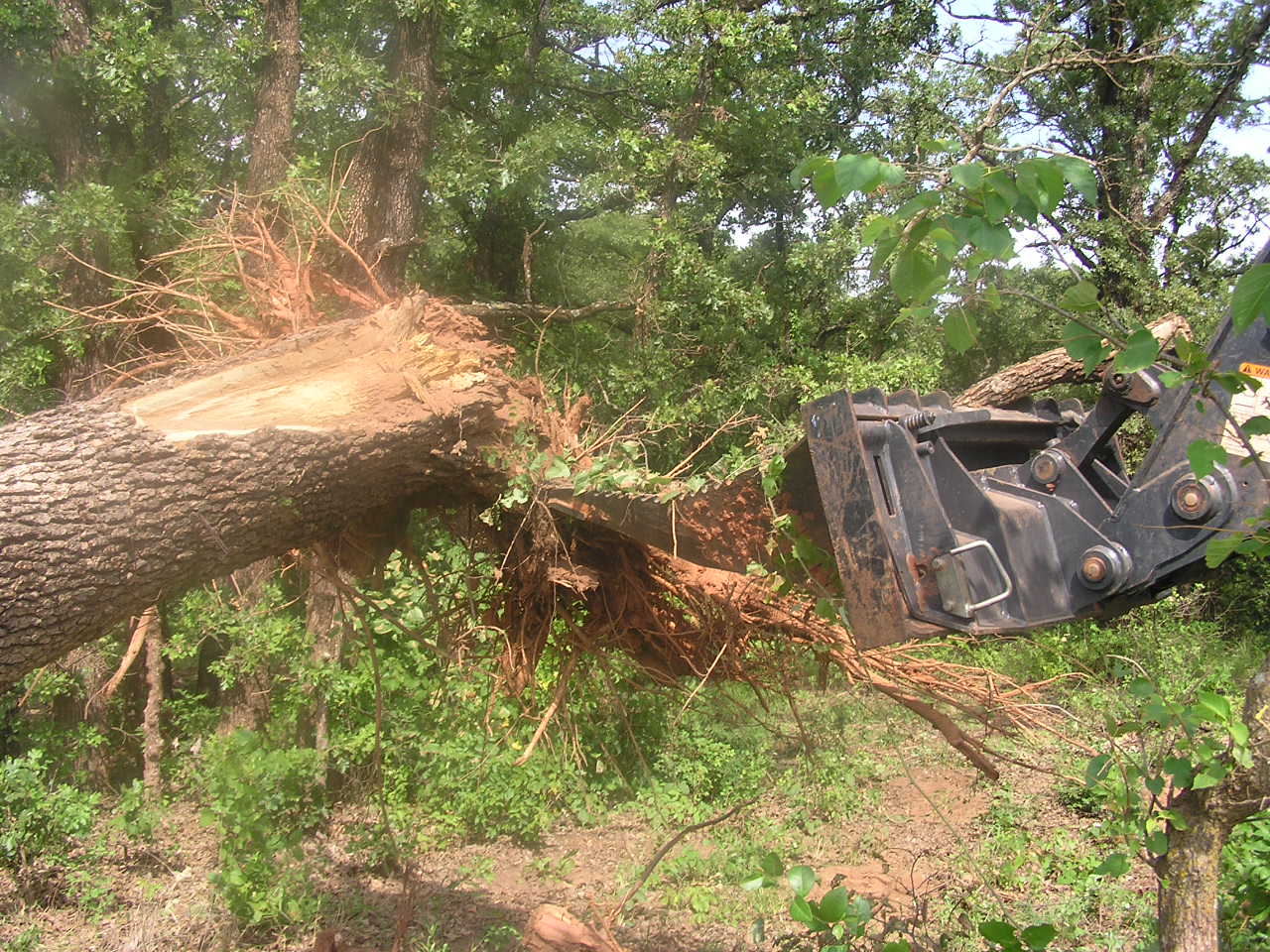

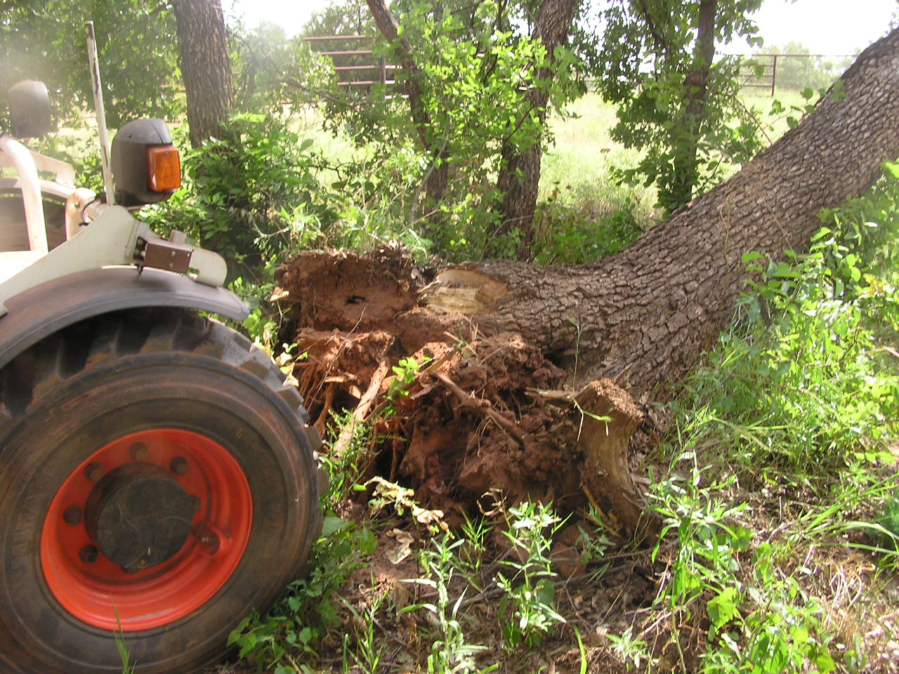

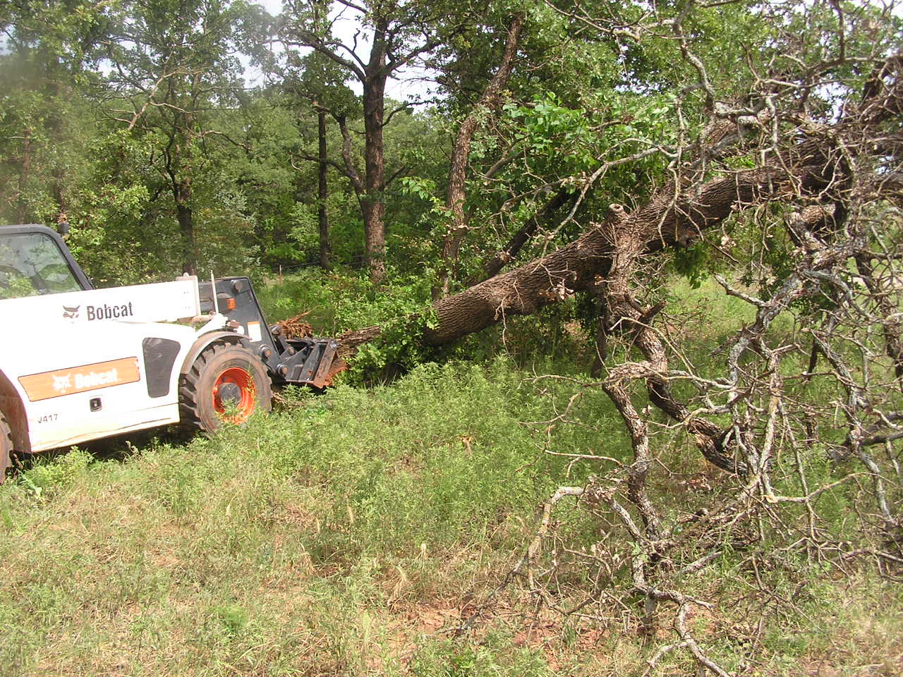

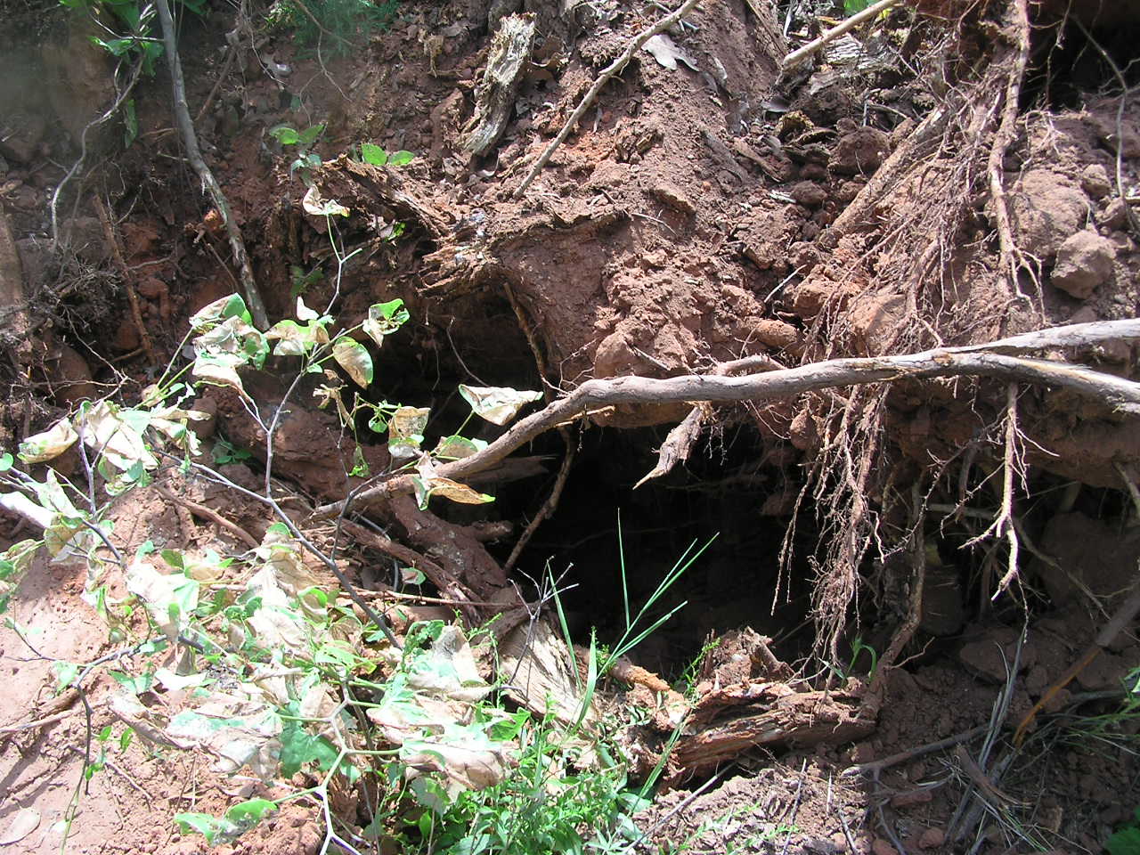

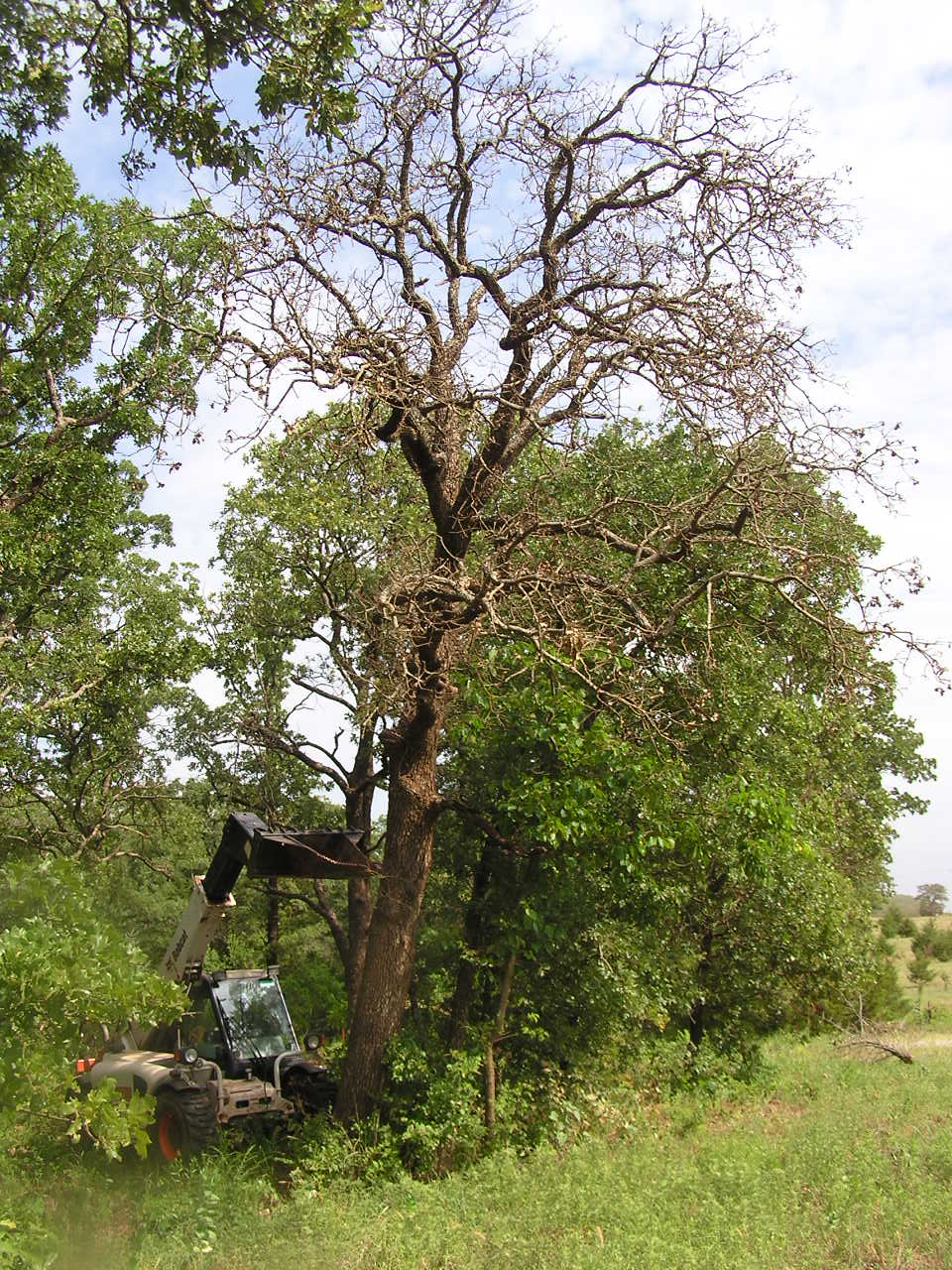

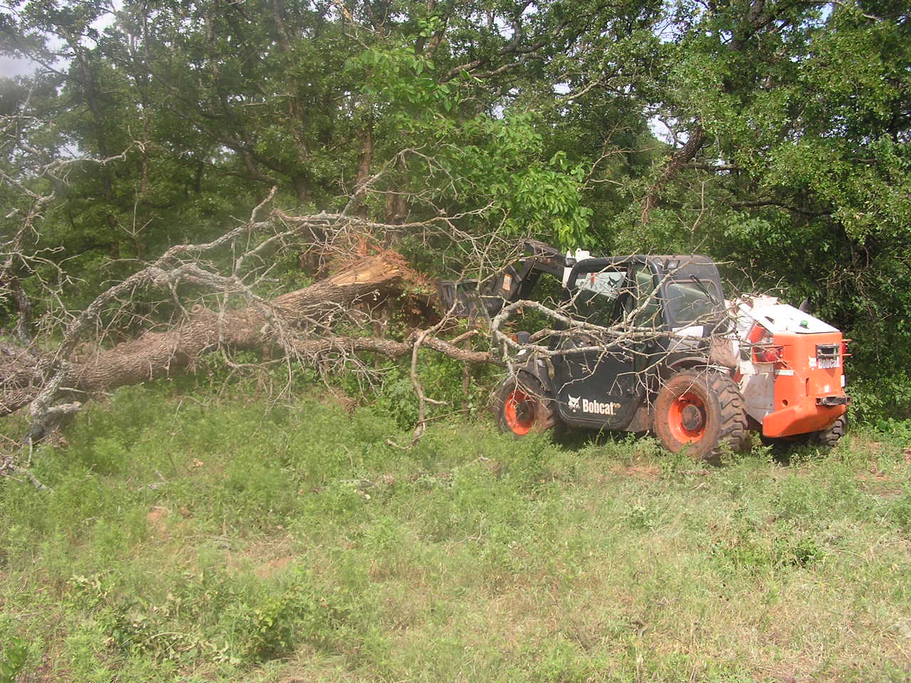

This one hadn't been dead very long. Had the fairy hole, but wasn't rotten or hollow yet.
View attachment 392907 View attachment 392908 View attachment 392909
There is one across the driveway that is hollow. all the big limbs have fallen off. But honey bees are using it, so I will let nature take care of it.

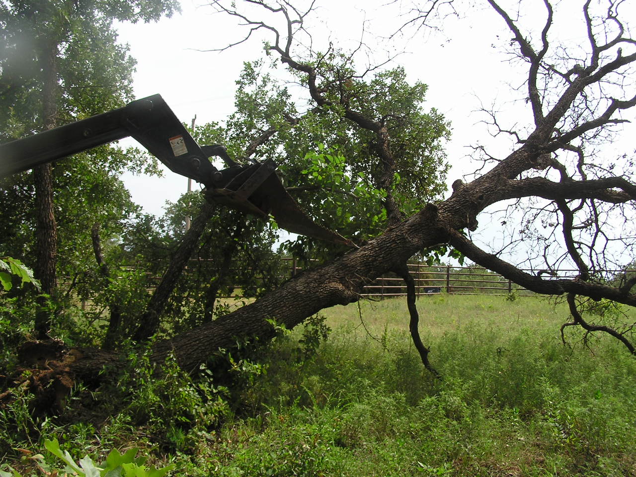

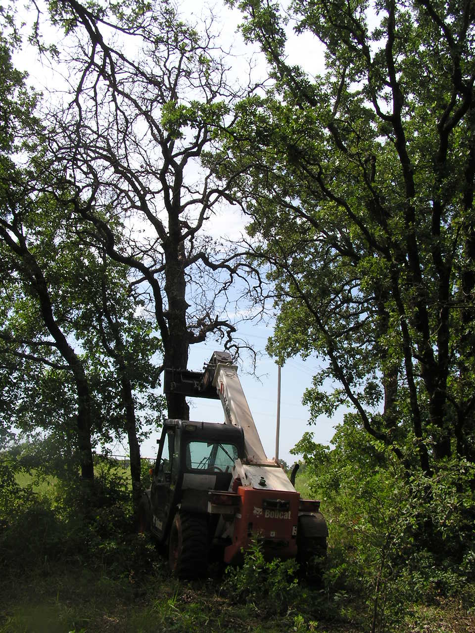

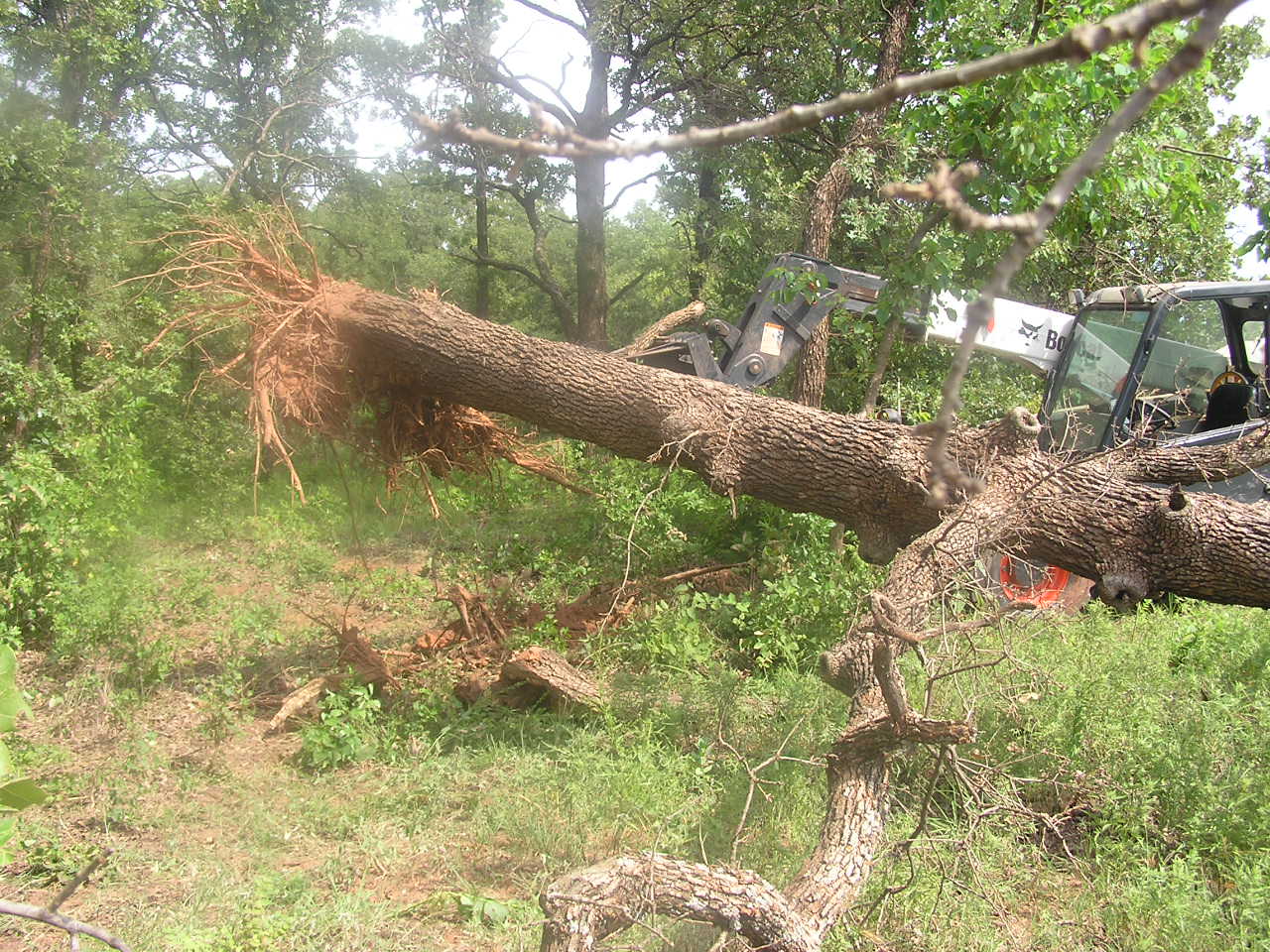

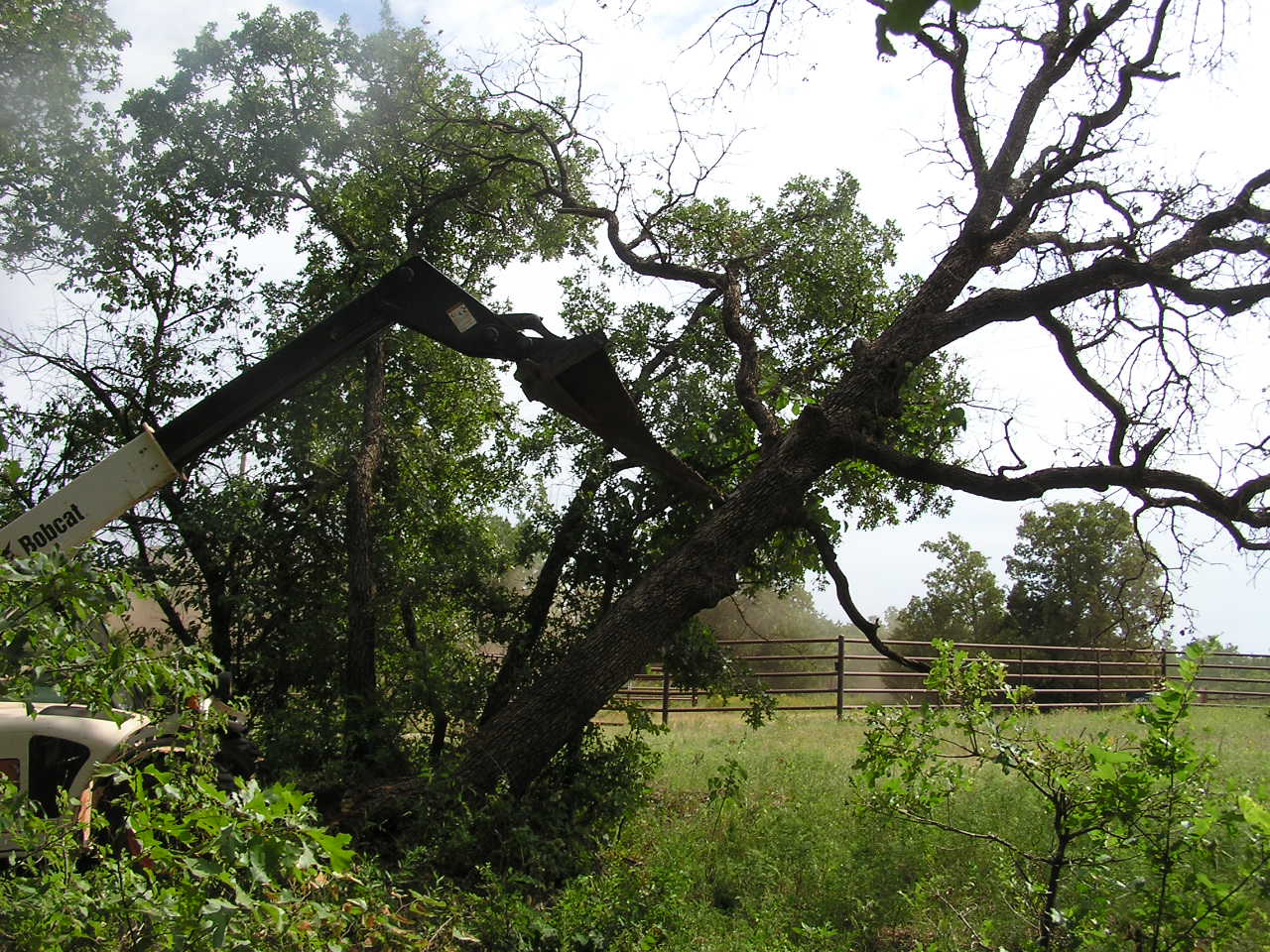

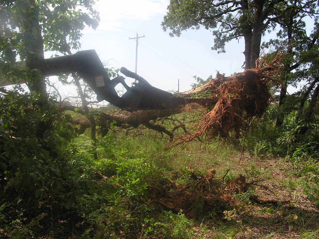

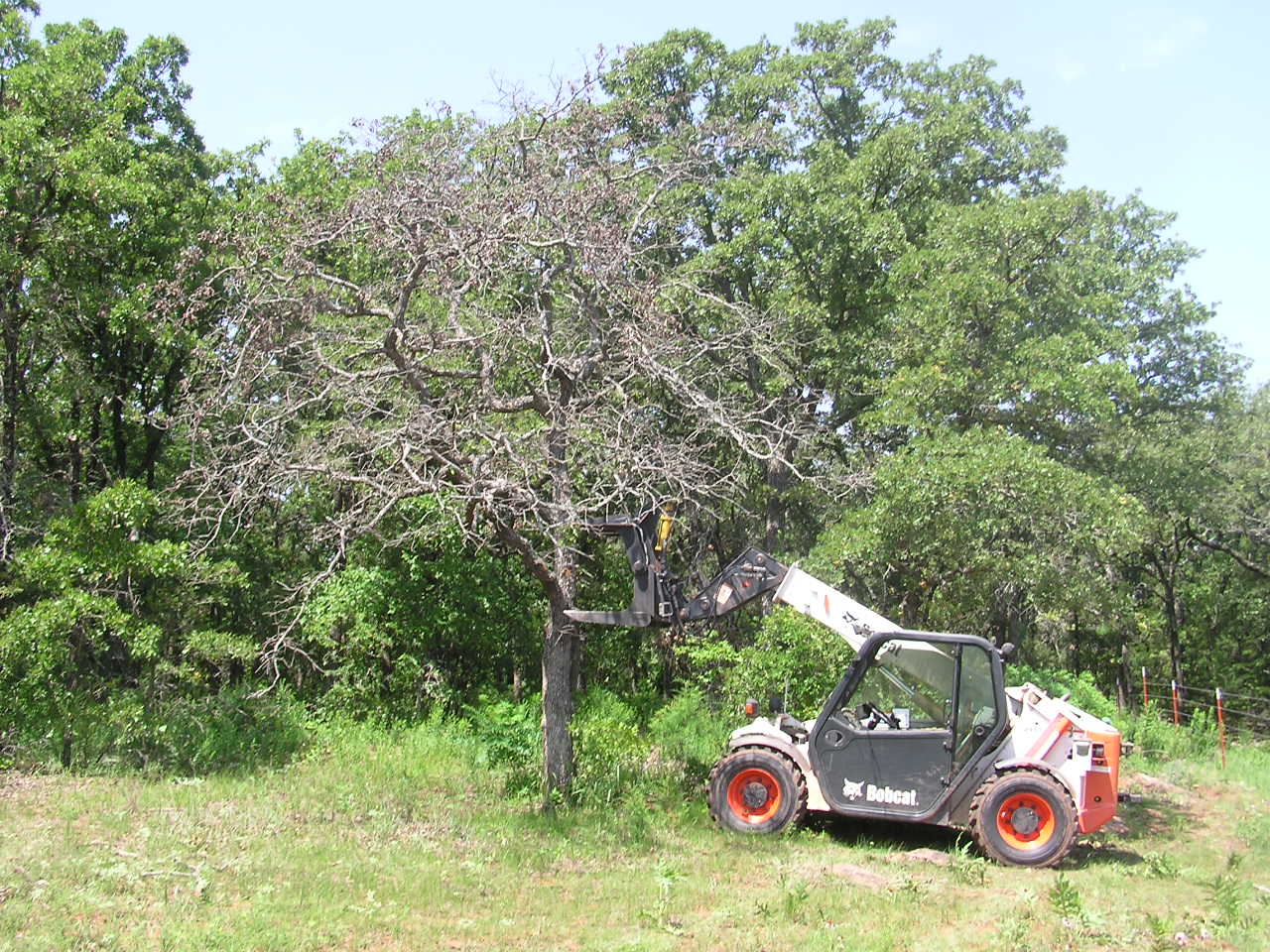

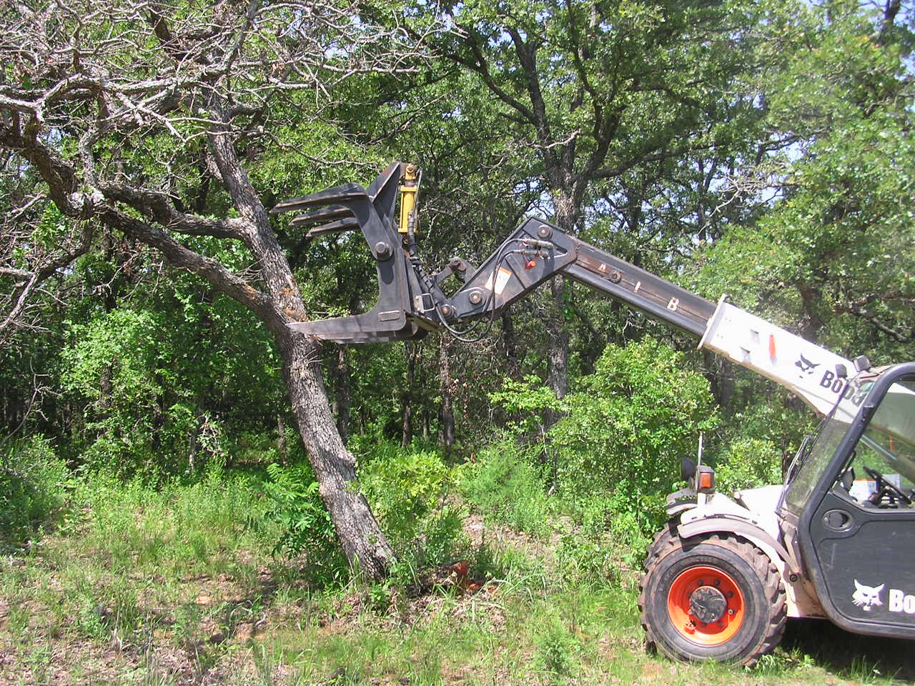

I always try pushing first. If the V417 slides back, then I break some roots.
You are right about the extra room at the front, I don't worry about the tree top breaking and falling on the cab or the root ball coming up, since the V417 does not move when pushing over a tree.
Here is a side view to show what I mean. I put the grapple against the tree, got out, took the picture, stood outside, reached in pushed the extend switch, took the next picture and repeat.
Then got in to pick it up.
View attachment 392926 View attachment 392927 View attachment 392932 View attachment 392928
View attachment 392929 View attachment 392930
Looks like you were having fun! That tree doesn't have much of a root ball. I appreciate the power of the V417 but I kinda doubt it would work well without a little root cutting on trees with more substantial root system. We have a tree we call "choke cherry" that is very easy to push over (same size roots as the one you show). However our oaks, maples, tulip trees and pines are much more difficult to "cow tip" over and at least for my 40hp CUT, require a bit of root cutting on at least one side first.

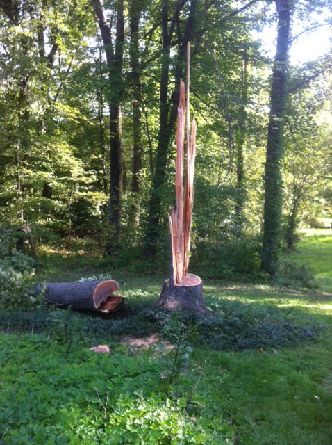

This was a tall (60-90ft) Tulip tree I had taken down by a local company. I had used this company before and was pleased with their work. The tree was about 15 feet from my house and several large branches hung over the roof. The plan was to use the bucket truck and a nylon rope, run thru a snatch block, to fell the tree in the desired location. After making his initial cuts, the guy on the saw signaled the guy in the truck to tension the rope. Well the truck stalled and the tree swayed precariously back and forth and I got a little concerned it would go the wrong way. The guy in the truck gets it started and is determined not to stall it again. This time he gives it more gas and snaps the rope. Once again the tree is swaying and I'm a nervous wreck. The guys fix the rope and make some more cuts in the tree and it finally falls in the proper direction. I didn't know it at the time, but the result is called a "barber chair" and could have seriously injured the saw operator. Thankfully no one was hurt and nothing was damaged. Be careful out there!
/ Rope suggestions and help #30
This thread is the first time I have heard the term "barber chair" or seen a photo like that. What exactly is a "barber chair" and why does it happen?

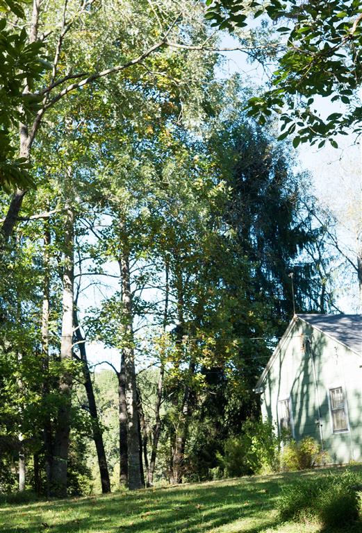

There's a poplar in the lower left hand corner with a green ribbon on it that has grown with two forks. There is another poplar with one trunk just to the right of it that needs to be cut as well. Maybe not the best picture, but try zooming in. I can make more photos.
