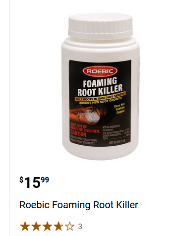

My friend had that happen at her cabin. First she had a capable septic tank pumping company do a thorough snaking of the drain line, followed by running a video camera through it to confirm all was clear. I recorded where the roots infiltrated the line (basically every cast iron joint). Then, twice a year, she runs a foaming root killer through the line. The brand below is pretty good, but your local septic pumping company probably has a more industrial version.
It is astonishing how well tree roots find the slightest bit of water.

I use to be able to buy Rootx and something called Angus...
I don't think either still available in California.
