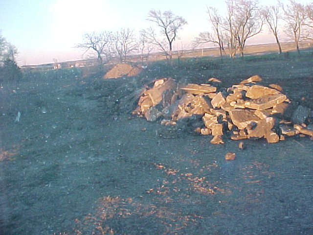

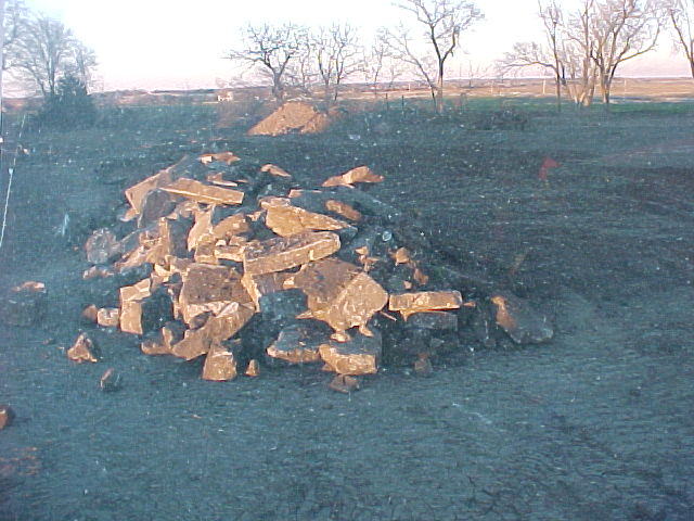

I used a Grizzley band saw for all the cutting, since I got it I have only used my cut off saw once when I ran out of blades. No sparks and a prefect cut.
The back to bottom angle was cut at 52 degress. This seem to match up to skid steer bucket angle.
I Have built a grapple for a skid steer bucket. If needed I can pull some pins and put it on the rock bucket. I hauled off all that concrete today, I had 7 -5 ton loads. I loaded it with the rock bucket, I really did not need the grapple. Since the bottom of the rock bucket is 3' deep I was able to scop up 4' chucks into it with no problem.
Here is a pic of my grapple bucket.
Jeager, You can use it But it might be a quick trip to Kansas. I used it hard today and no welds broke, still straight. It will even dig. Thanks for all the compliments.
