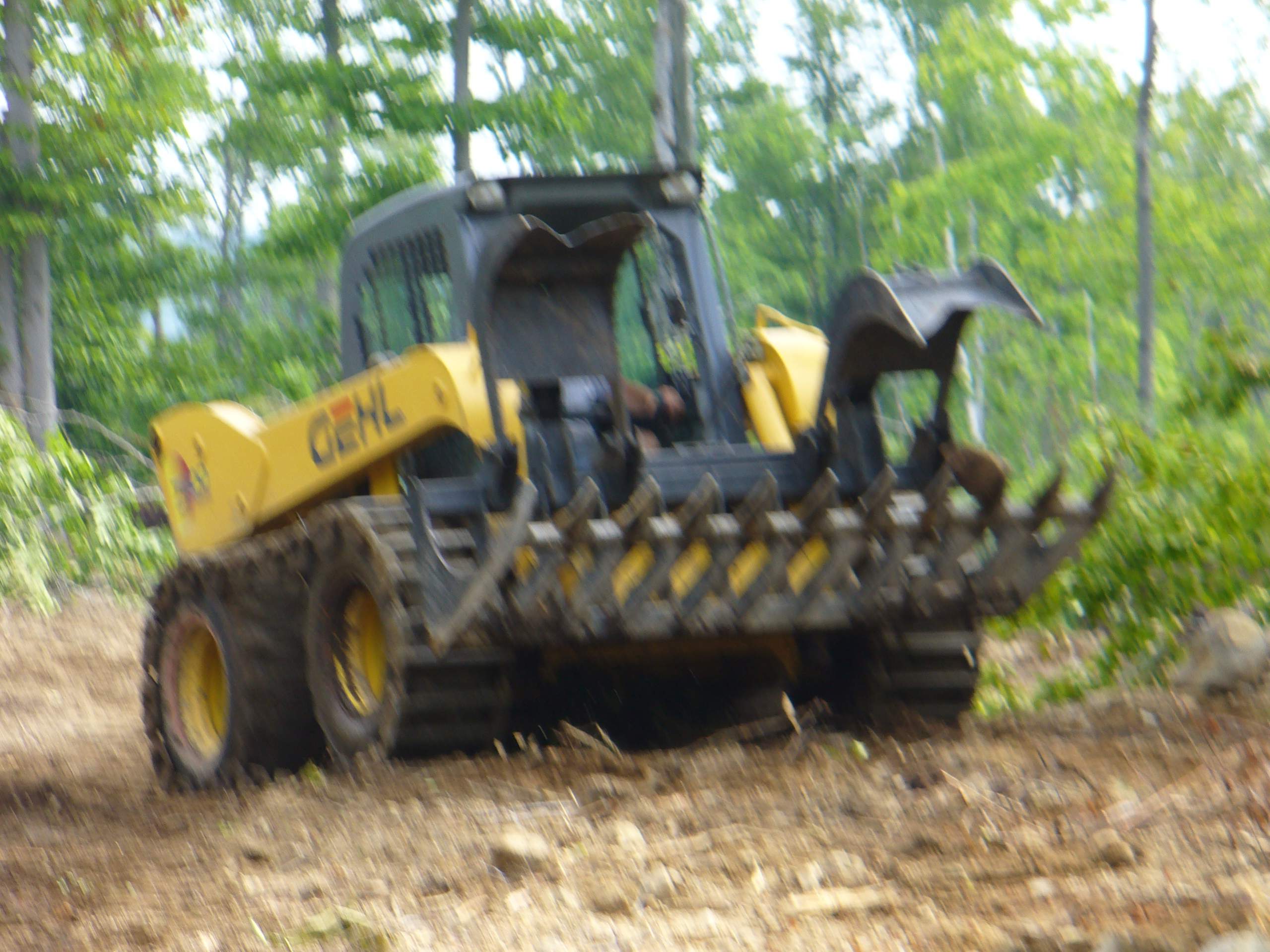

I have an 7' model from Loflin. Been working it pretty hard for at least 10 years now with most of it's "time" on a large skid steer. Loflin Fabrication I would recommend it.

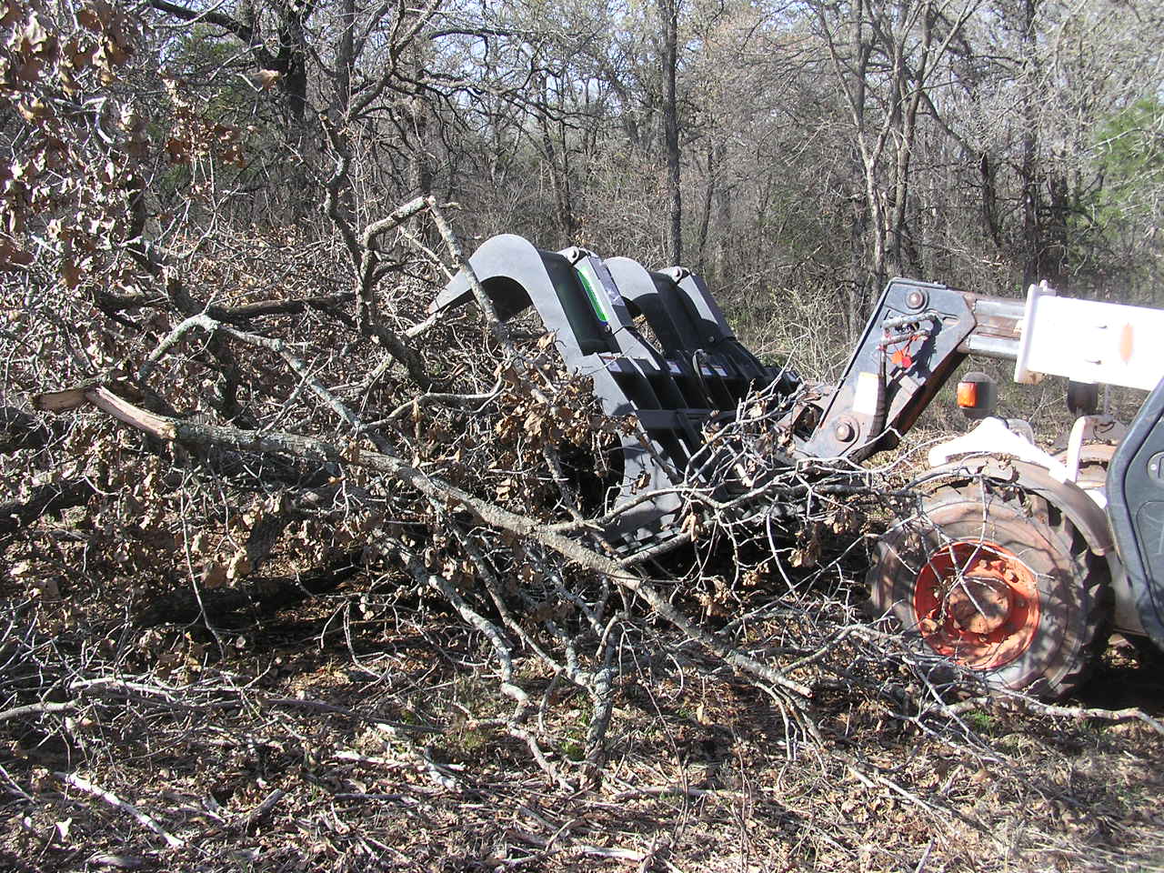

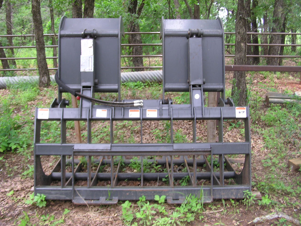

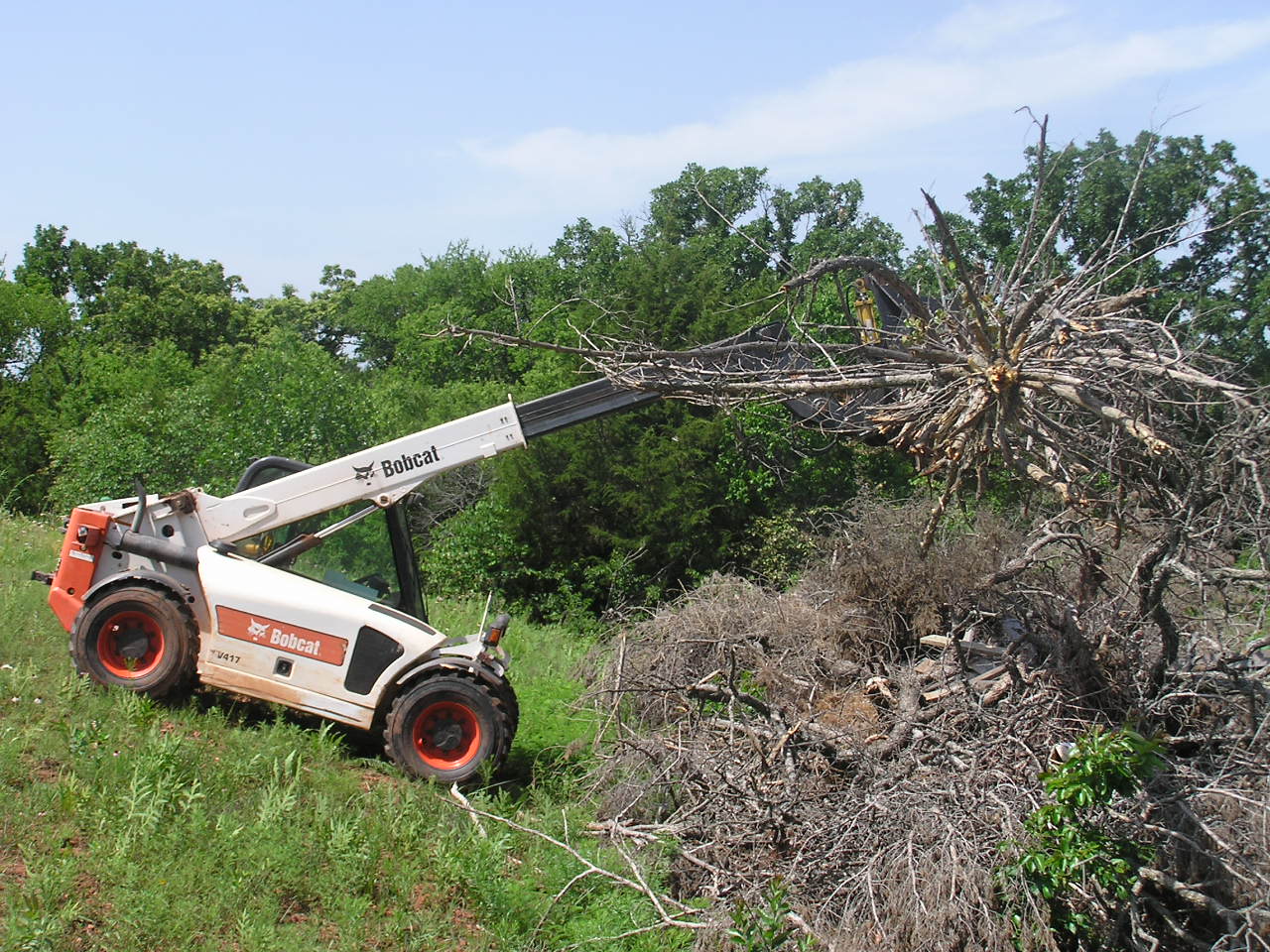

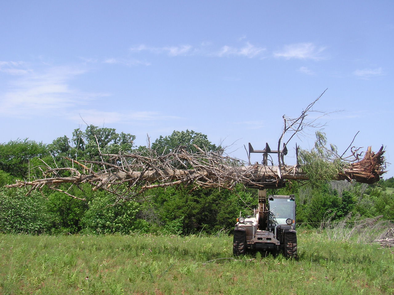

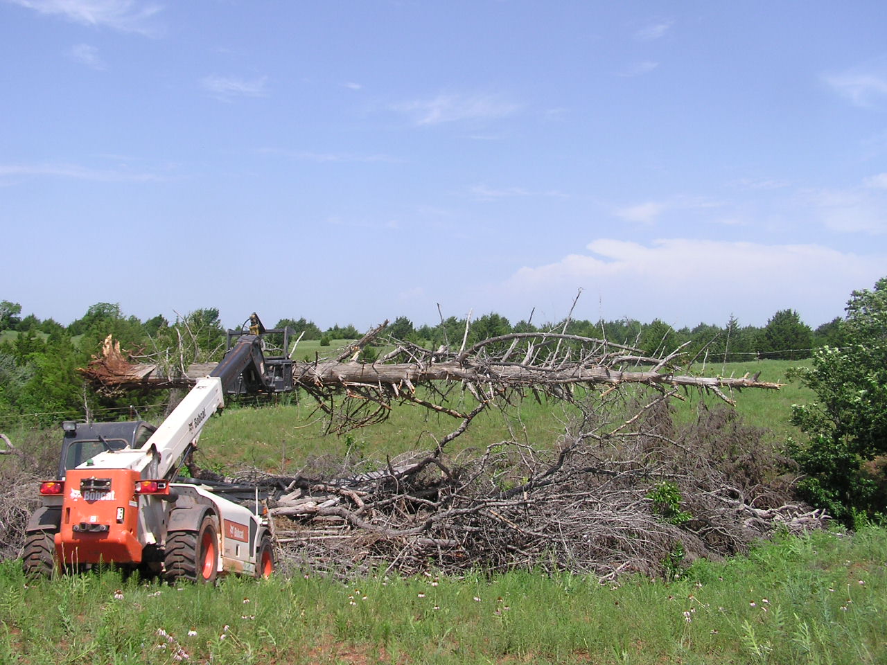

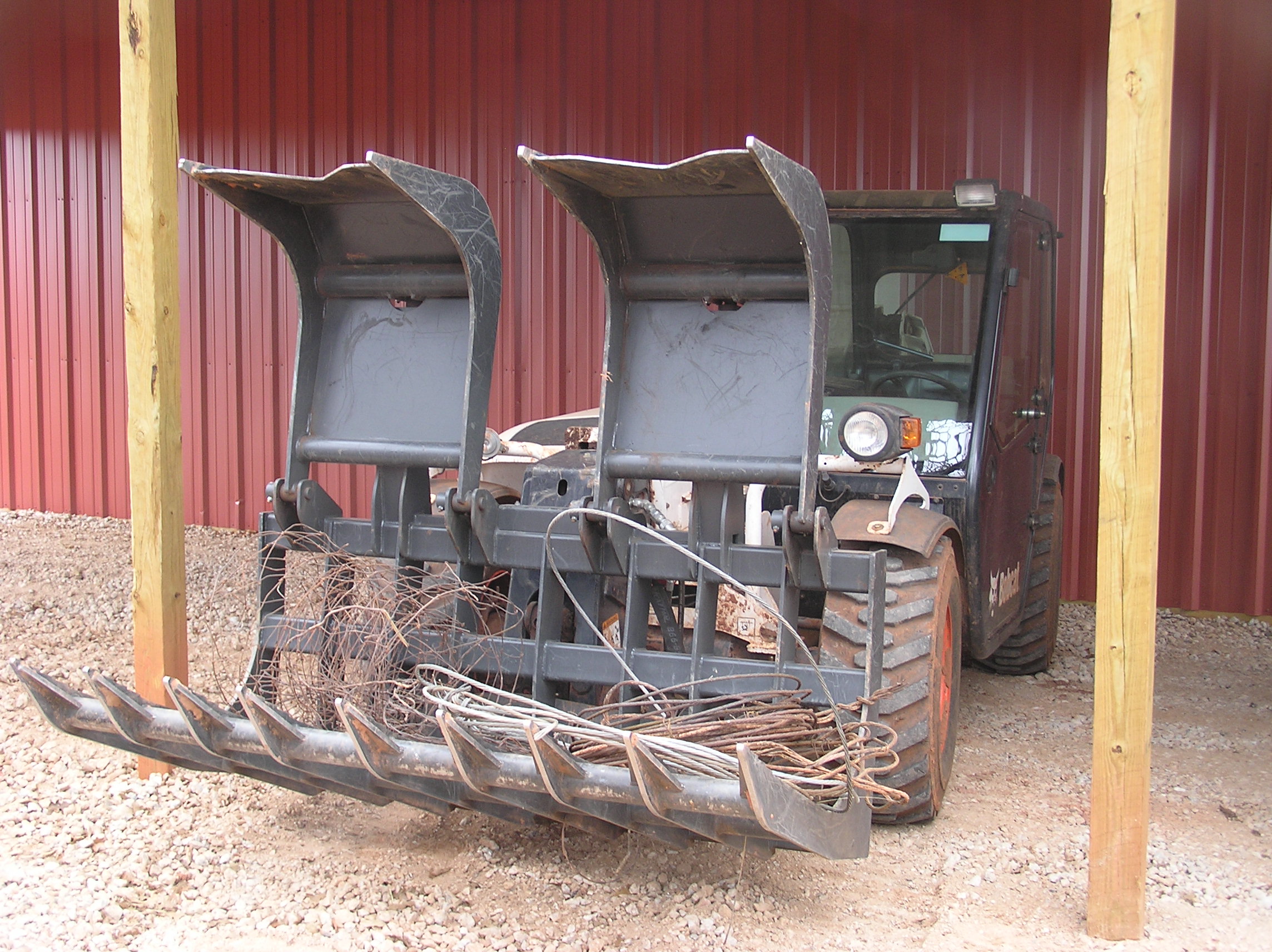

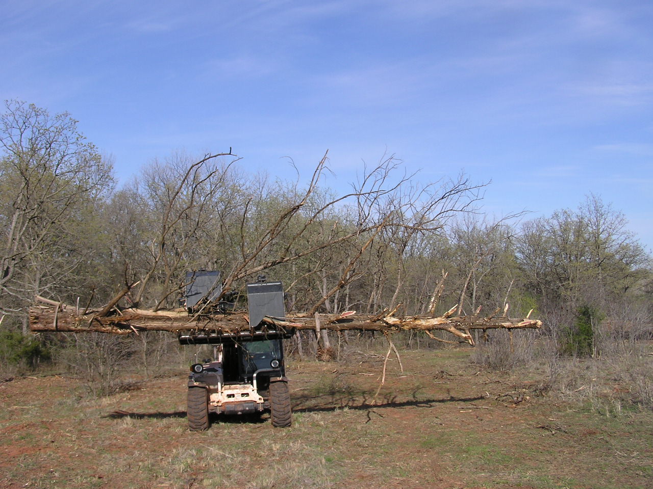

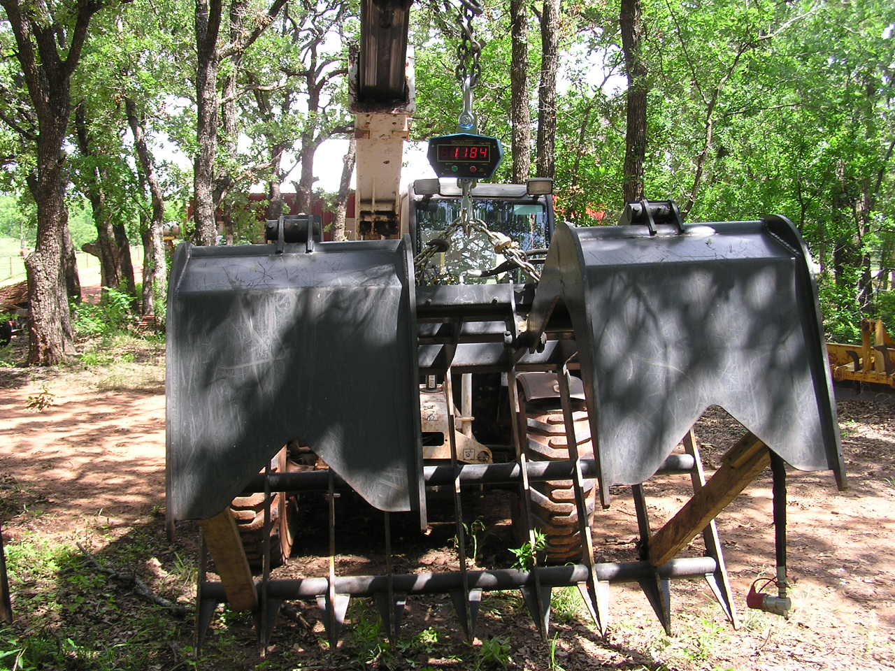

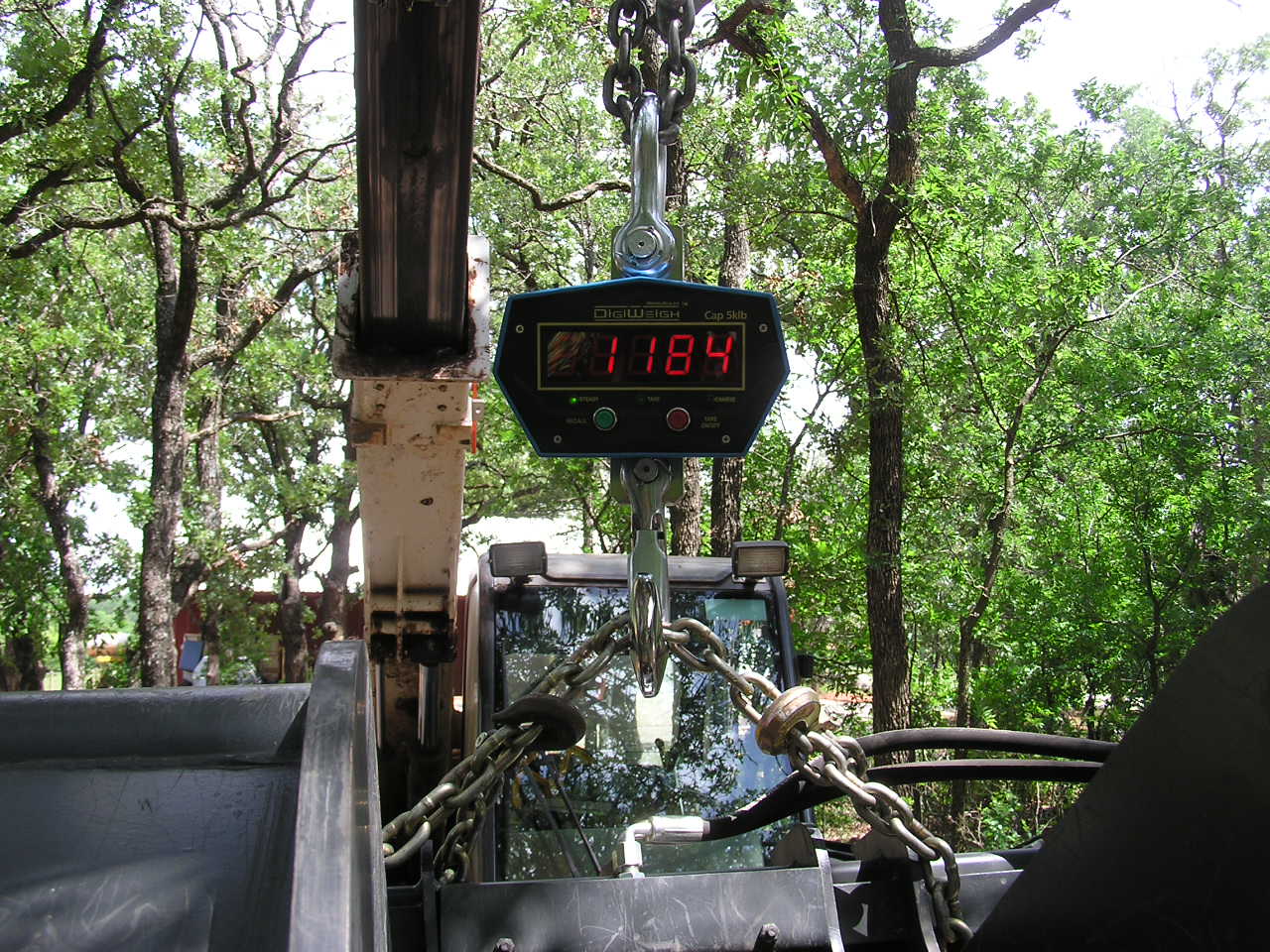

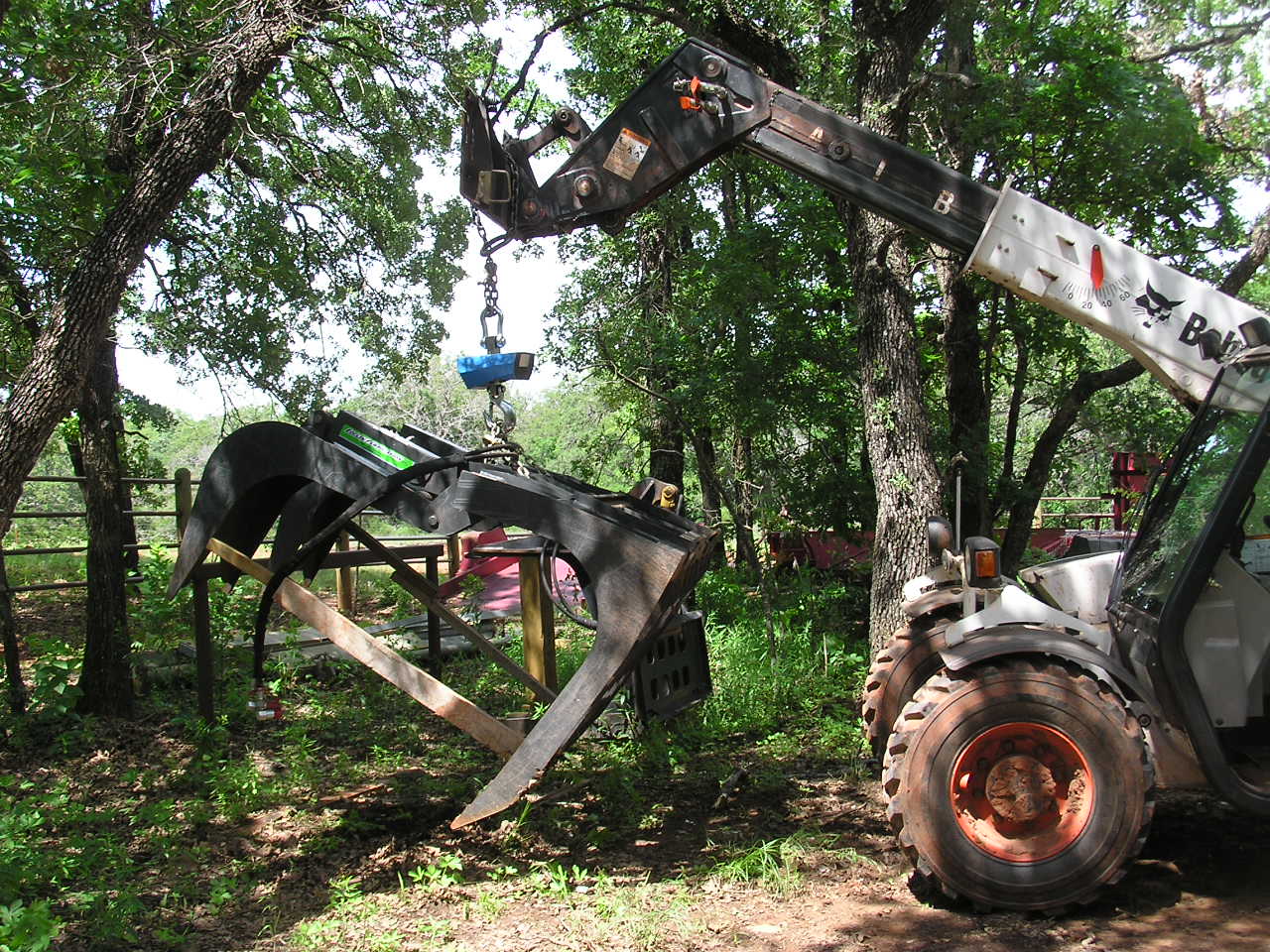

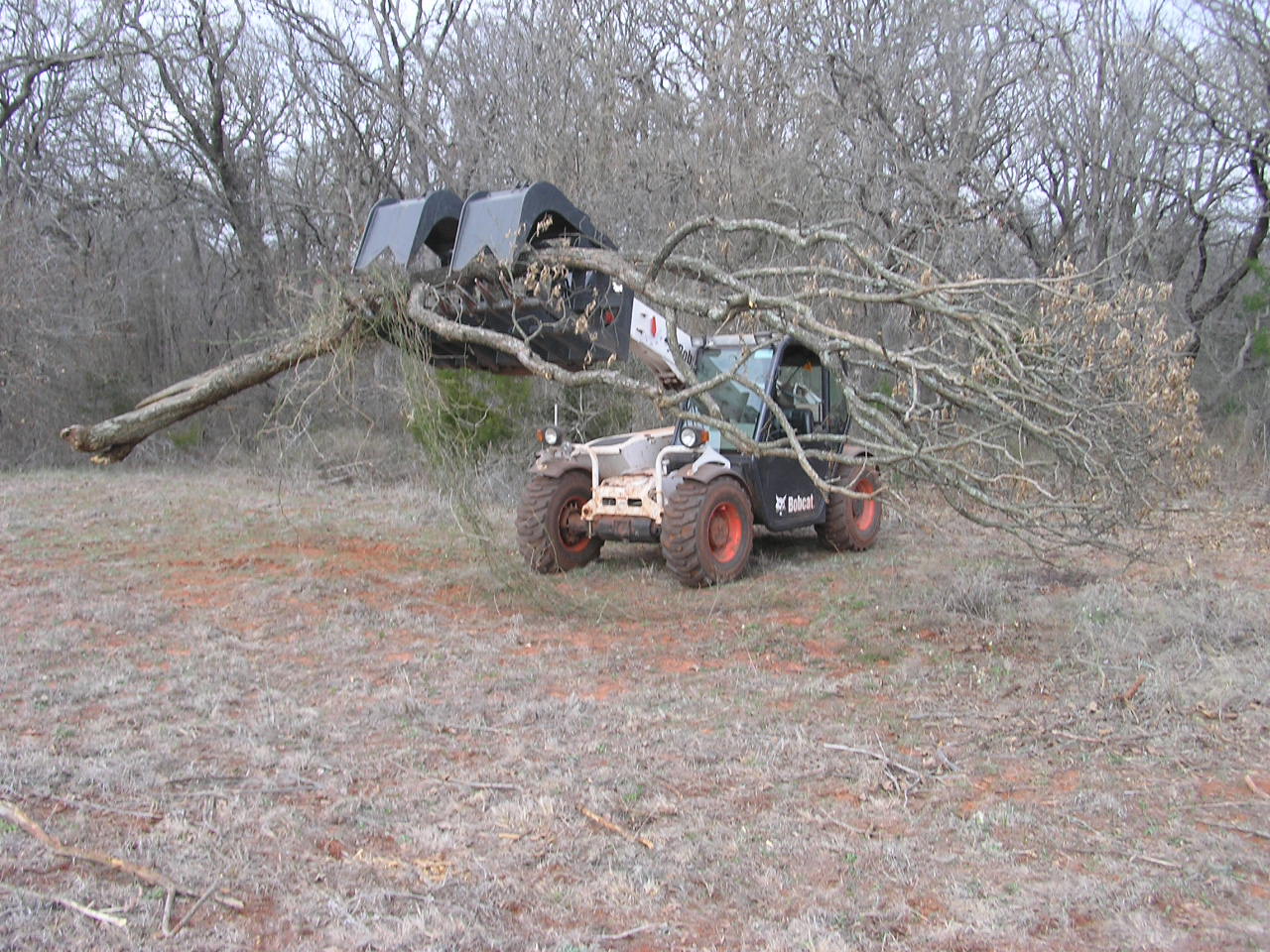

This is the 6' wide Monster Grapple, Shipping weight was listed at 1200 pounds.
The 6' will pick up as much brush as their 8' model. If you are working in the woods, get the 6'.

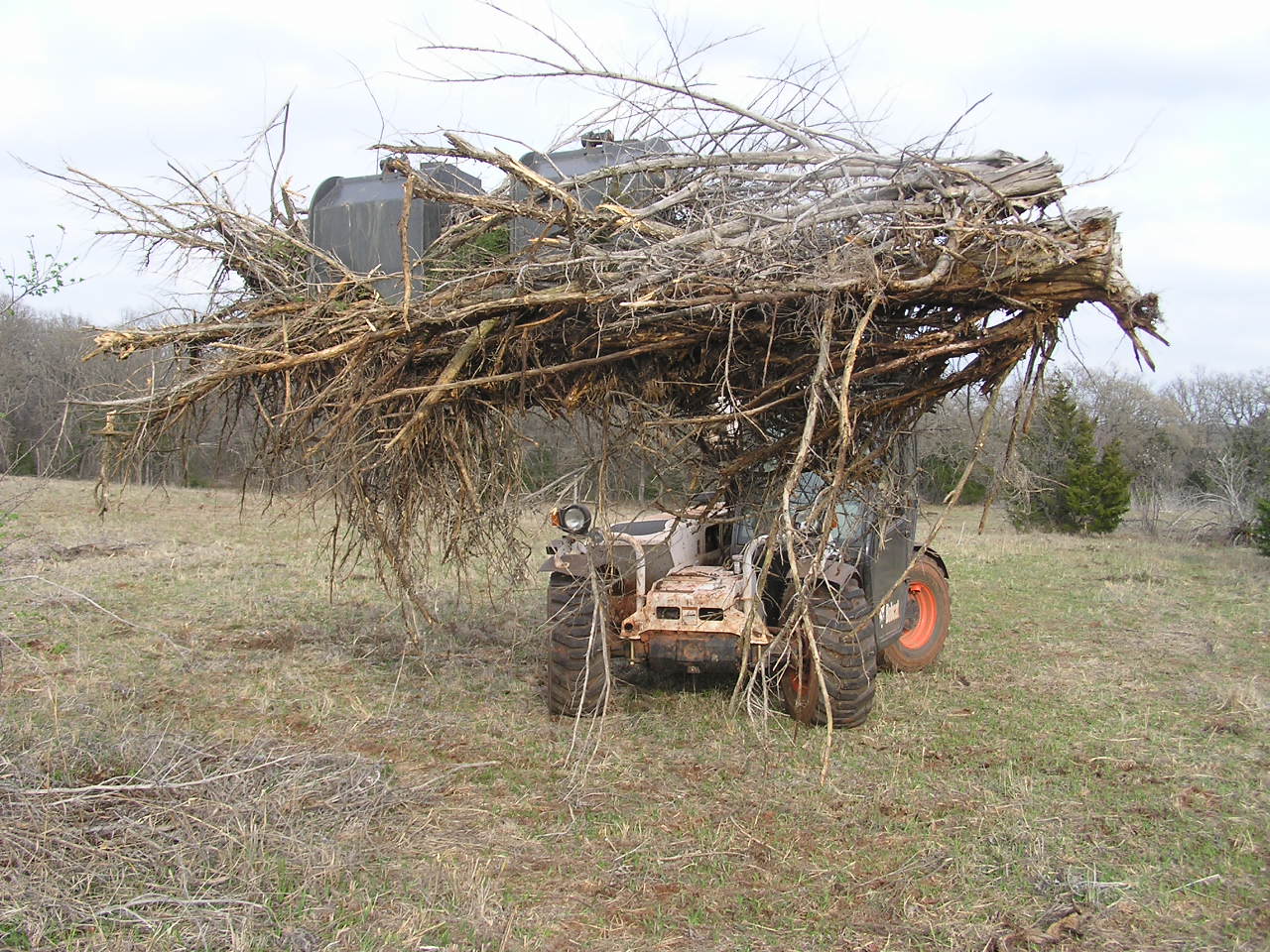

If you need to rake large areas, get the 7' or 8'. And with the big opening it does rake very well. :thumbsup:
The width of the grapple has no effect on picking up long items, since you need to be near the balance point so it doesn't twist the loader arms.

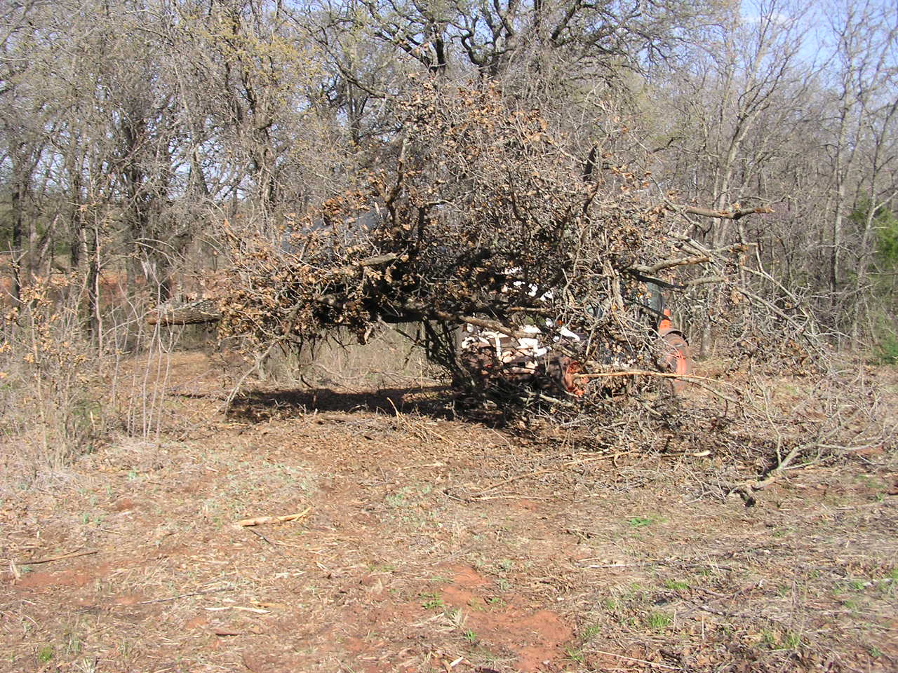

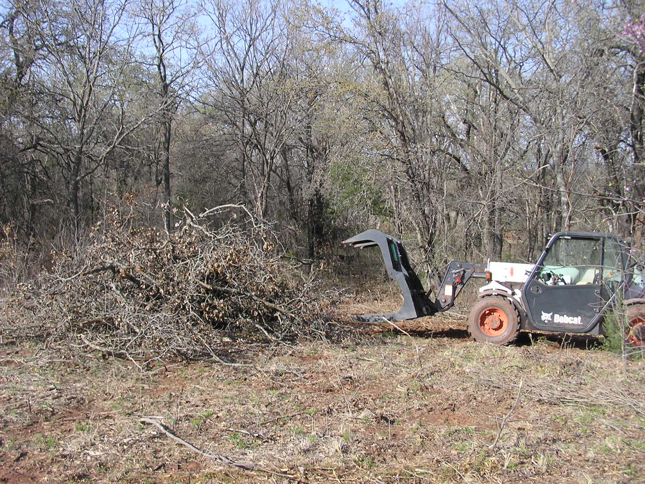

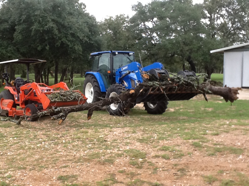

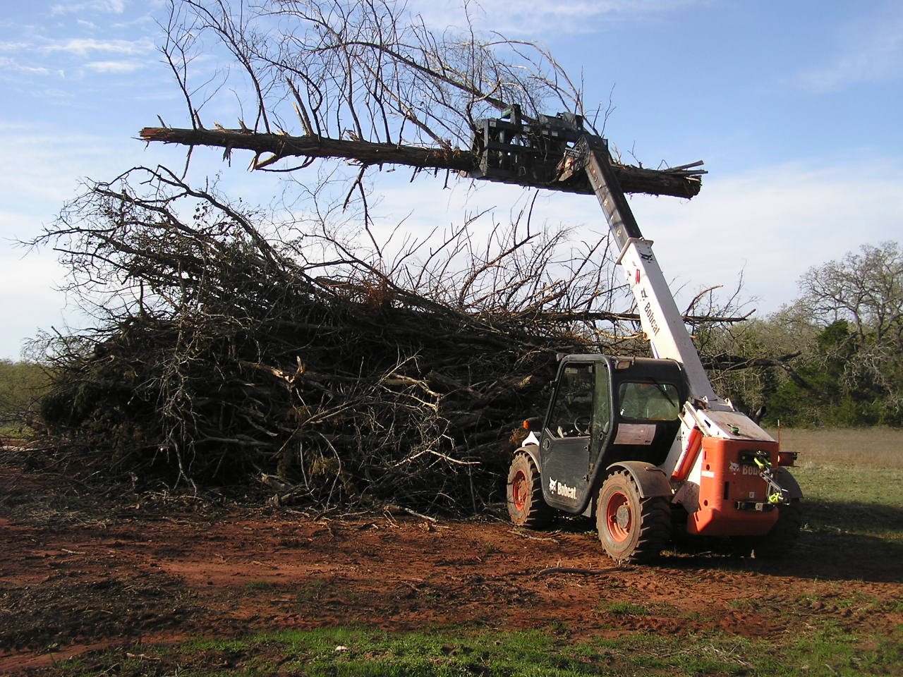

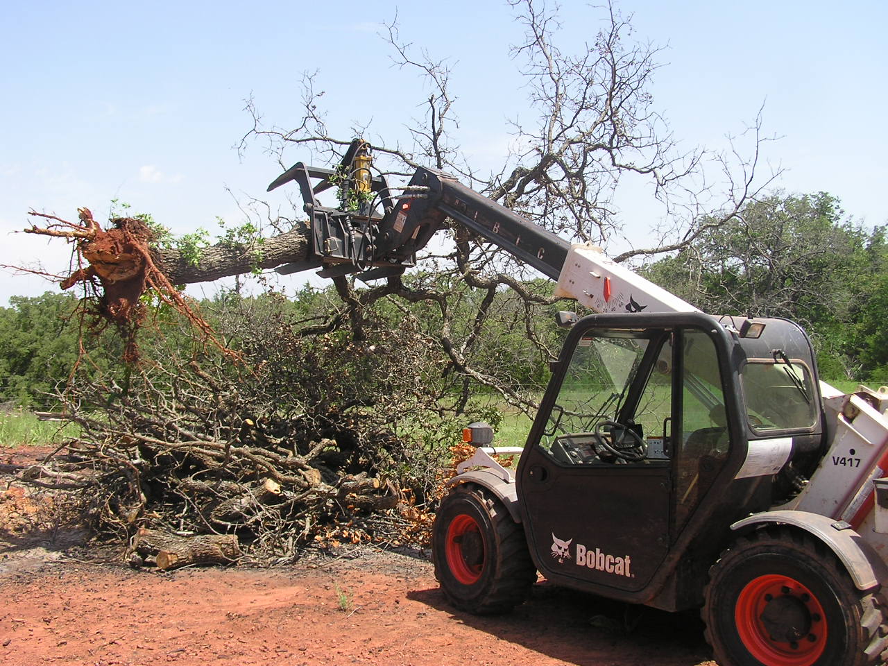

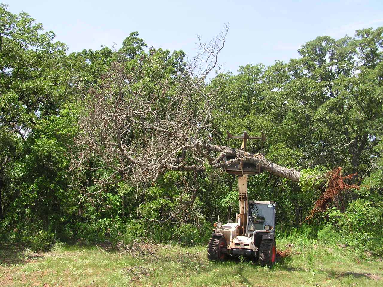

This grapple is 44" wide. Moved them to the brush pile with the top tines not clamped down.
Keep us "posted" on what you get.

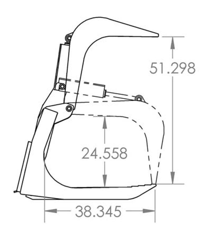

We have a Blue Diamond 84" grapple with approx. 40" opening. I like the over 10" wider opening that Xfaxman has and would have bought that one had I been aware of it. You would have no problems with a 7' grapple.
<img src="http://www.tractorbynet.com/forums/attachment.php?attachmentid=362019"/>
I agree that a tall vertical opening is much, much better if you are moving any significant volume/size of debris. My L bottom has 46" of opening, much better than the 30" to 32" opening you see so often. Those are ankle biters, with calhoun's lift I would get a real grapple. As for width, wider is not necessarily better as xfaxman (guru of large grapples) says. If simply picking up logs or digging roots or rocks, narrow is better. If clearing a path into brush, make sure it is as wide as your outer tire dimension. If picking up loose light debris, wider is better. You get the point, I am sure.
