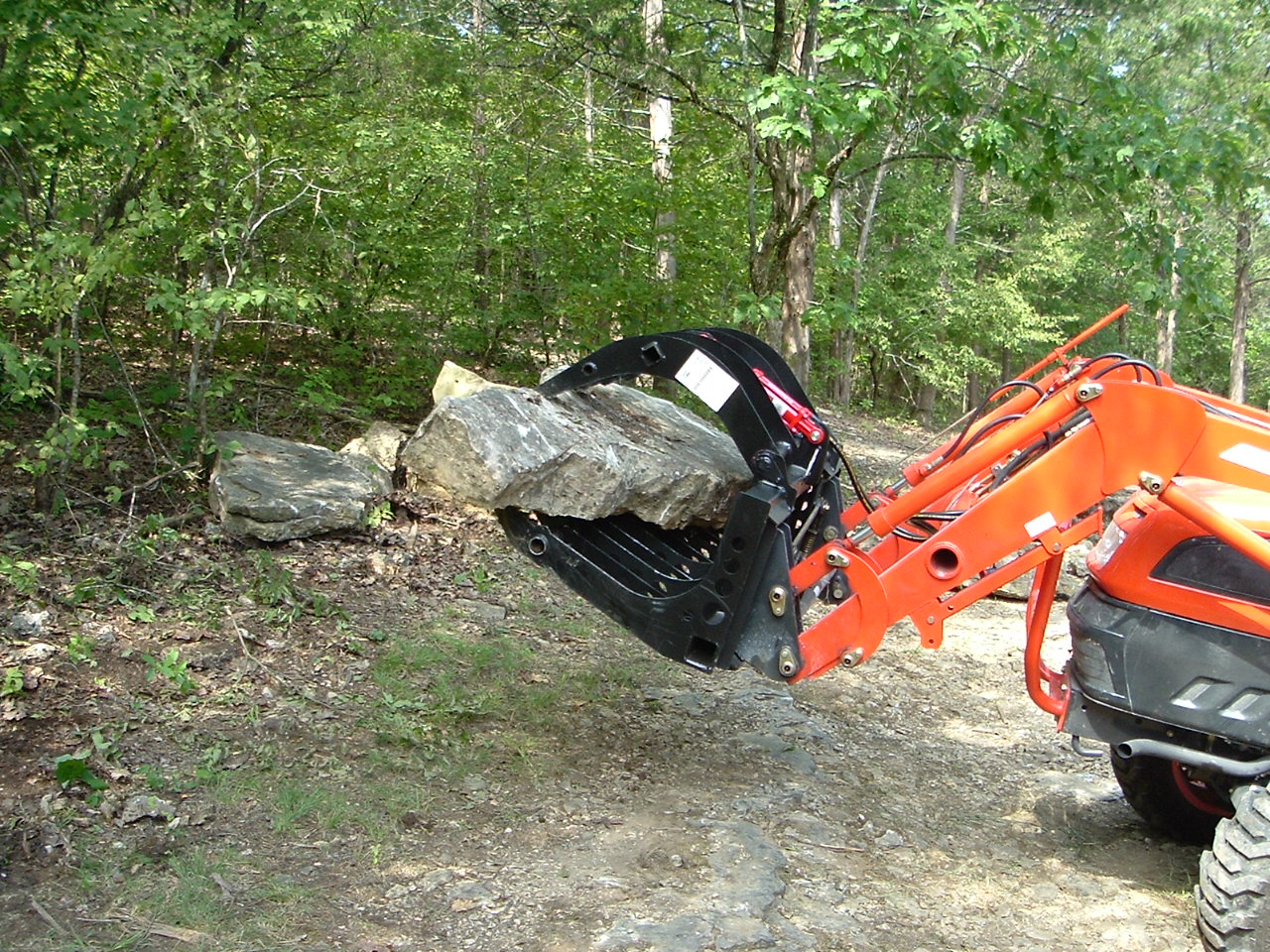

Have you looked at any local sources? I got what I believe is a Loflin locally that works really well for us, it is heavier than you need and we use it on our M8540, but they make smaller ones. I like the double lid as we often handle odd size loads. It was recommended to me by my dealer who uses four on his farms and doesn't even handle them. I was initially going to get a Land Pride.
My experience is very limited compared to James and others, so I will be following this as I'm thinking about getting one for another tractor.

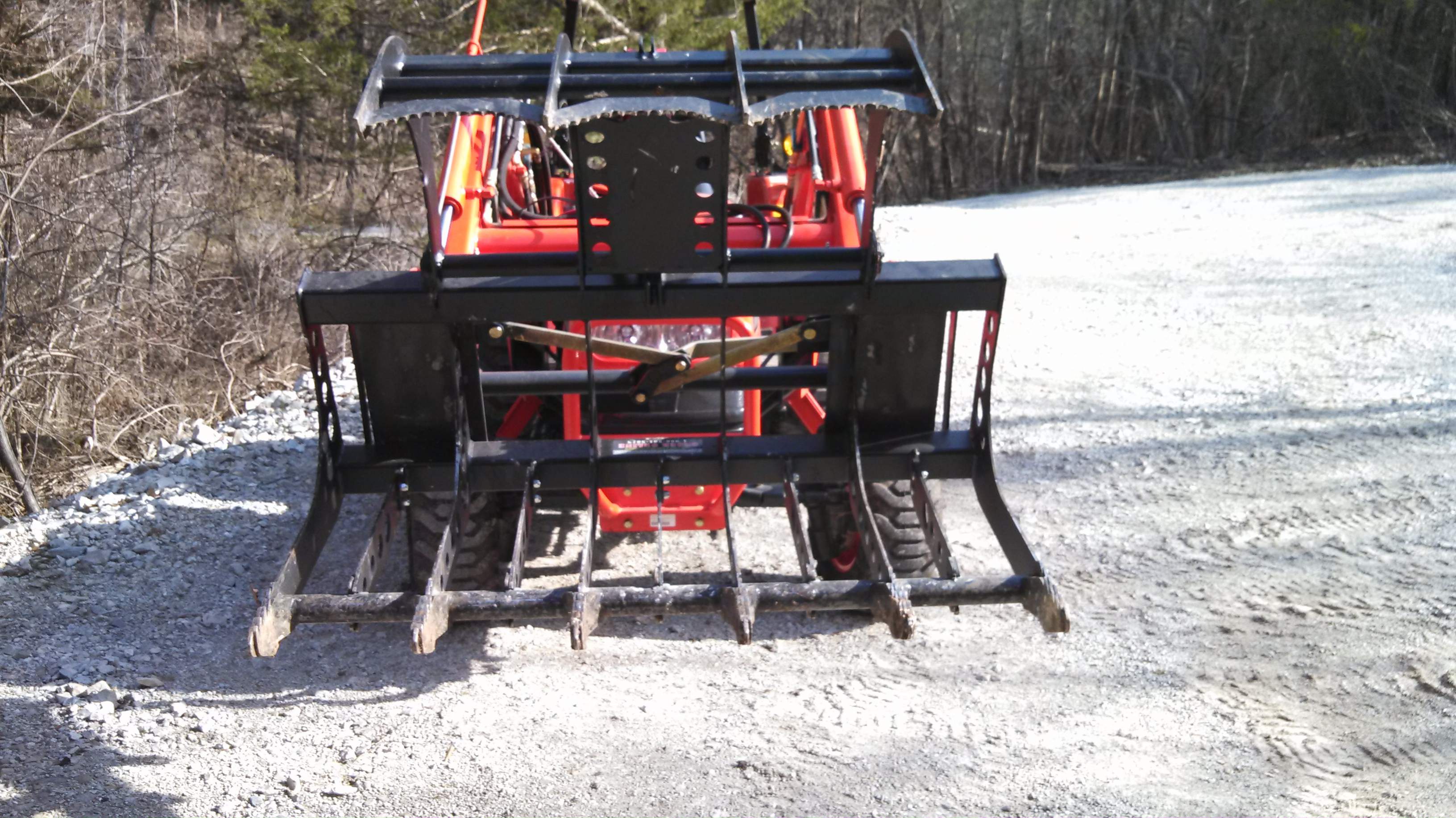

View attachment 379395I did a considerable amount of research before I bought the Land Pride SGC1560 grapple. I place a lot of value on having a local dealer so I can observe & touch any implement. And being local, if I have questions or difficulties. This LP is a heavy grapple - 820# - but still leaves me 3400# of available capacity. It is heavier than you want but it is a good example of the quality of the welds, the engineered design and materials used by Land Pride. I've found all to be top quality, making this a very substantial implement.
   / Root Grapple choice for Mahindra 3016? #13
. What is the actual lift capacity?
   / Root Grapple choice for Mahindra 3016? #14
I'm getting my info from the tables/graphs for my Kubota LA1153 on the M6040. I did some measurements on the grapple after it was installed and the center of the grapple is approximately 12 inches forward of the pivot pin. Based upon these graphs the max lift capacity - 12 inches forward of the pivot pin is approximately 4250#.
The lift capacity at the pivot pin is approximately 5200#.
What I wish they would have is a graph showing how much weight needs to be on the 3pt as the lifted weight on the FEL increases.
Oh, well, I've found that I have enough in the Rimguard filled tires and the 720# ROBB to safely lift 1500# with the new grapple. Anything greater than that will be exceedingly rare and I do have a 400# block of cement I can add on top of the ROBB.
