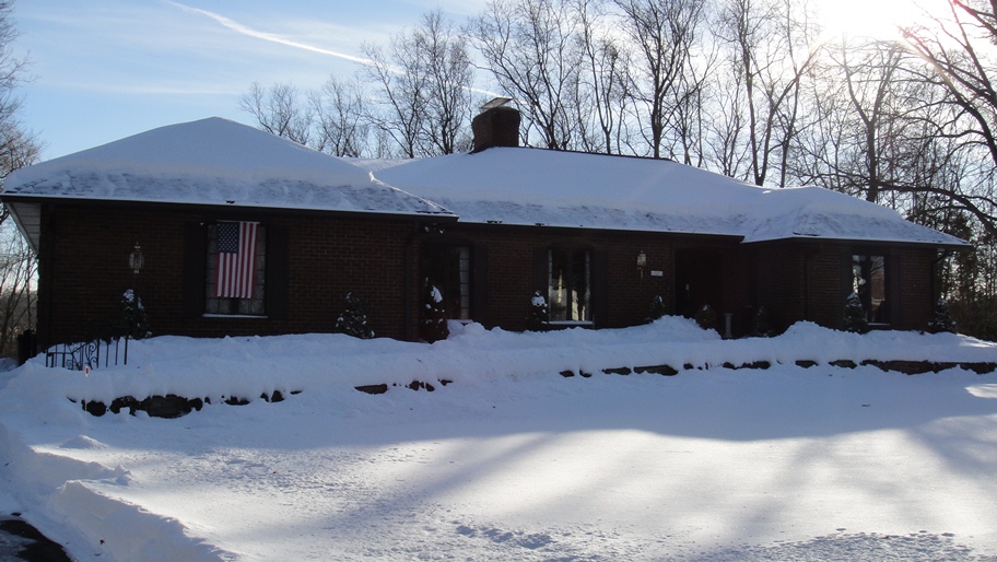

here is a question I posted in another thread, and I'm wondering
what folks around here might think also.
I get ice dams on my 70s vintage ranch house, south side, above our "living room". I usually have
to chop the ice off once a year or so to prevent interior leaks.
the living room is 26' long, and it is the warmest room in the house because i have
a floor vent coming up from the basement with heat from the stove.
the attic has ridge vent, and vented eaves (2 inch strip along the eave the entire length in the soffit)
I still get a large build up of ice , and it's concentrated over the part of the room with an 8' sliding glass door.
As i research the fixes, vent - vent- vent. Eliminate heat loss, insulate-insulate-insulate. I came
up with another possible cause and wanted to see if anybody else thinks it could be a problem.
The masonry dual flu chimney runs up thru interior walls at the end of the living room (which has
a cathedral type cieling). The chimney then continues thru the attic, before it
goes up thru the roof. My thoughts are can this "warm" chimney in the attic space be contributing
to my snow melt/ice problem on the roof? I have no inside access to the attic, but I can probably remove
a gable vent to peek in there (never have). I would imagine the chimney is warm all the way up, at least
to above the roof line. (unlike when the boiler is running occasionally in spring and fall).
Am i chasing a ghost here? or would it make sense to maybe insulate around that chimney so the heat
doesn't end up in the attic melting the snow on the roof? or just more vents?

The problem is the inside of the roof is warmer than the outside of the roof. This causes the snow to melt.
The water runs downhill and freezes again when it gets to the cold part of the roof over the eaves.
Then ice backs up under your shingles and leaks in through the roof decking, usually right above the exterior wall.
Even though the eaves is vented underneath, it is not vented through the blocking between the rafters. There is no air circulation under the roof deck right in the corner where the rafters meet the joists. If there is insulation stuffed in there, it is even worse.
The solution is to make sure there are vents in the blocking between the rafters and then use a product called rafter vents to keep an open air path from the eaves to the peak of the roof, so that the underside of the roof deck stays the same as the outside air temperatures.
Do a google search for rafter baffle vents and start reading.
Here's a link to pictures of them.
rafter vent baffles - Google Search

I think your over thinking this, the best prevention is just remove the fresh snow from the edge of the roof before it has a chance to freeze. Very easy to do on a ranch house, just have to go back 2-3 feet.
You will always have some loss of heat and since you mentioned south side that means it has something to do with sun shine, both the damming and the melting above.
On masonry buildings the freeze thaw damage is often worse on the south side for that same reason.
Here in CT we have that problem less often, but every few years, like this one, conditions are ripe and my phone starts ringing (contractor) with people requesting snow removed from roof.
Did one yesterday, 3 foot drifts in the valleys.
Was LOL yesterday cause my wallet was getting so fat it was hard to close and sit on.
JB.

I am in Quebec and with cathedral ceilings this is a common problem.
For the venting to take place 3 conditions must be met.
-Sufficient space for the air to move out. 2" minimum, 4 suggested.
-Sufficient inlet air space. continous soffit venting best.
-Good outlet venting. the Maximum (brand) I consider the best.
Look at your roof ridge and I bet your little 2" high ridge vent is burried in snow and therefor the heat is trapped, snow melts, water runs down and freezes on the cold overhang and dams up, backs up and creeps under the shingles snd drips into the room.
I generally installed the Maximum vents and in fact to be shure that they'd operate I also add an extension as well as we often accumulate 3-4' of snow buildup.
That attic heat MUST be able to exhaust!
One solution that cures that is to build up a small aux roof along the ridge to create a ridge tunnel and then add a Maximum vent stack or 2 on that tunnel. Naturally you need to slit the ridge open about 2" to allow all the hot air from each rafter space to exit into that tunnel.
Now if the builder stuffed all the spaces between the rafters full up none of the above will work as the hot air just can't exhaust.
The only solution is to then lay 2 x 4's and a new deck to get that vent space.
Can tell U that around here many homes are chalets converted to all season dwellings and many were built with cathedral ceilings and rafter construction.
Today most of them now sport that second roof deck and air space technique.
You can spot them because the facia's are thicker than normal, or double facia.

While the rubber membrane will most likely stop the water infiltration, you will still get ice dams if you don't vent it properly.
The ice dam will still push your gutters, fascia board and soffits around and cause slow, but sure damage to your roof.
Until the spring, the best thing to do is use a roof rake and pull the snow off. You only have to go a little ways past the area over the exterior wall. No need to clear the entire roof, or even 6' back. If you have 18" eaves, 3' ought to do it. Especially on a south facing roof. The melt water will evaporate mostly before it gets to the edge and you shouldn't get to much buildup.
How do I know all this?
Because my roofer failed to install vents in the blocking between the rafters, I get ice dams each year, and I have to get up there, remove the soffits, vent the blocking, vent the rafters, re-insulate and fix it myself, but have not had the time. :laughing: So I roof rake after every significant snowfall. It takes about 20 minutes to do the whole house, except for two weeks ago when we had 3' of snow! :confused2: Then it took an hour and my arms were kinda sore! :confused3:
