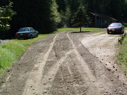

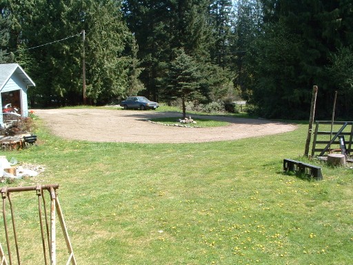

Here is the turnaround after. That is 3/4 crushed rock with fines. When driven on, it packs down real smooth. The grader did a pretty good job of blending the colums left by the dump truck and with the rear gate down, dragged the thicker spots to the thinner ones nicely.

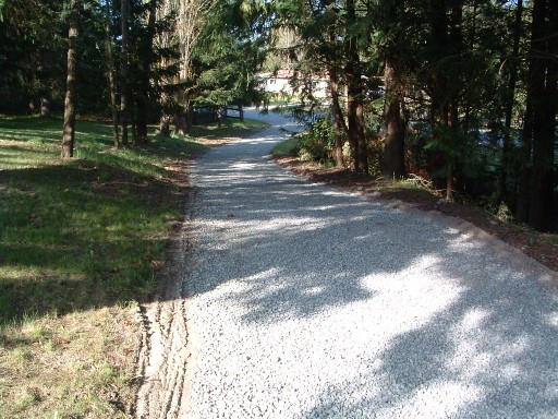

Here is a shot down the hill. I used around 22 CU/YD total but I think I will have another 2 yards or so delivered to do a matching walk and fill in one thin spot down near the road. I think it came out pretty well considering this project started as a pile of metal 2 weeks ago.

I was really surprised how well the dump drivers can lay down an even spread of gravel. I have about 300 feet of uphill driveway. The first truck went up the hill dropping his load, the second did it going downhill. When they were done, I didn't need to do a thing!

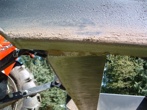

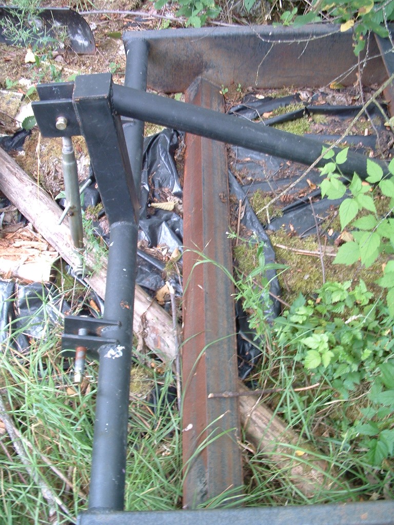

SkunkWerX: I will see about some overhead pics, I may have some in the pics folder.

I attached a pic from above, at least of the front blade. The rear blade is a little hard to see under the crossmember and fold up gate and the back end is pushed into a berry bush behind my barn right now:) The very first pic I posted back in April 06 is a side view that shows the blades pretty well also. they are perpendicular to the line of travel, front edge of front blade is 3/4" lower than the side rails.
