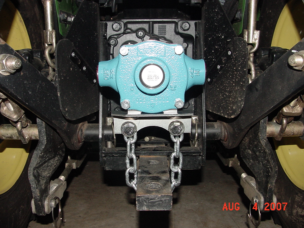

Need some help from the sprayer pro's:
I am building a 3PH 30 gallon sprayer from a pallet of parts I got at TSC for $100.00...
Can you please tell me if the way I have the roller pump secured is OK, or does it really need to be "supported" like the directions say. The chain is loose enough that it's not pulling the pump down, but taught enough to only let the pump rotate about 1"
Thanks for you time:D

I made a similar sprayer and after the first use, I never bothered to chain the pump down again. The hoses hold it just fine.
Since you appear to be a frustrated plumber like me <G> consider arranging your hose connectors so you can suck out of a stream or water tank to fill your tank. That has been very useful on several occasions.
Something else I found was to mount the tank with a good tilt toward the outlet. It never fails that the tractor is sitting the wrong way on the hill and I can't get the last 20 gallons without turning the tractor around. I finally slid a couple of 2x6's under one end.

wow, i've never seen one that secure!! but more secure is bettern than not secure enough. good job

Yeah, I think the idea is to keep it from spinning the hoses around itself in case of a lot of resistance. Looks like yours isn't going anywhere.

Thanks guys, that's what I thought...But the instructions want the chains coming from above to "support" the pump body.
Just didn't want to ruin a +$100.00 pump:D

Per the instructions that tiny hole in the drawbar should be on its lower edge, with the chain bolted to it. Instead I chained to the lower 3-pt pin so I can use the backhoe's hydraulics to get the drawbar aligned.
I have since added a hook that I attach after the drawbar is in place, to put the chain's stress in line with the pump's bearing. I expect the pump will last longer that way.
I'm amazed that any pump is designed to be supported by its input shaft!

zzvyb6, a bar bolted to the face of your pump that drops down past your drawbar (the real one!) would prevent rotation.
/ Roller Pump Attachment Help #9
I did the same thing with the hydraulic pump for my backhoe. Just secured it with one chain to keep it from spinning the hoses around.
