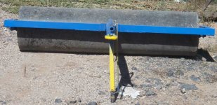

I took a leaking lawn roller, filled it with concrete. Works great and I do exactly what you are asking about. I have some slopes as well. Packs great! Especially important for the motorcyles......
Mine was 2'd x 4'l. Think it ended up being 1750lbs

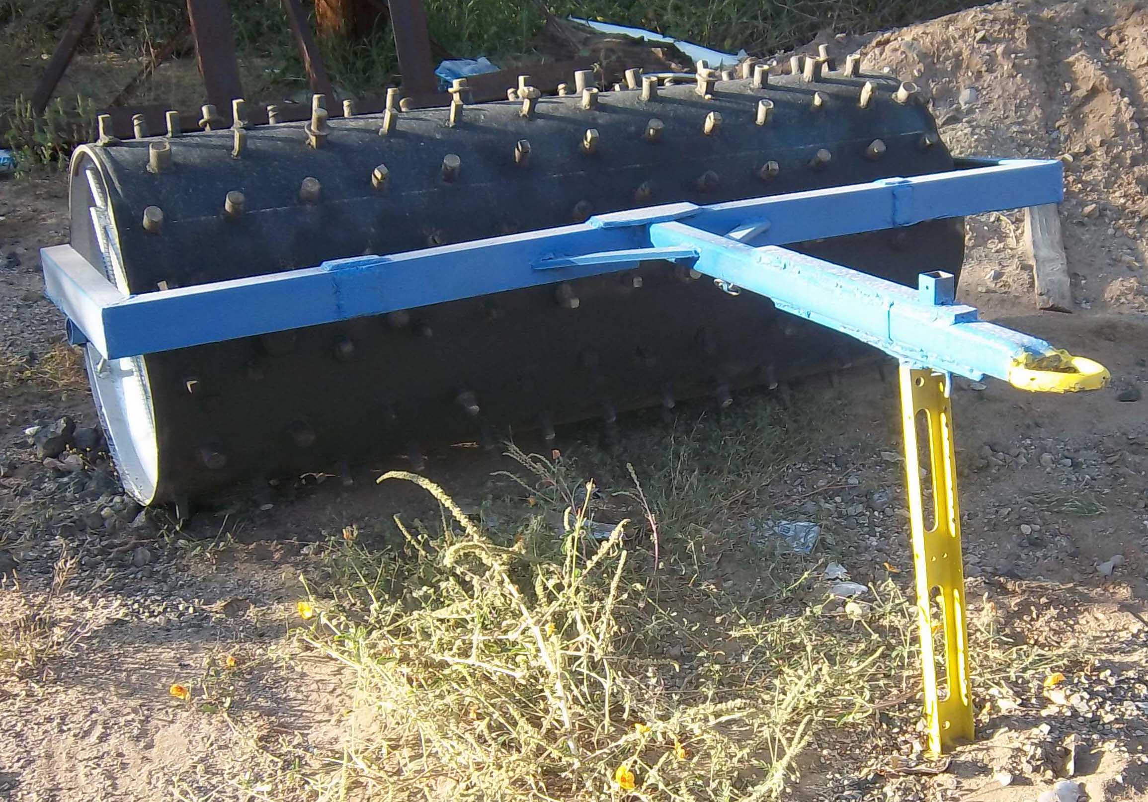

Hey crash, looking for inexpensive ways to work my rec acreage, like your pic, and way to help with how you built your unit, pics, drawings, measurements, and where you found parts

Those of you thinking about a vibratory roller, how are you planning to do it? I've been thinking about one for awhile and my thoughts are to run off the PTO to a shaft turning an out-of-balance disk near or behind the roller axle. Anyone have any thoughts about how much out of balance it should be? Or better ways to do it?
Also, I have slopes here as well and have to deal with that, very little level land. So, I plan to put brakes on the roller. I can do it with the hydraulic ports running a cylinder that presses a piece of tire against the drum. I also have brake lights on the tractor so i've been thinking about tapping into those to run an electric solenoid to power the drum brake.
