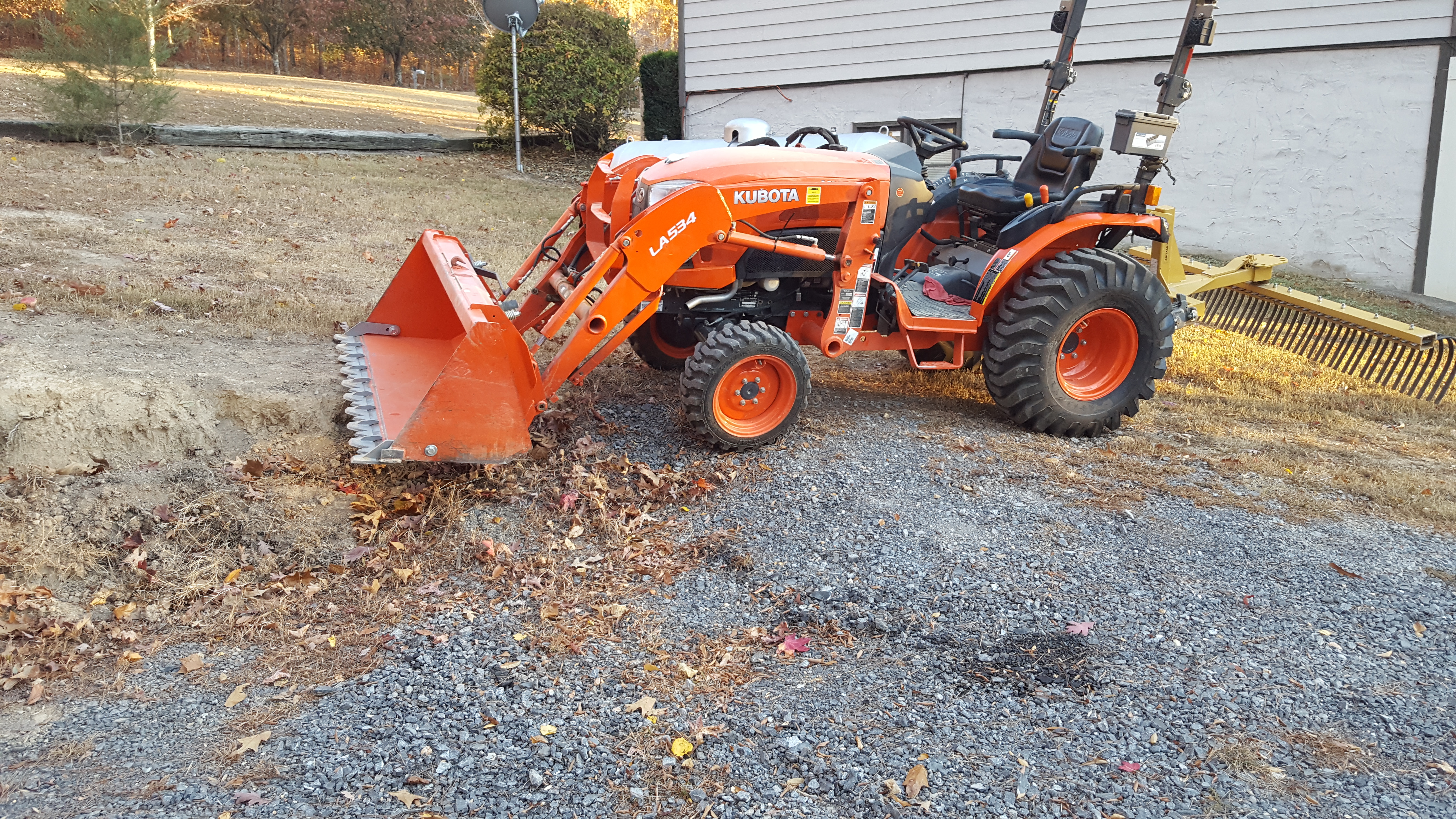

Pulled the glow plugs tonight and they did have oil in the cylinders.Put it back together and fired it up.Good to go again.Thanks for all the help.

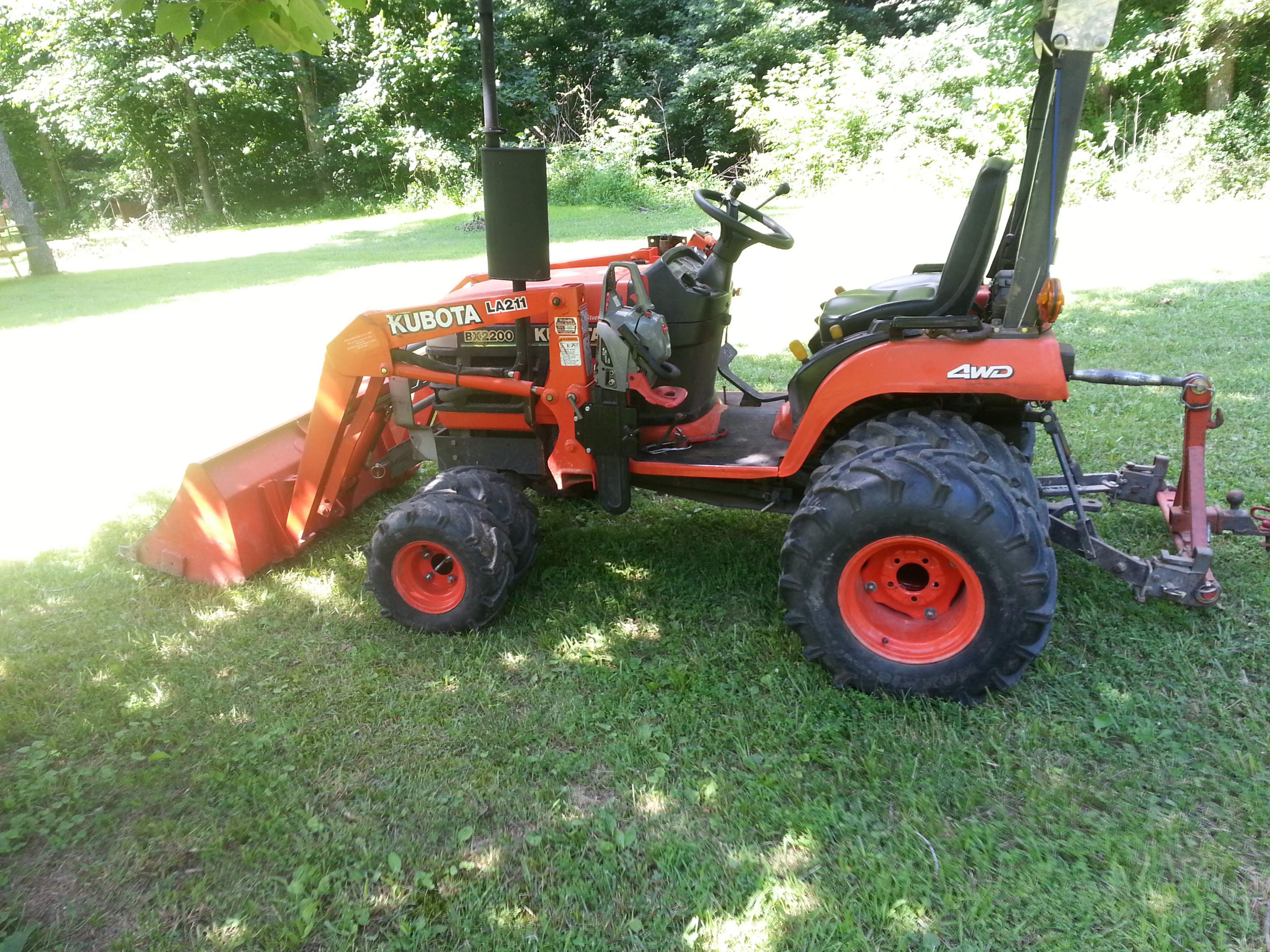

Nor mine!:laughing: I to laid mine (BX25) on it's side while not even moving but I only did it one time. Did have a few close calls other times. Got so close one time that I had to gingerly reach back and push the BH leg to go down on the down hill side to stabilize it and then swing the BH bucket around to the high side and pull my backend around to up the hill side. Started to jump off but didn't have KTAC Insurance. :D

Bucket was on the ground pushing dirt.it will probably be the weekend before I can get a picture.I would love to have a set dual wheels on the rear for stability.In hindsite I had a 7ft landscape rake on the back.If I had dropped it maybe it would have give me enough support to back off without rolling.

Here is where i was at1479681318752.jpg when i rolled it over1479681293170.jpg
   / Rolled it over tonight.Question?B2650 #39
Thanks for the pictures. Hopefully your 'puckermeter' now has been calibrated for future reference!
