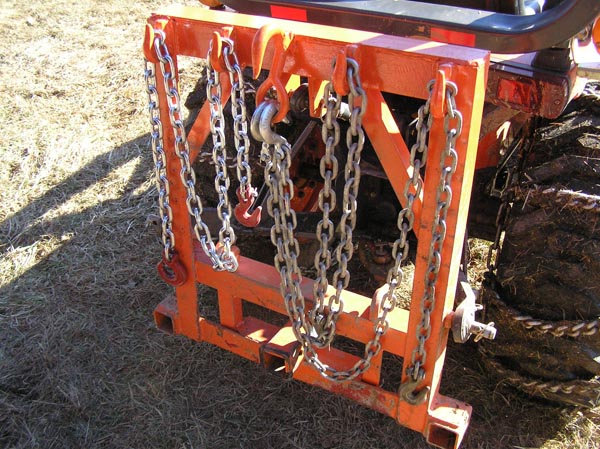

When dragging heavy objects fill the bucket with rocks. That will give more traction and help keep the front end down.:D
With a large heavy object chained to the tractor be very leery of going downhill. The rock/log can roll to the side and pull the tractor with it. :eek:
Many folks make up a frame for the three point hitch that has places for chain hooks and trailer hitches etc. There are some threads covering them.
I also bolted some truck springs to the bucket to act as forks and added a extended frame to stop logs etc. from rolling back in my lap.
pictures attached.
