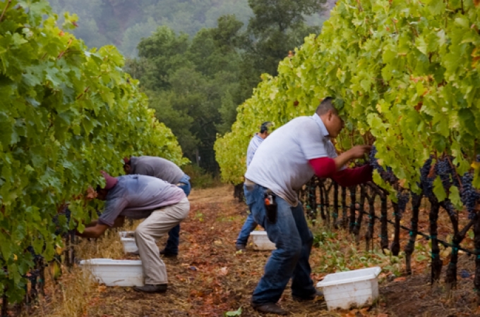

What about grapes, hothouse tomatoes, mushrooms, and other environments like those where there are smaller lugs of material that people are picking into and have to transport back to central depots? Any thoughts on potential pain in moving materials there? (settings such as this: Wine-Harvest.jpg)

What about grapes, hothouse tomatoes, mushrooms, and other environments like those where there are smaller lugs of material that people are picking into and have to transport back to central depots? Any thoughts on potential pain in moving materials there? (settings such as this: View attachment 498066)
I suspect that it would work, but I would ask someone in one of those fields.
