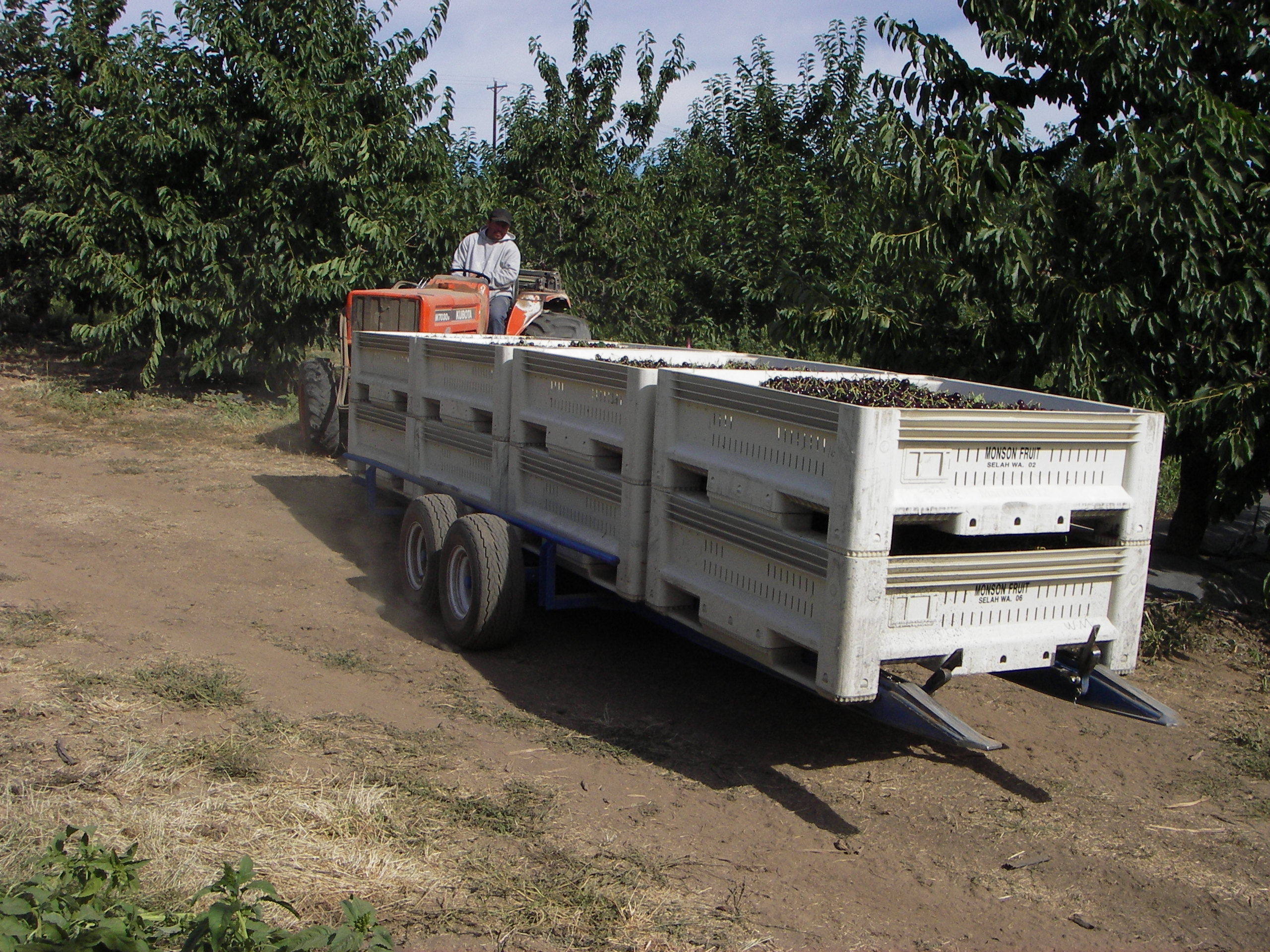

For apples, you would need at least a 1500# capacity (so it can hold a full apple bin) and usually, they use a bin trailer like this one to pickup bins (the bins are pre-staged empty and trailered after they fill):
Source: Carter Orchards
The reason is that they are hand picked, but then they are moved in bins until they are ready to be processed. You CANNOT dump them unless you are making juice, applesauce, etc.

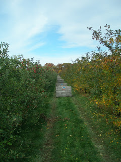

Around here, they stage the bins going down the rows and they run a bin trailer down the row to pick up the bins. A bin can generally be filled within 2-6 trees and they will work trees on both sides of the aisle, so they dont have to walk more than 25 feet to the bin.
Here is a video of a bin trailer in use. About halfway through you can see how they are spacing the bins:
A picture (source: A LIFE OF APPLES: October 2:) )
Now, that might work well with grapes, strawberries, raspberries or blueberries which use smaller bins (perhaps with a remote that lets workers put a "stop" in for it when they have full bins), but apples are hardy enough to be put in 20 bushel bins that are handled by tractors and forklifts and IMO your machine inst anywhere near heavy enough to handle them.
