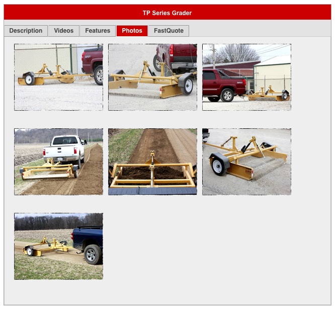

Forget a LPGS, just buy a bi-directional tractor and this ...
