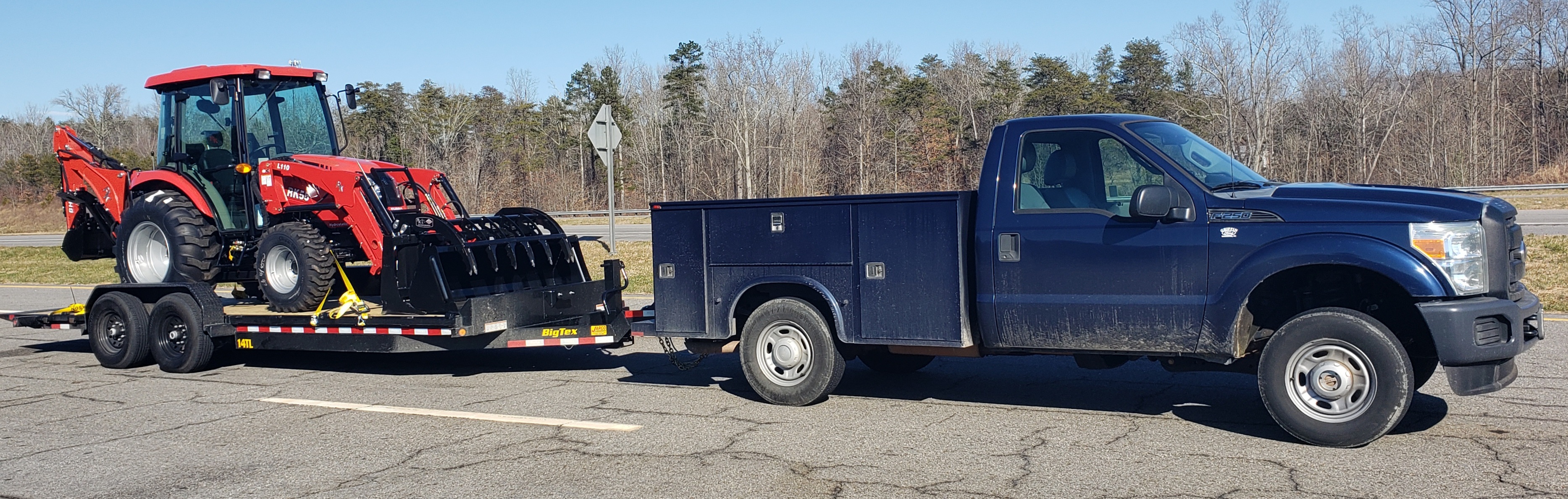

Recently got my new rk55 home and I am planning on doing some low grade hardening to prevent damage when I work in tight places mostly in the woods or field margins.
Other than removing the turn signals and mirrors before they get ripped off the hard way... Anyone got ideas of vulnerable areas that need protecting? Or good mount points for protection?

The one thing I would do since you have a grapple, is to reinforce the brush guard on the tractor with expanded metal to keep those "OOPS" from punching holes in the grill! Yes I found out too late and didn't see it coming. ( A stick sticking straight out of the bank I was dropping a load of brush over).

Tongue weight a bit too much for that truck?

Hey guys thx for the input, we're working on the grill guard for sure. I've speared a bunch of radiators over the years!
Re: tongue weight maybe a little that's what I pulled into the retired weigh station to check. F250s are a bit infamous for that sag look. Felt OK. That was the first load. Found a little better position for the hitch and ball (both adjustable). Beyond safe, I wasn't willing to fiddle too much since a weight distribution setup is en route.
The service body creates a bit of an illusion.
Ford’s tend to sit low in the back with a load. They drop a little more than others. I’m sure it was fine.
/ Rk55 forestry hardening #7
Lol my first reaction to the pic was F250 normal for a Ford. Used to drive me nuts on construction sites
/ Rk55 forestry hardening #8
That small wheel well on the service body and the camera angle really exaggerate the sag. I agree with the idea of a full grill guard. I'd also take a closer look from below, to spot any wires or hoses that could use some shielding or tie-ups.

A set of "Airlift" bags would work wonders for that truck!

Thx gang! We're considering bagging the rear of the truck. The service body definitely lends to the illusion... It rides and handles well... Even though it looks out of trim all the time.
On the tractor here's what I'm doing...will post pics.
-Skid plate mounted below to protect the loader hydraulics and the filters.
-Shin guards for the steering cylinder/rod ends
-Remove the mirrors, front turn signals
-moving the windshield washer fluid inside the cab, I mean wth... Its current placement is clearly an afterthought.
Still looking for a solution to protect the plastic cab top and glass corners.

I think we're going to do something for the back of the grapple and a different something for the grill guard... Might just add mesh to the existing one.
A forum member posted that he's selling a solution too, even tho I barked at them for pretending to 'find' and recommend a product... I'd consider buying a well fabbed grill (more importantly rad/cooler) guard.

I put some expanded metal to back the grapple.
And we made a simple guard for the filters under the cab.
Those extra hydraulic ports allow me to use the loader control for the top/tilt cylinders on the rear.
