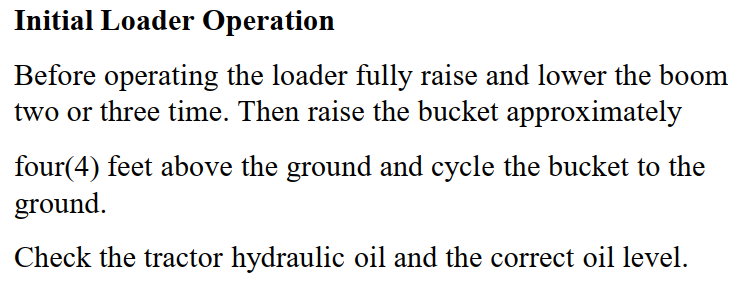

Stikky, as Jim mentioned the FEL needs to be cycled through it's ranges to make sure the cylinders are full of fluid. Here's an exert from the FEL manual.
Make sure the rpm's are raised above idle to ensure the required pressure. I run my bucket through the full curl/dump range several times before I get rid of that limp mode.............Don
