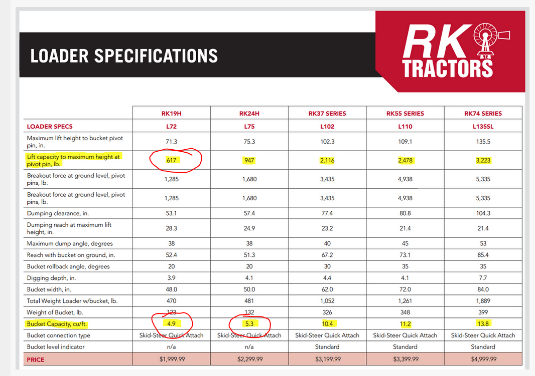

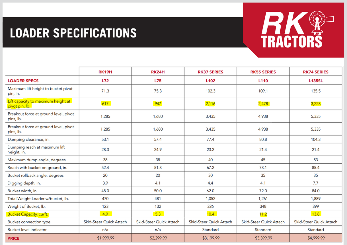

Not surprisingly, the 10.4, 11.2, and 13.8 are EXACTLY the same volumes as in the Jeff9366 initial post.
Jeff9366 also stated that HE obtained those numbers from the RK literature.
So.......what additionally have we now learned?
They are oversized for transporting gold. Or even lead.
   / RK Tractor FEL Lift Capacity Vs. FEL Bucket Volume #13
What additionally have we learned? The three numbers circled in red, which were not in the original post. As well as knowing that the RK website is indeed functional. :rolleyes:
