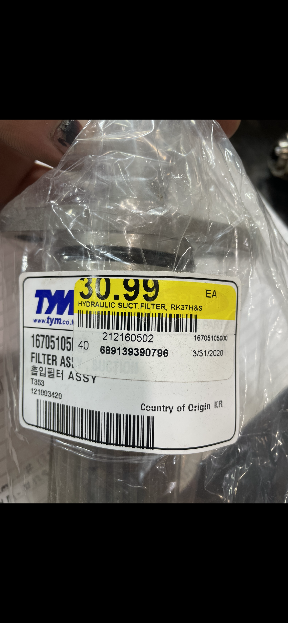

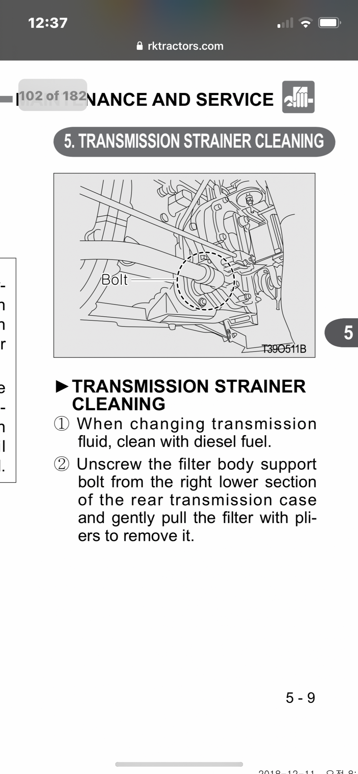

I have the RK37HC Parts Catalog and it shows the location of hydraulic system strainer, that you're inquiring about, located on the lower, left-hand side of the transmission housing; as referenced from the driver's seat. See attached excerpt from Parts Catalog.

Thanks DRP........ That's what I've been looking for. From the picture in the manual I never would have guessed that it had a hose attached to it. Picture doesn't really explain a lot.

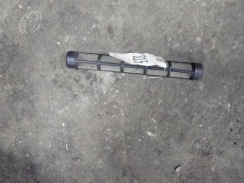

I know this is an older post. But I have a rk37 shuttle shift and it does in fact have a strainer. It’s about 10 inches long and I even got an extra for rural king to have just in case. But mine being a shuttle and not a hydro trans it does not have a screw on type trans/hydraulic filter like your hydrostatic trans does. Maybe the hydro needs the better screw on filter?? And the shuttle doesn’t?? Idk but mine has a 1 inch pipe connected to the other end of the screen filter. That yours must not have. Because my screen filter has a hose barb sticking out of it and not like the one in the picture being pulled out with pliers. I think the manuals really suck. One place says mine holds 4 quarts of oil. Another says over 5.

It will definitely allow the oil to come out when filling the strainer. Unfortunately. I drained like 10 gallons and when I pulled mine still drained a lot more. But the hole for strainer leads directly in the pan where the oil is. Have a good one man.
