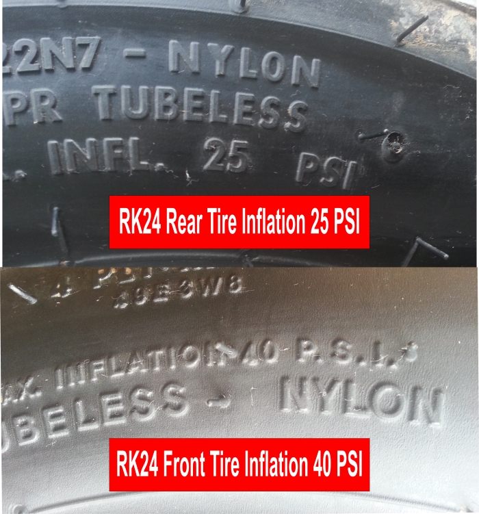

:confused:Where can I find the tire pressures for R4 tires on the RK24. All the operators manual has is the tire size.:(

Look on the tire sidewall -- if you have a front loader and/or carry implements you can run the max pressure quoted on the sidewall. That is standard practice across most types of construction equipment and tractors. Some people will dial back a few PSI in specific scenarios. If you have to ask why and how much, then you are probably not one of those people. ;)

My RK24 with R4 tires have the following Max PSI on the tires:
Front 10
Rear 25
That's about where I leave them for good all around use. But, I do normally have the FEL and backhoe on my tractor, so the tires are ready for max weights front and rear. Your usage may vary from mine.

Ohio, Can you double check.....I looked at my tires and the front are 40 and the rear 25. I know looking in he manual, it has no information at all.

Definitely will. 10 pounds does seem low. Maybe I didn't wipe all the mud off when I read it?

Can't imagine you would be able to turn it with a bucket full and 10 lbs in the front. The tires would probably roll right off the rims.

coastie, you are absolutely right. 40 front and 25 rear. :tractor:
