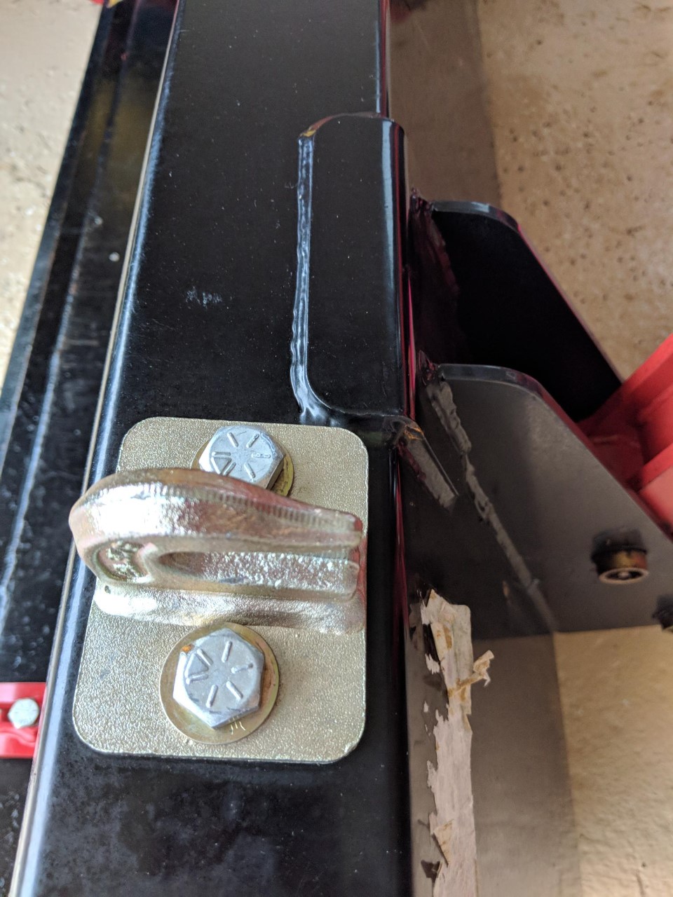

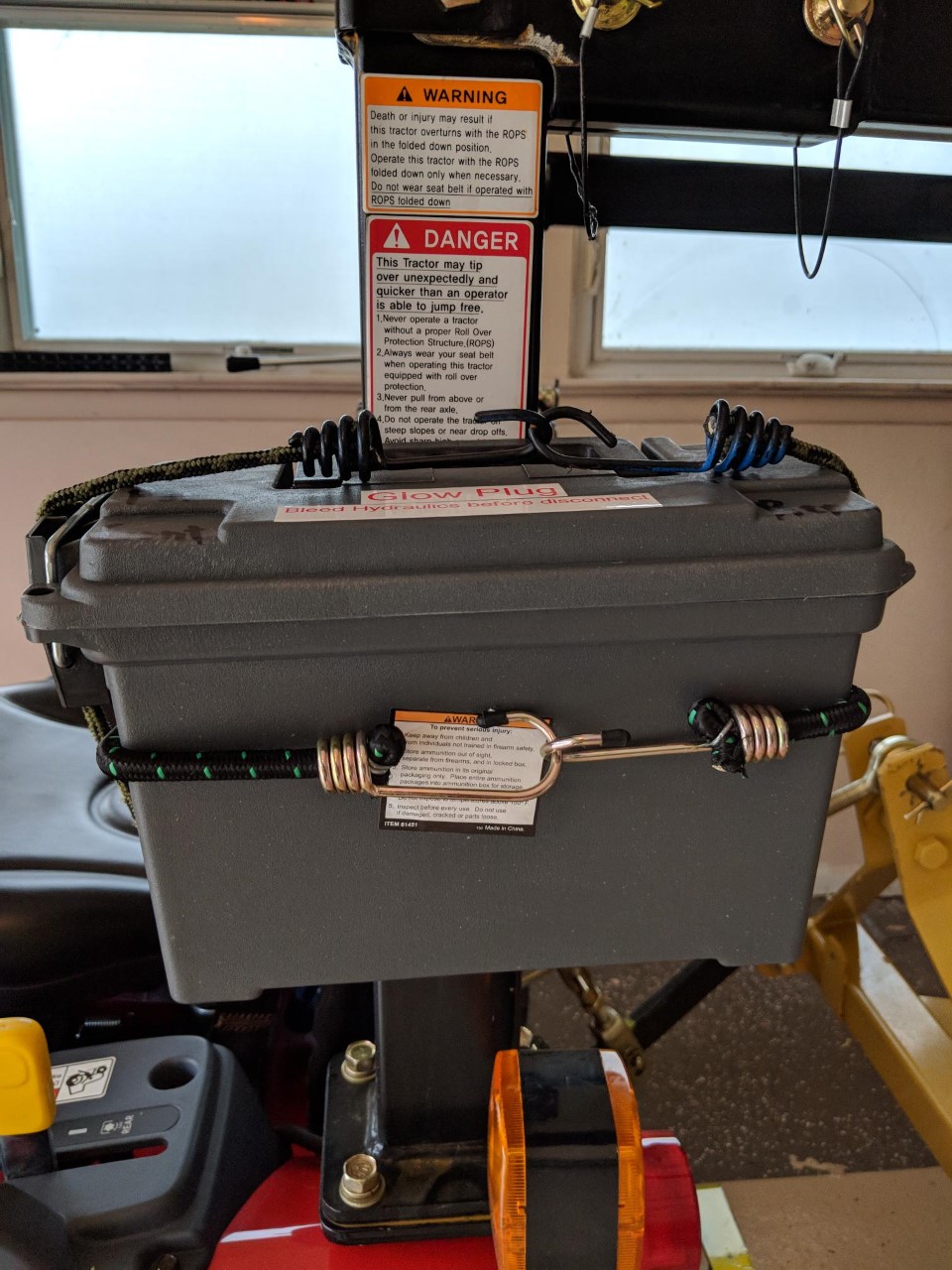

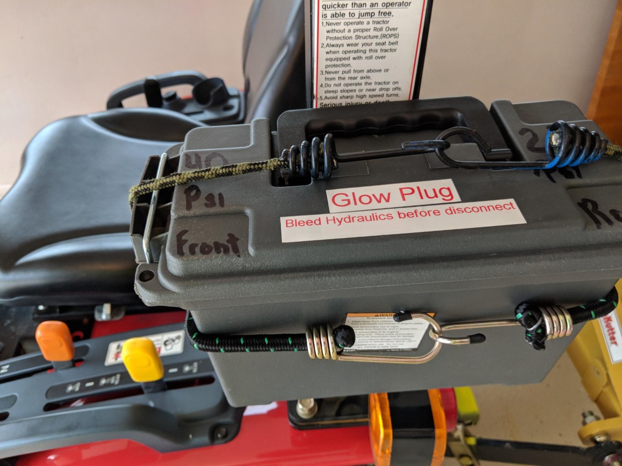

As well, I changed the small plastic box on the side so i can store more pins, bungees etc...I also put a note on box for tire pressure, as well, reminder for GLO PLUGS and to BLEED Hydraulics.....thumbnail_IMG_20181118_124052.jpgthumbnail_MVIMG_20181118_124055.jpg

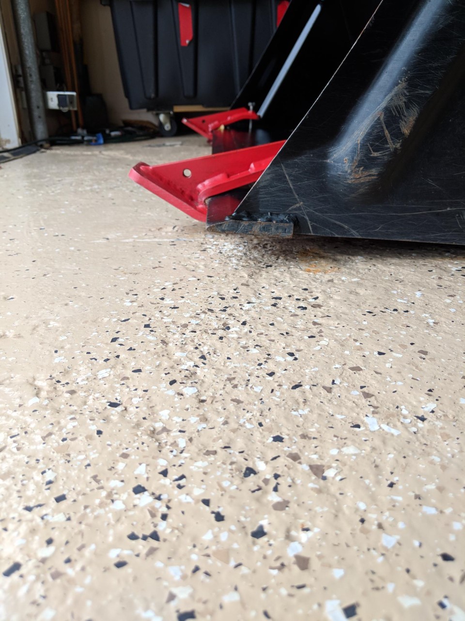

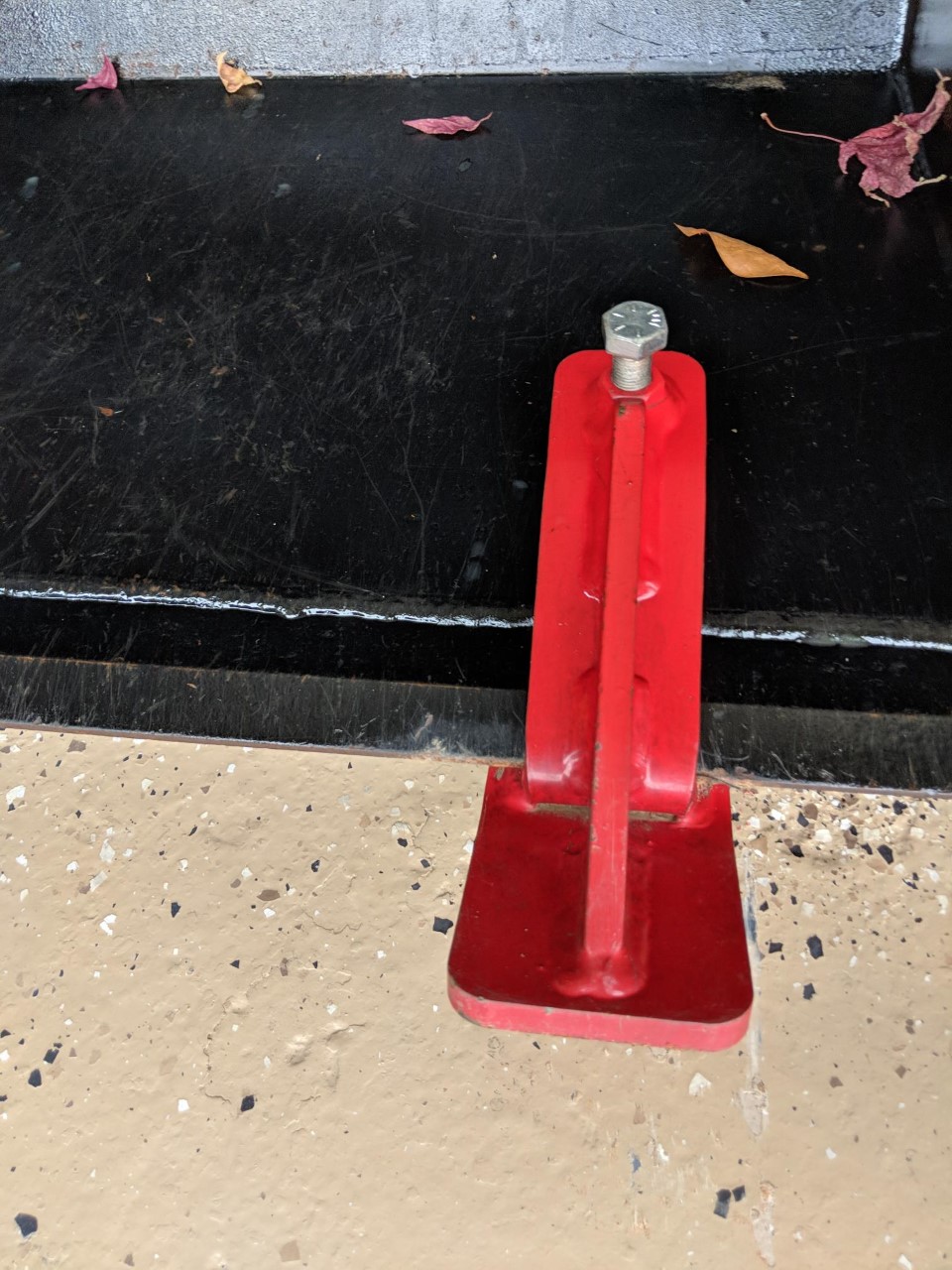

Also on Front End Loader, I got skids to use all year round...in winter I use these on my concrete drive....I have a few spots on my drive that are uneven and these keep me from chipping concrete, also, since there is no wear bar on the bucket, this saves my edgethumbnail_IMG_20181118_124038.jpgthumbnail_IMG_20181118_124043.jpg

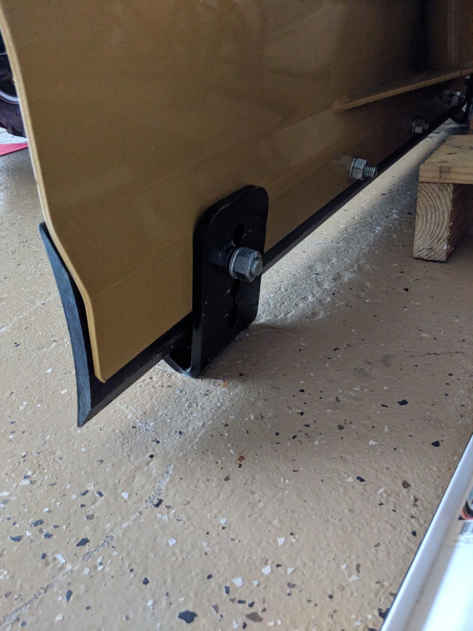

One last thing, was on my back blade, i found these skids/ shoes to help me get over the uneven concrete, they are not meant for the RK Blade, and King Kutter does not make shoes, so I got these, I know they are on backwards, I was experimenting, If I put them on the back side of blade, they need to be bent a few inches, so a buddy of mine is going to put his torch to them and heat and beat them in his vice...I still would like to get a piece of sturdy rubber to put between the cutting edge and the back blade itself to act like a squeege. someone said a stall mat, but I need to look around...if anyone has any input on what i can use....I am thinking 3/4 inch hard rubber....On my ATV I used a piece of a mining belt....thumbnail_IMG_20181118_124004.jpgthumbnail_IMG_20181118_124008.jpg

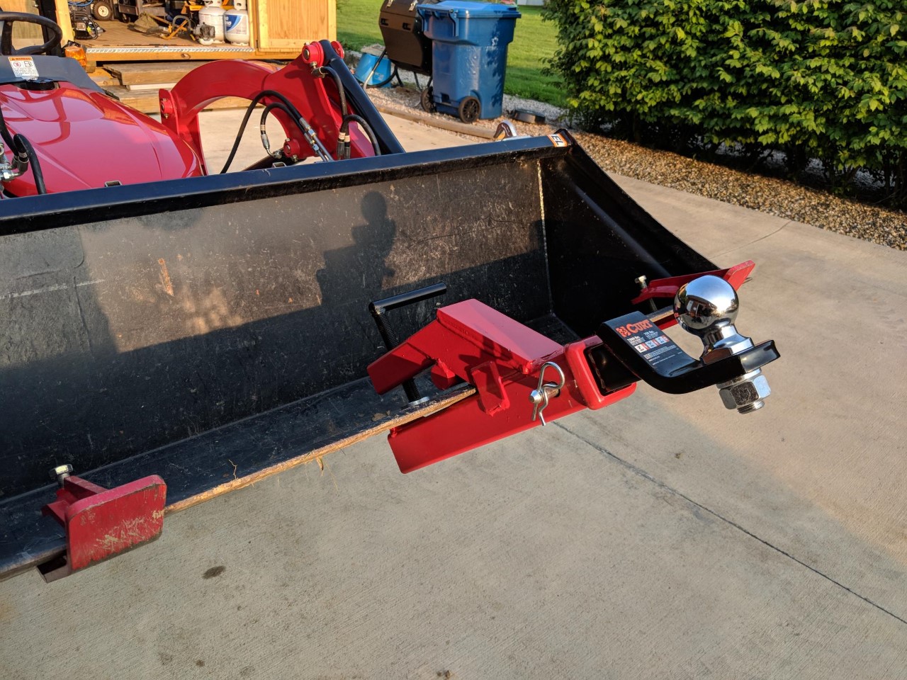

Another item was the 2 inch receiver.....I back my trailer using my truck, but where i store my trailer, i need to really caress it into a tight spot, so I use the receiver mounnted on the front end loader....after i back the trailer in, I take the receiver off....no holes drilled for either the receiver or the front end skid/shoes....thumbnail_MVIMG_20180811_194152 (1).jpg

Bone, the hooks are good too for when I strap tractor to trailer...I use the hooks as a back up...I don't use them as the primary securing point...
Are these hooks fine for pulling backwards with the bucket? Or is that damaging to the FEL?
/ RK 24 ADD ONS #11
It depends on what your "pulling". Remember that a typical FEL is designed to lift and push materials, it's not meant to be pulled away from the tractor. Sure, many do it all the time, but if your trying to get e truck out of a ditch or stump out of a hole, it's best to pull from the draw bar on the rear, that's what it's designed for.

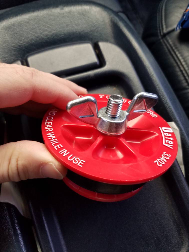

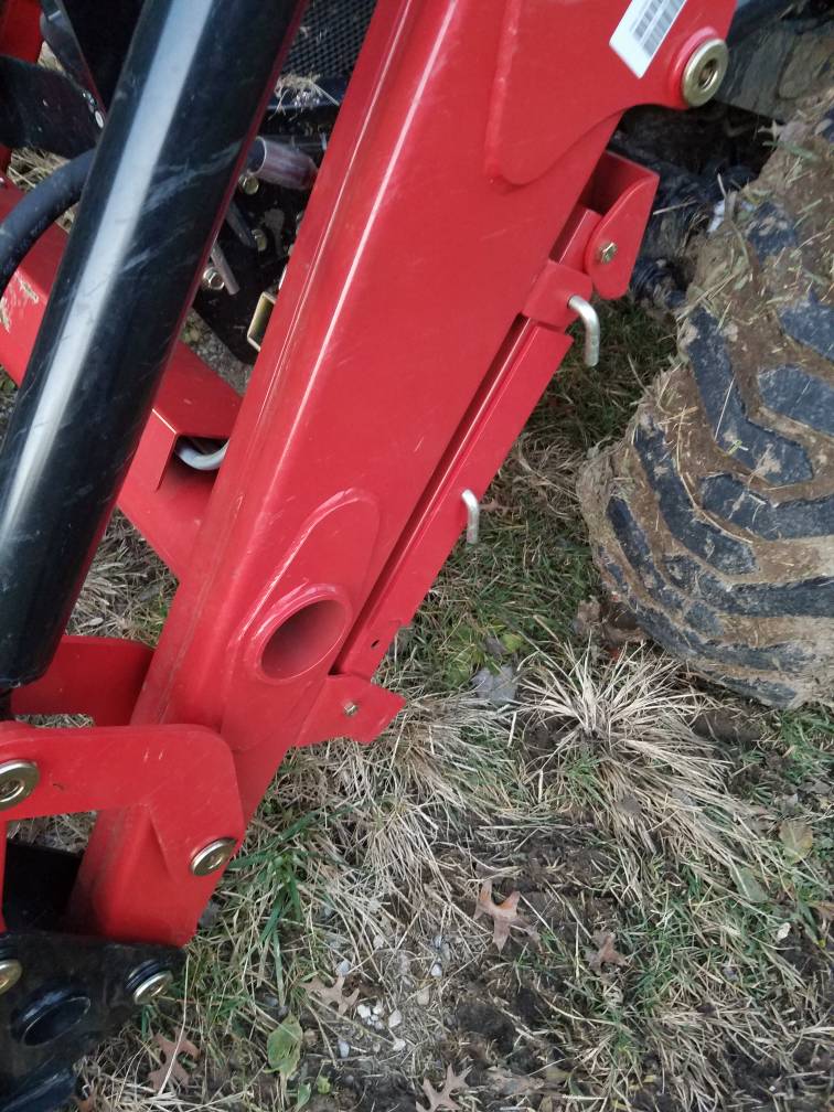

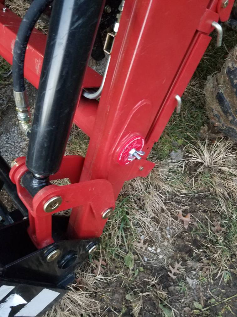

Plugs for the holes in the FEL. Keeps out debris and moisture and can be a place to store something like a chain. Lowes about $5.50 each.20181128_092100.jpeg20181128_172757.jpeg20181128_172851.jpeg

Now that is clever! Trying to think what other items could be stored in there. On colder days, maybe it could serve as an impromptu beer fridge?
Would need some sort of extractor for removal (long stick) and probably should not attempt to open your hard earned, and likely well shook, beverage inside the cab.
/ RK 24 ADD ONS #17
I've seen a thread where someone made a pull stick with a bent piece of welding wire. I was hoping to find PVC pipe that would fit without throwing away a lot of room and make it more than one compartment for multiple tools/firstaid. 2 inch pvc is too small and wasteful 3 inch pvc is too big. (3 inch is the inner diameter) The hole is 3 inch.
/ RK 24 ADD ONS #18
Electrical conduit comes in 2.47" with 2.875" outer diameter. May still be a little small on the inner dia.
