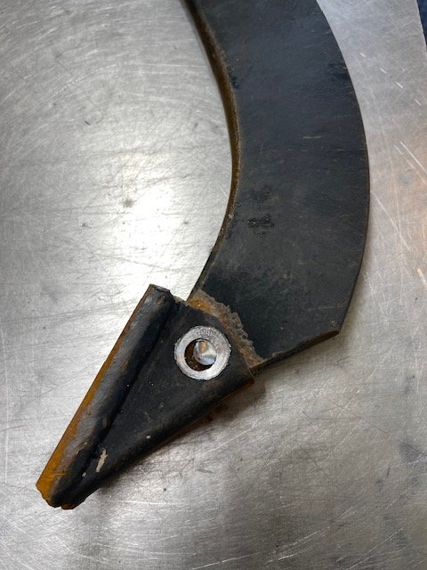

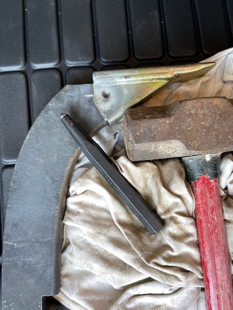

   / Ripper teeth
I went the drill route for removal. The dimple was smaller than the bit I used on purpose.
Once I drilled most of each side out I simply held the sock with the tooth hanging down and pinged it with a hammer a few times and it popped of. Then I used a 3/8 punch and hammer - but used a press on the other side after carefully marking the dimples on the tooth. It went okay. I would do it again, in fact I bought extras.

   / Ripper teeth #8
I think the punch divot is to sharp and to deep. But it is good enough for home owners use, especially since you don't have a torch. Good going! (y)
   / Ripper teeth #9
We used a 5 lb hammer on one side and a ball peen hammer
on the other

   / Ripper teeth
Agreed. On the other side we used a press with the same punch and got a better looking dimple.
