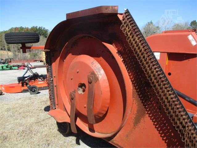

I'm not ready to buy a batwing yet, but I enjoy looking at what's out there. One of the things that I don't understand is the ring that goes around the stump jumper. What does it do?

I would venture that it is to help with lift under the deck for finer material ?
Frank
Yeah I’d guess the same
Helps create a suction or vacuum to lift the grass or brush up into the blades for a better cut?

When Bush Hog introduced the feature it was touted as protection for the deck.
you don’t see mower deck baffles to the center (inside) of the blade cutting edges.

/ Ring under a Batwing Mower #9
Keeps the blades from damaging the deck.
Yup, we had a couple of 20' batwing mowers we used for roadside and median clearing we pull behind a NH TV145. Couple years after purchase the decks were beat to death and I mean beat so much so that we scrapped one. Next one we bought had the rings under and it made a whole lot of difference to the amount of damage......Mike
Thank you. I was looking on youtube last night and Rhino said that the "Deck Ring" was an option to protect the deck.

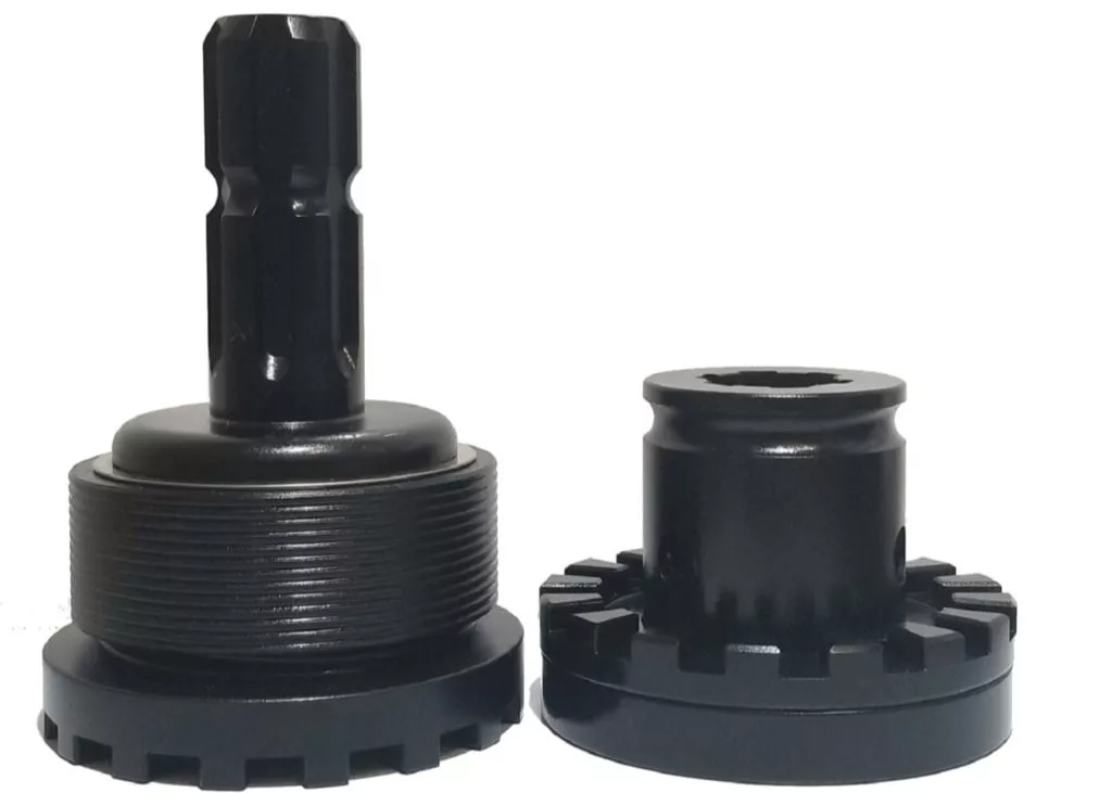

/ Ring under a Batwing Mower #15
"a wuss" ...... or just a lot smarter than the rest of us.
/ Ring under a Batwing Mower #18
I've looked at a couple different variations of that; is it fail safe?
It appears to be. It has a plastic keeper you snap in place that keeps it from accidentally opening if that's what you would call "fail safe". It is very well made and it's been a life saver for me. I'm using my batwing again.
/ Ring under a Batwing Mower #19
You may get flamed for buying this. It seems that anyone trying a new product to improve the pto hook up process is a wuss. :) :)
Yeah, old age tends to make a person a wuss I guess. The true wusses are what made manufactures add so darn many safety coverings to begin with. This just gets around the dang things. The thing I like most is being able to VERY EASILY rotate the thing just a little to be able to hook it up. No fighting the splines or needing 3 hands.
