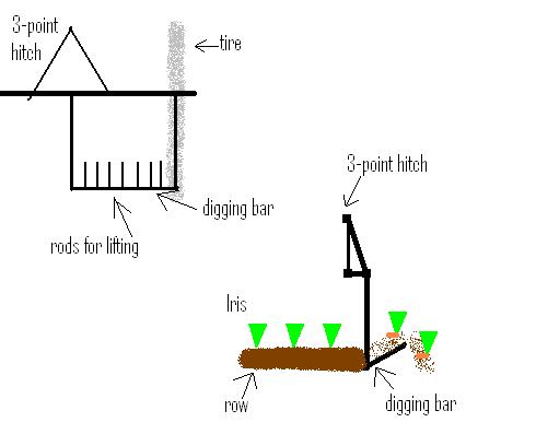

As for lifting the rhizomes I made a simple digger. All it is is some sort of digging bar I found down at our yard. I mounted it at about a 30 degree angle and welded some half inch steel rods to the back to lift the iris up then drop them and break the dirt off. Heres a simple diagram I made in paint real quick...Its a lot easier to show then tell. lol
I'm working on one now that instead of dropping the iris back on the ground it drops it onto a conveyor and brings it up to a bin. Kinda like an onion harvester. That way we don't have to pay a crew to go through and pick them up in the field.
