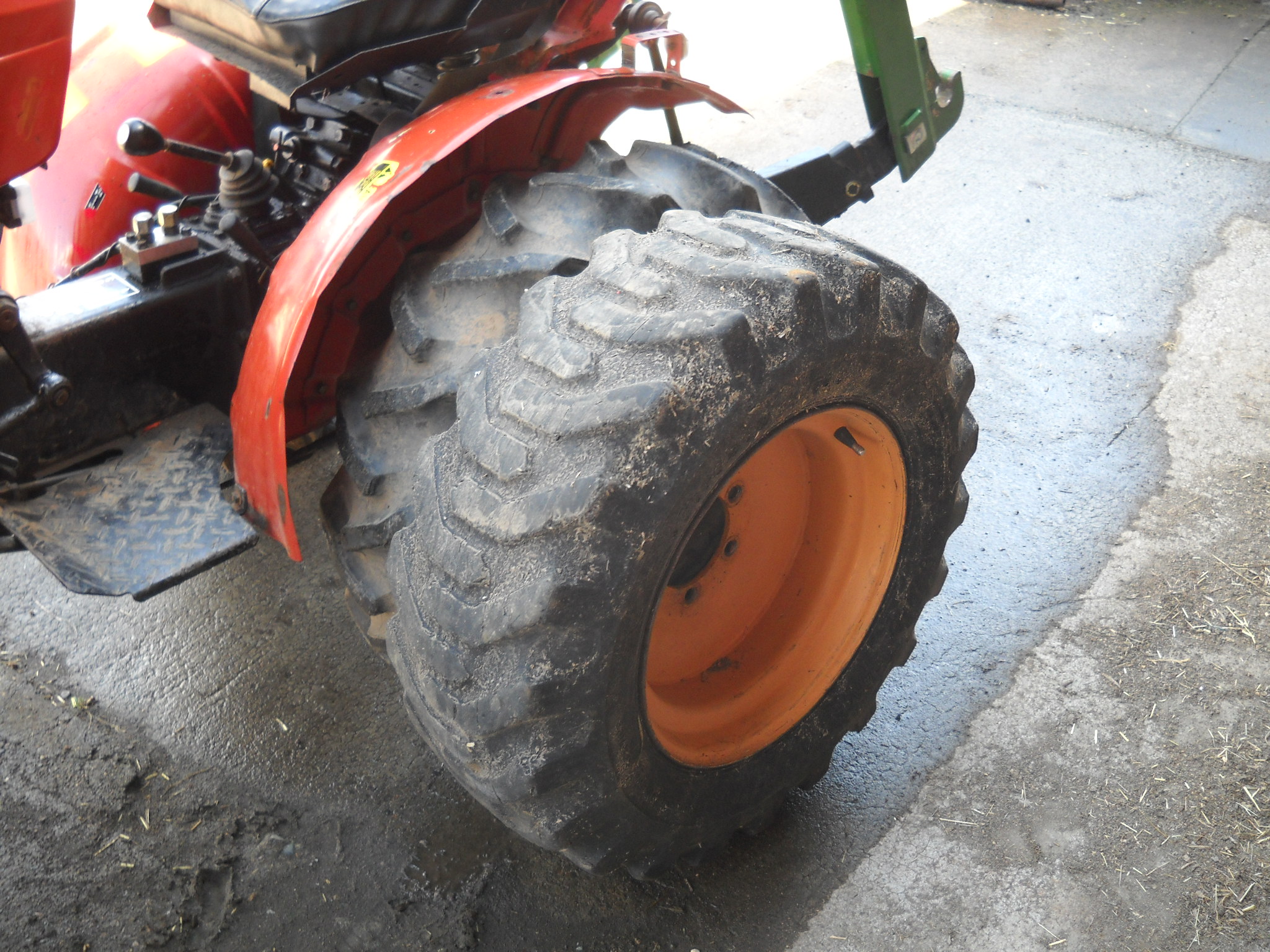

If you want better surface contact have you thought of some R4s? I have R1s om my Yanmar and even with those I wish they had better surface contact. You can see I almost got a set of R4s for my tractor but they were 1" to small and wouldnt work with the 4wd. :(
