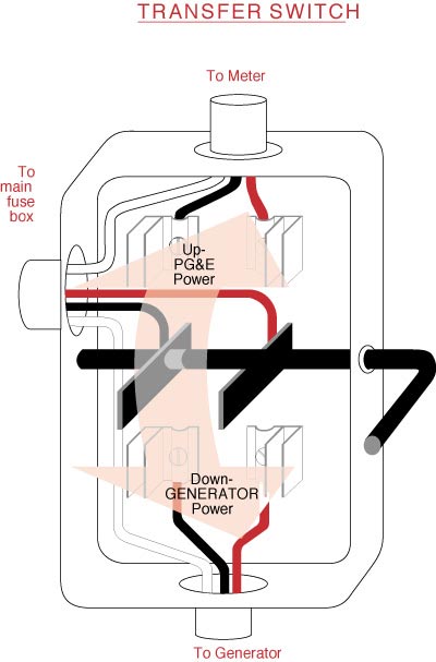

Hi Franz,
<font color=blue>2) Manual Transferr Switch- This is basicly a 100 amp 3 pole double throw switch, much like a disconnect switch. It is installed between the meter and the breaker pannel. When the power fails, you start your genset, and then throw the switch from power Co (up) to Genset (down), and the breakers have power.
Wholesale for a 100 amp transferr switch is about $500.oo.</font color=blue>
On re-reading your reply today, now that I have more time, I just realized that you seem here to be describing exactly what it is I want.. what I was struggling to explain! All I missed was that it has to go after the meter and before the main box.
With a 200 amp service, I presume it will be a bit more expensive.. but this sounds like the way I'd like to go.

   / Revisiting the PTO-generator question #80
Trev, I have attached an image of the manual transfer switch that you have been trying to describe. This switch is a double pole, double throw (I think). The only problem that I have with this kind of switch is that it does not switch the neutral. I am sure that this kind of switch would meet code and pass inspection but I worry about the neutal (white wire in the image) not being switched. Luckily I have a buddy who worked for Square D so I got a 400 amp triple pole, double throw switch from him. The triple pole will allow me to switch the neutral as well. I only asked for a 200 amp switch but a 400 amp is what I ended up with. I only have a 7500 watt rated, 10000 watt surge portable generator so a 100 watt or even 60 watt switch would have been enough. I wanted at least a 200 watt in case I upgraded generators in the future. I knew we were moving from our last house so I did not bother to hook it up there. I've been in our new house for a little over a year but still have not hooked it up here yet.
You can get a , <A target="_blank" HREF=http://www.harborfreight.com/cpi/ctaf/Displayitem.taf?itemnumber=42162>100 amp, or <A target="_blank" HREF=http://www.harborfreight.com/cpi/ctaf/Displayitem.taf?itemnumber=42163>200 amp</A> Cutler Hammer double pole, double throw transfer switch from Harbor Freight for 179.99, 199.99, or 299.99 respectively. You would want to get the largest one you could but I put the other links in there for everybody else. The link to the 60 amp switch is the only one that shows a picture of the switch.
