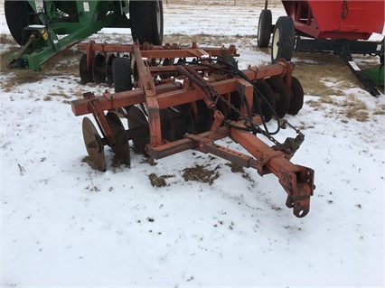

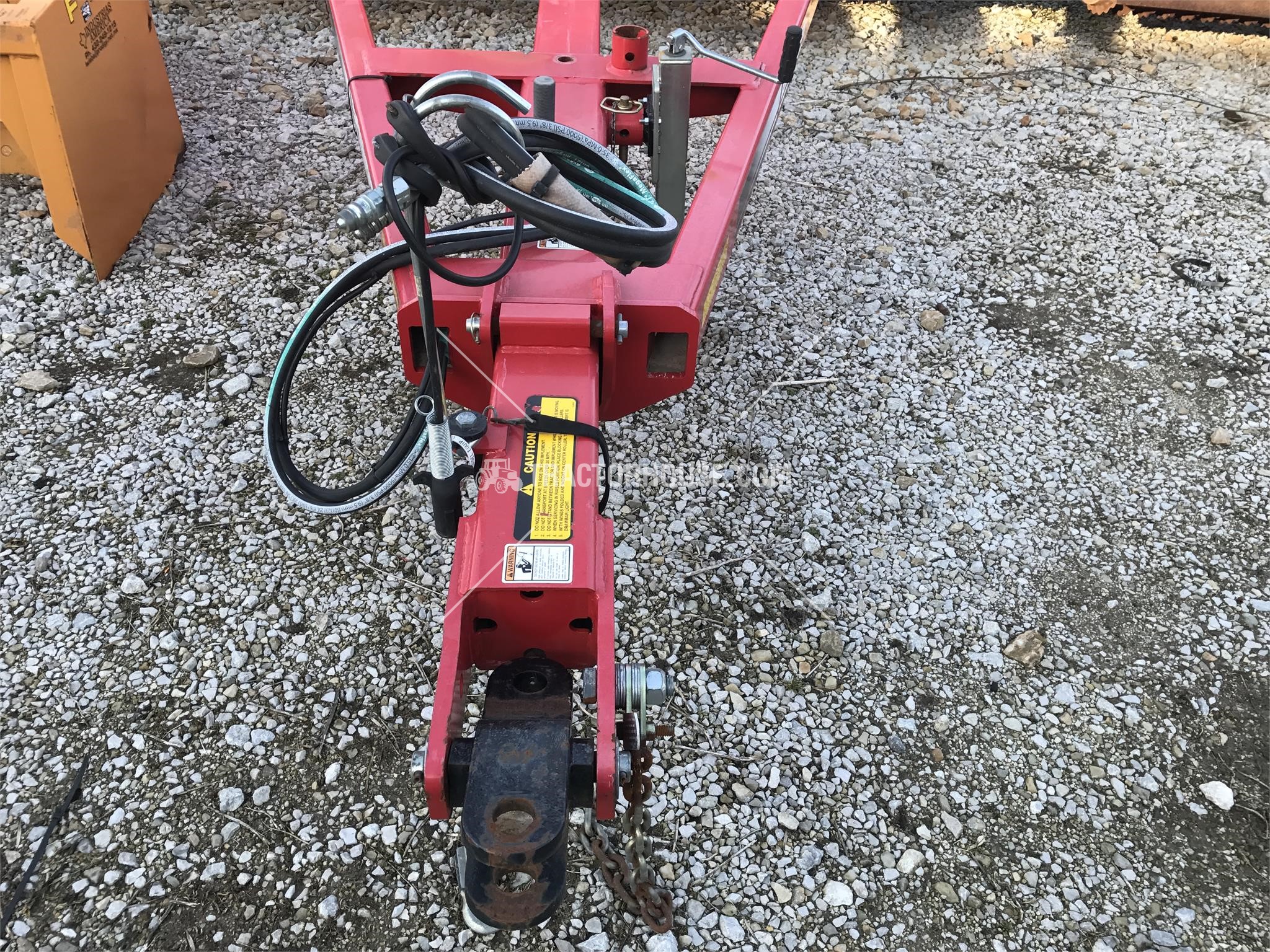

My scraper as well as disc and do-all have this type of tongue:
It's odd to me that your ground engaging implements have a fixed tongue.

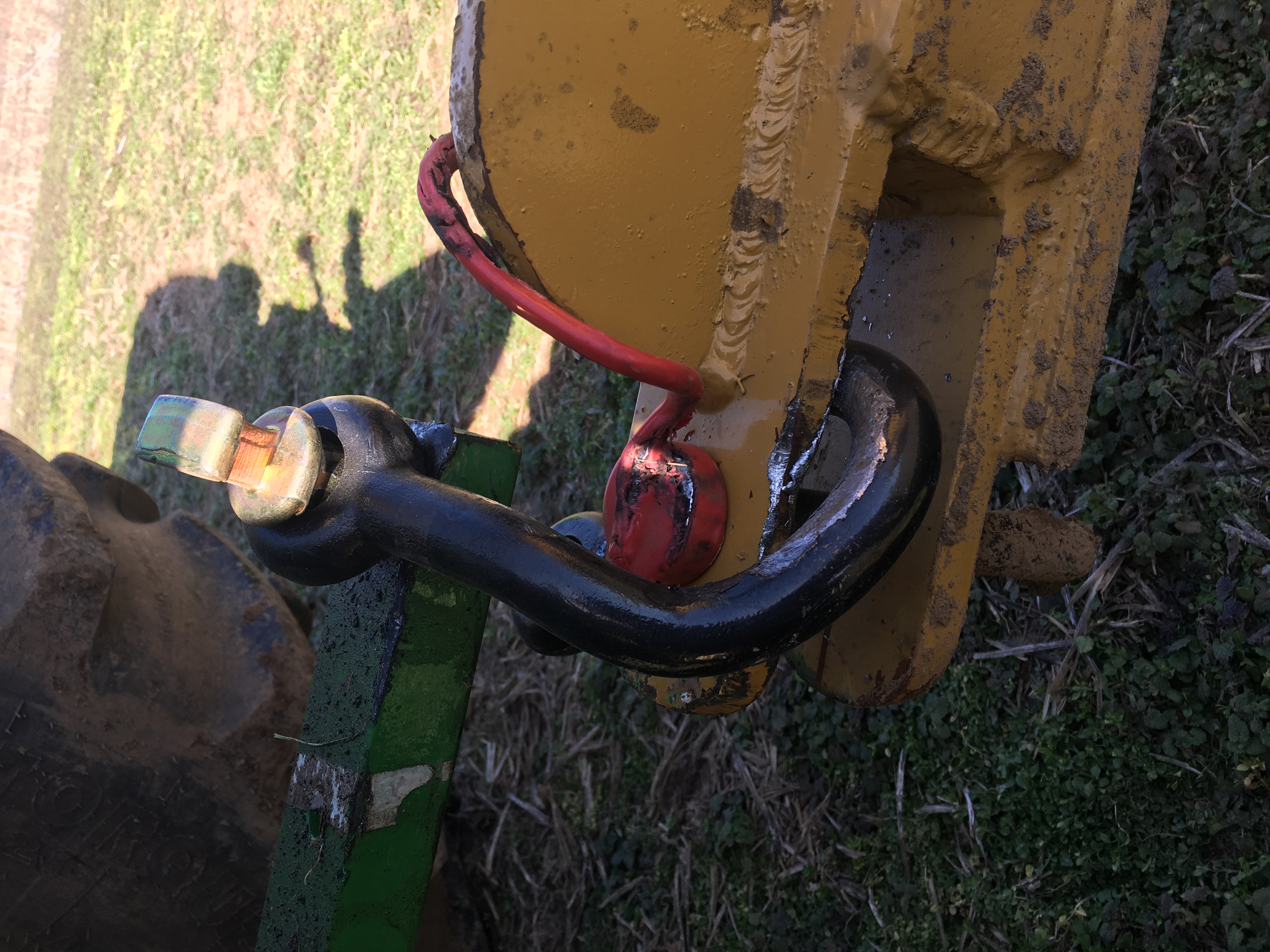

Well... the 1" twisted Clevis didn't work out. About 3 hours of use, and it beat the **** out of the connector, pin, and actually bent the clevis. It is now very hard to get the pin into the clevis as the holes are no longer directly in alignment.
I have to do something because I know that I'll break the towbar or implement if I don't. But short of hauling them to a welder or having one come out, I have no options. I have to get both a towbar adapter, like a hammer strap, and have the implements altered as well.
Or just have the implements altered similar to yours, Todd.

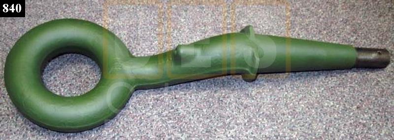

This, connected to the tractor drawbar,,,
it has to be able to rotate.
It is the pintle hitch part normally used on a trailer.

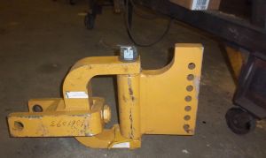

A slip on section with a rotating hitch should not be too hard to weld up. All held in place by a pin through the drawbar hole so it is easily removed.
A hammer strap hitch does not meet your rotating requirements.
Check out Caterpillar pull scrapper hitches. This type will work for you well. Easy to fabricate a removable one for your drawbar.
You could check with Cat to find out if they work!
