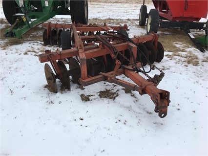

My scraper as well as disc and do-all have this type of tongue:
It's odd to me that your ground engaging implements have a fixed tongue.

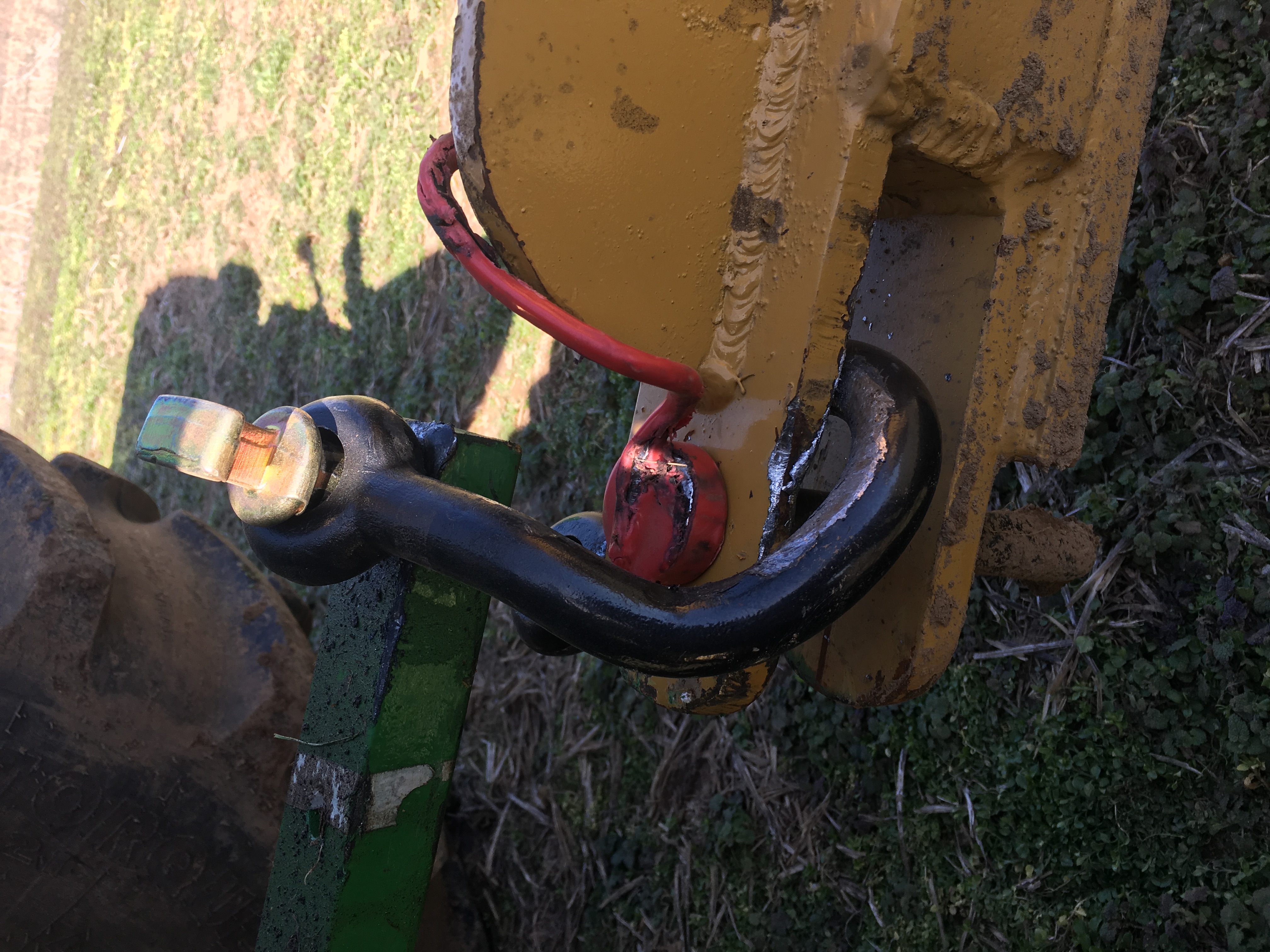

Well... the 1" twisted Clevis didn't work out. About 3 hours of use, and it beat the **** out of the connector, pin, and actually bent the clevis. It is now very hard to get the pin into the clevis as the holes are no longer directly in alignment.
I have to do something because I know that I'll break the towbar or implement if I don't. But short of hauling them to a welder or having one come out, I have no options. I have to get both a towbar adapter, like a hammer strap, and have the implements altered as well.

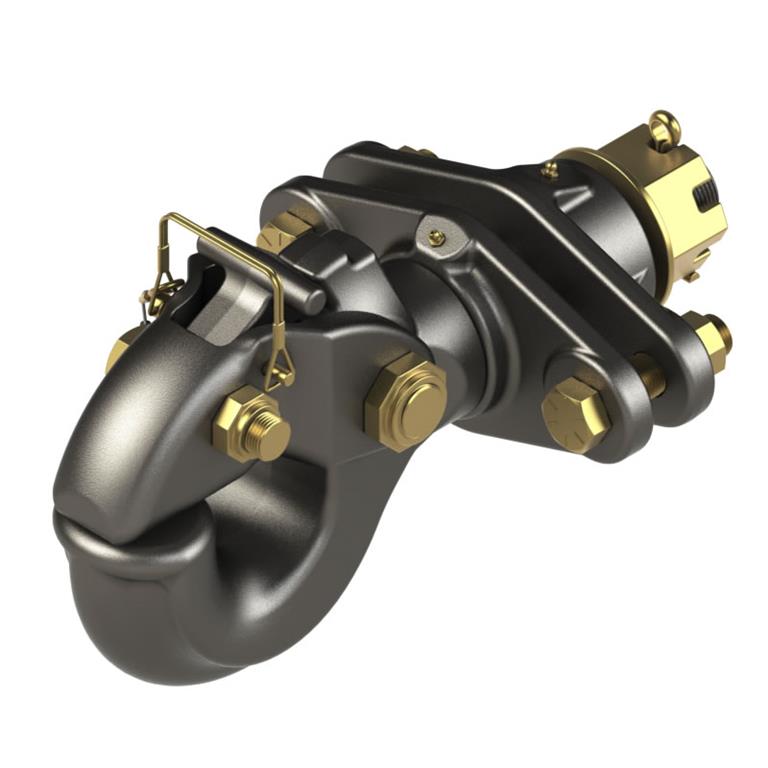

This, connected to the tractor drawbar,,,
it has to be able to rotate.
It is the pintle hitch part normally used on a trailer.

A slip on section with a rotating hitch should not be too hard to weld up. All held in place by a pin through the drawbar hole so it is easily removed.
A hammer strap hitch does not meet your rotating requirements.
Check out Caterpillar pull scrapper hitches. This type will work for you well. Easy to fabricate a removable one for your drawbar.
Or just have the implements altered similar to yours, Todd.
Sorry that didn't work out. Something definitely looks wrong with that clevis. Almost like it doesn't have enough twist in it (anymore).

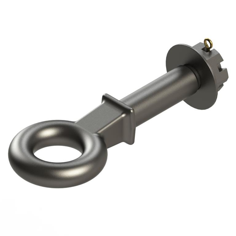

I don't have a pic of my scraper hitch. I can get one tomorrow. It is rigid, doesn't rotate. But honestly, I've not saw a need for it to rotate. The ring allows side to side rotation. Also, understand, my scraper has dolly wheels so I don't have any "weight" on the hitch. Not sure that would matter in regards to rotation though.

How is the best way to 'size' a lunette ring in relation to the size of the hammer strap pin?
Basically, how much 'play' is optimal? I've seen rings from 2" inside diameter to 3". This is a pretty big variance.
/ "Reverse clevis hitch"? Anyone ever tried? #39
I'll try to remember to measure mine. It is actually too big for my uses, and the uses of the previous owner. He welded some plate in the rearward half of the circle to make it smaller. This took a lot of slop out of it. I'll get some pics today.

I built my Hammer Strap. Uses an 1 1/4" pin.
The pics of the lunette are on my scraper. As I mentioned earlier, previous owner closed up the hole to prevent slop. Originally it was a 3" diameter loop.
