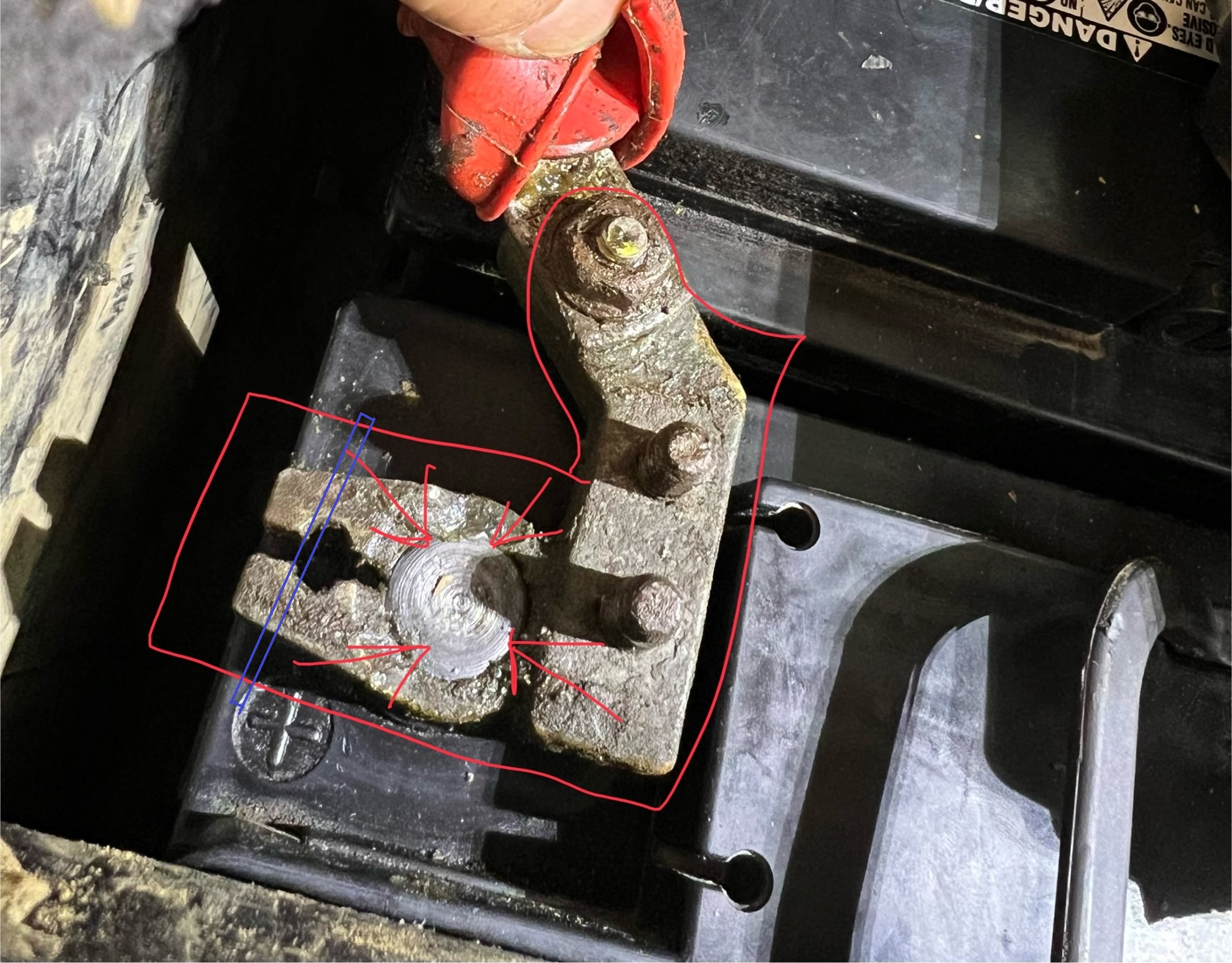

I was more concerned that the clamp on the battery post is unable to be secured
Maybe do a voltage drop test from that post to the other end of that cable. A bad connection could definitely cause your symptoms.

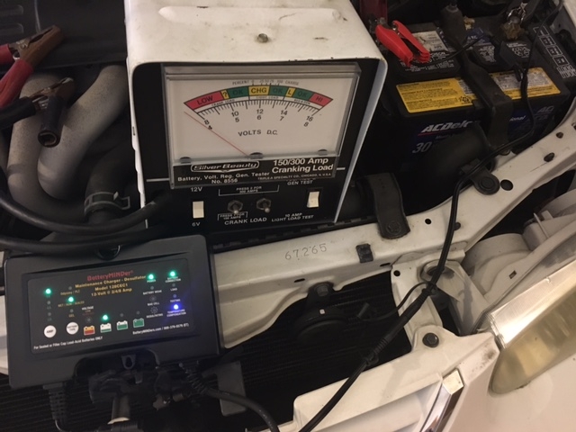

If my tractor is showing 13.4+ on voltmeter and I have no trouble light on as stated, why would it be alternator?
Voltage is not all you need. You gota have amperage too. I have seen alternators produce 14.0 volts but only 2 or 3 amps. THAT will not charge a battery ! You need to check them both. Also test a battery with the same load as your starter draws . If your starter draws 200 amps while cranking then that's the load you put on the battery. The ONLY true check is to make it do what's its supposed to do not some electronic bull crop meter.
NO hole through clamp for bolt?..... Drill a hole and add bolt...

And just leave a vice grip on the battery lug permanently?
I was thinking of replacing the lug
That was said very "tongue in cheek" because I know you are fussier than that. I do a lot of fixing for farmers and I have seen many lets say interesting repairs.
