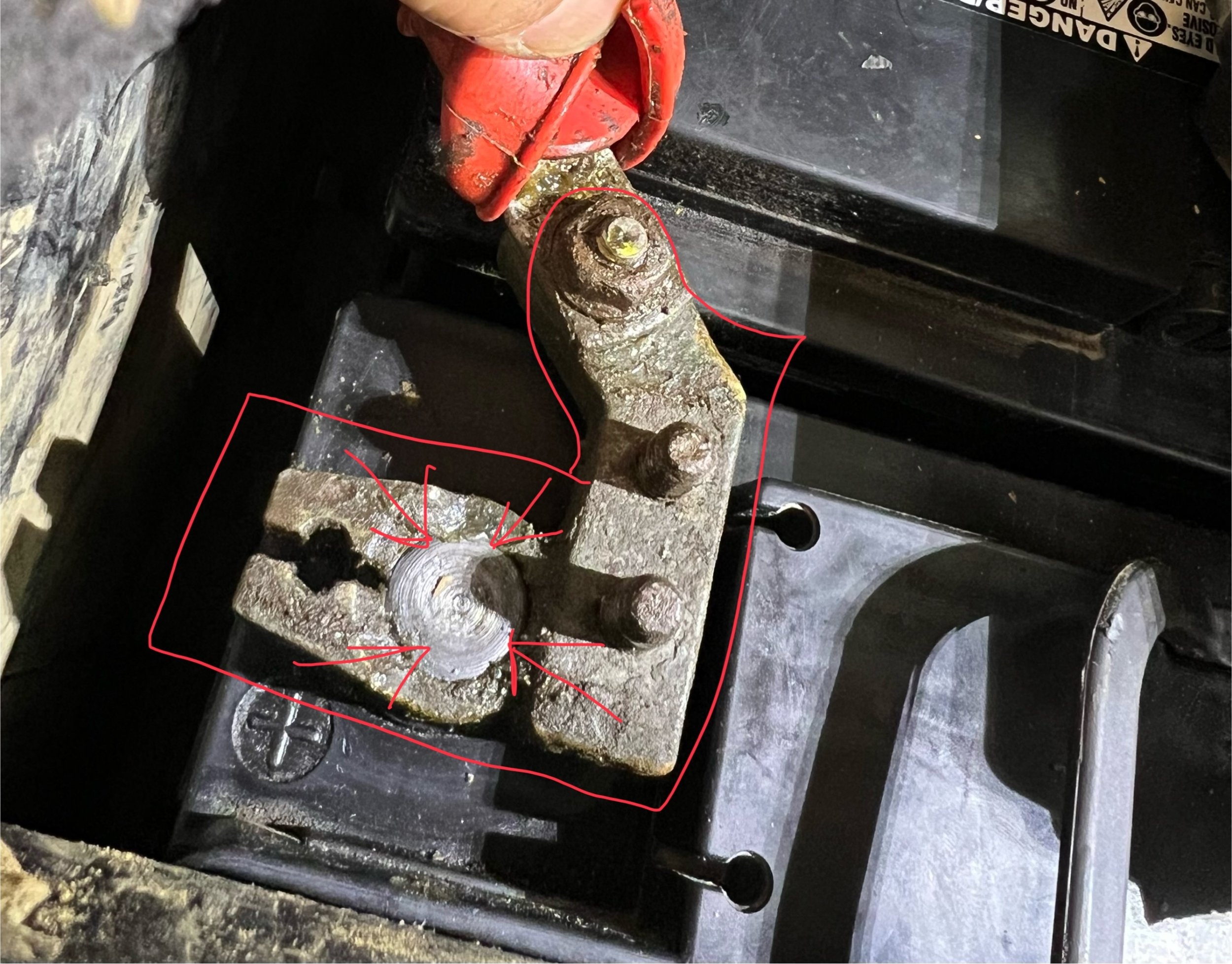

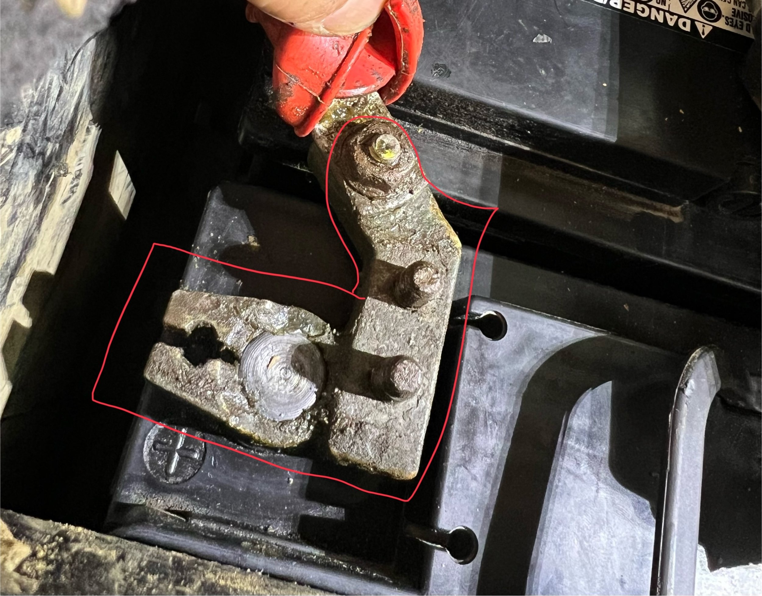

Just now remembered one thing that might be causing a problem. This compound battery terminal lug isn’t able to be tightened to my satisfaction. It’s not loose, but it’s not tight, either.
Again, I’ve spent maybe an hour with this tractor figuring things out. Picked up on this when messing with the batteries last time and forgot to mention it.
Of course that has nothing to do with batteries that may be no good, but if one terminal isn’t making proper contact, it’s not helping.

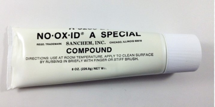

That may not be the problem, BUT, BUT, BUT, that is certainly not good, it may be big contributor to your problems....All the gunk and corrosion need to be cleaned to bright and shiny surface, treated with a soda solution to neutralize any acidic condition and the all exposed surfaces and busses and studs need to be treated with a anti corrosion compound.... All bolts, nuts and such secure..... I use a product called NO-OX-ID to treat all my battery and ground connections, I don't have any corrosion problems, only some ugliness from dust and dirt collecting on grease.... One tube of this will probably last you a life time and help on all the batteries you will ever use....

I was more concerned that the clamp on the battery post is unable to be secured
