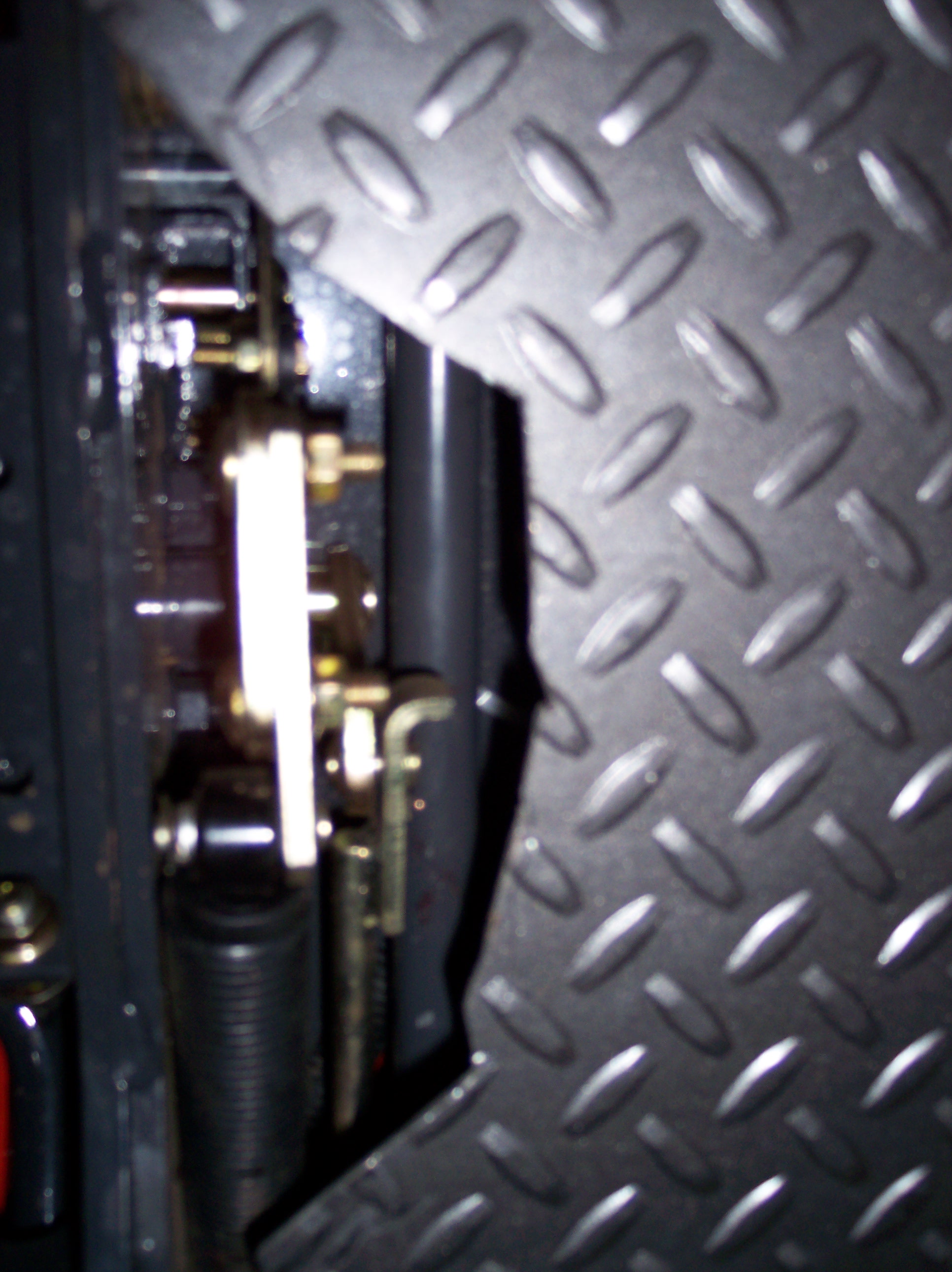

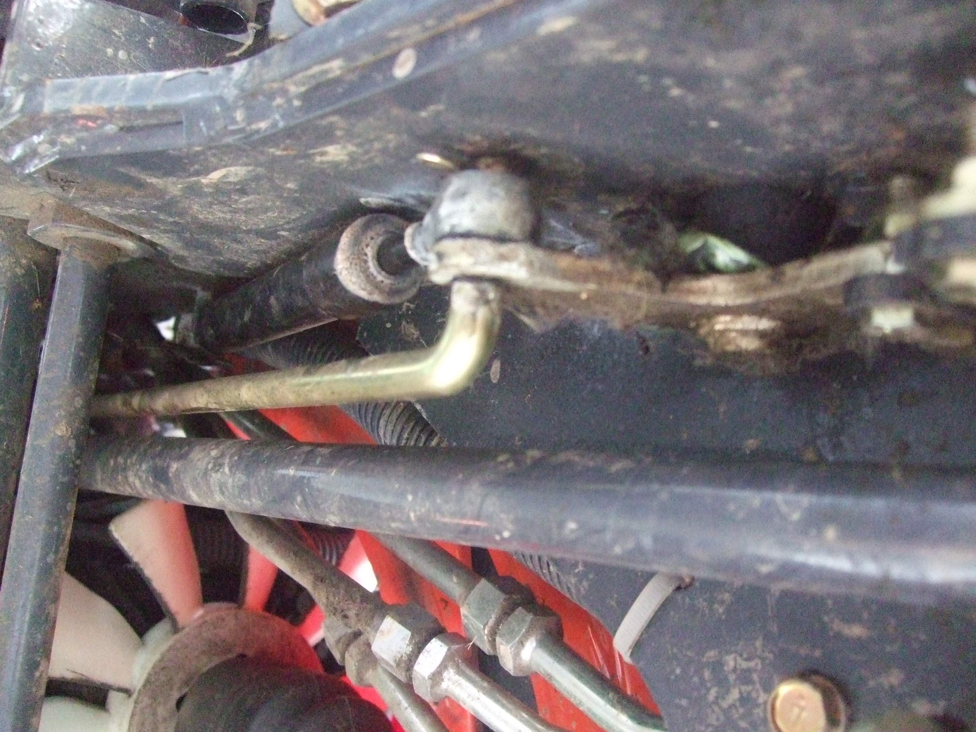

Regarding the abrupt stop, has anyone investigated putting a damper cylinder in parallel with the pedal assembly? I've noticed there is already one on mine (on the underside) but I've never taken it off to see which direction of travel it dampens. Obviously it is not in the CORRECT direction to help this situation.
/ Retrofit for BX-24 #6
yup - i messed around with the dampener. i even had a thread about it. I had it off-- scary . there was no gas pedal push feeling. I reversed the dampener, I think it feels different. I even tighten the jam nut for faster return and i have to have my foot on it all the time now. From what i understand is that the hst tranny has dynamic braking built in. The BX25 just makes it more fliud and less abrupt. I assume that if you bought the BX25 tranny and swap it out, it would resolve the aburpt issue.

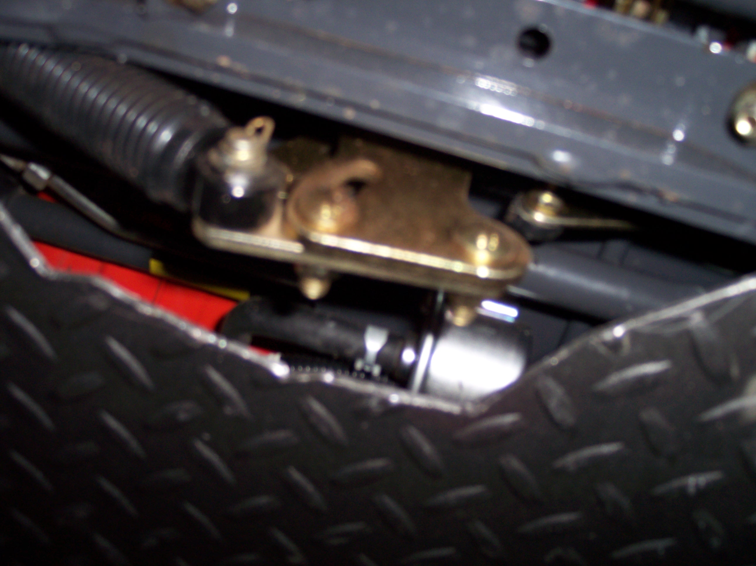

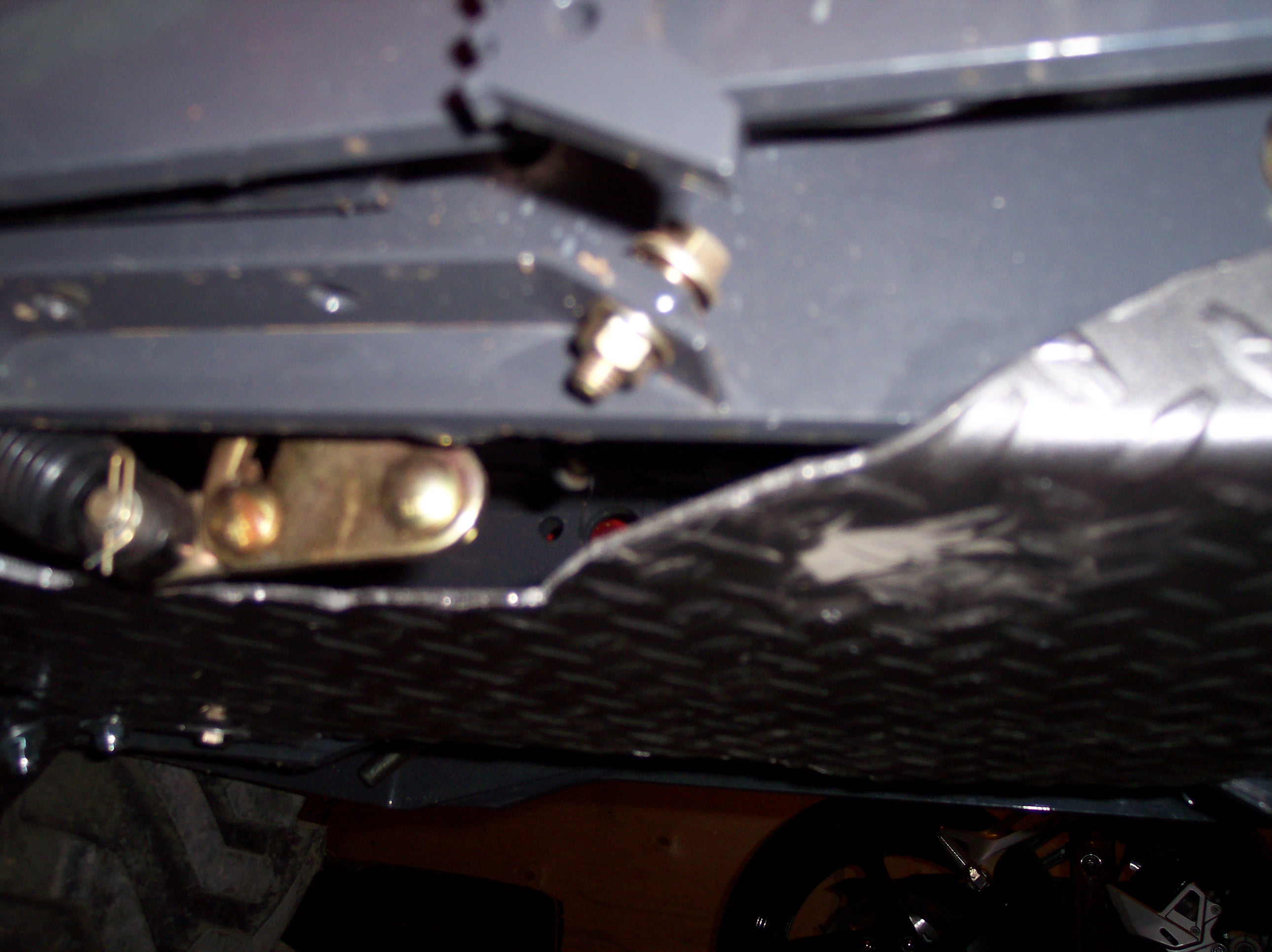

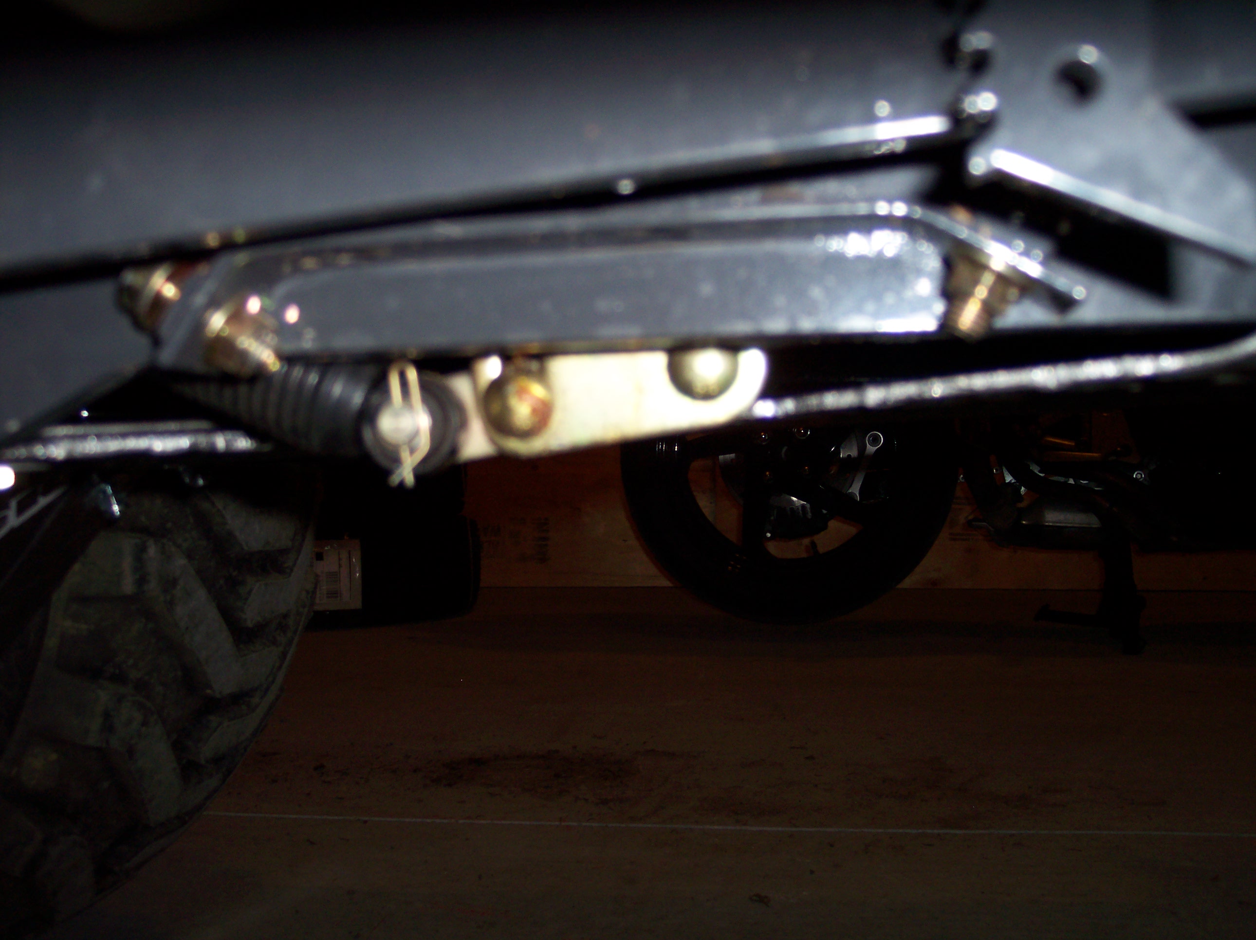

Guys,
I have a BX25 and it would appear that it could be just a change in the pedal linkage. I bought both the rear and front skidplate from Bro-Tek and the front plate would not fit properly as the linkage is lower than the BX24 linkage. I had to cut the plate so that it would fit.
It most likely is more complicated than just the linkage but you never know.
Here are some pictures of the plate with the linkage.

hmm -- your dampener looks different then BX24's. here a pic of mine to compare.
