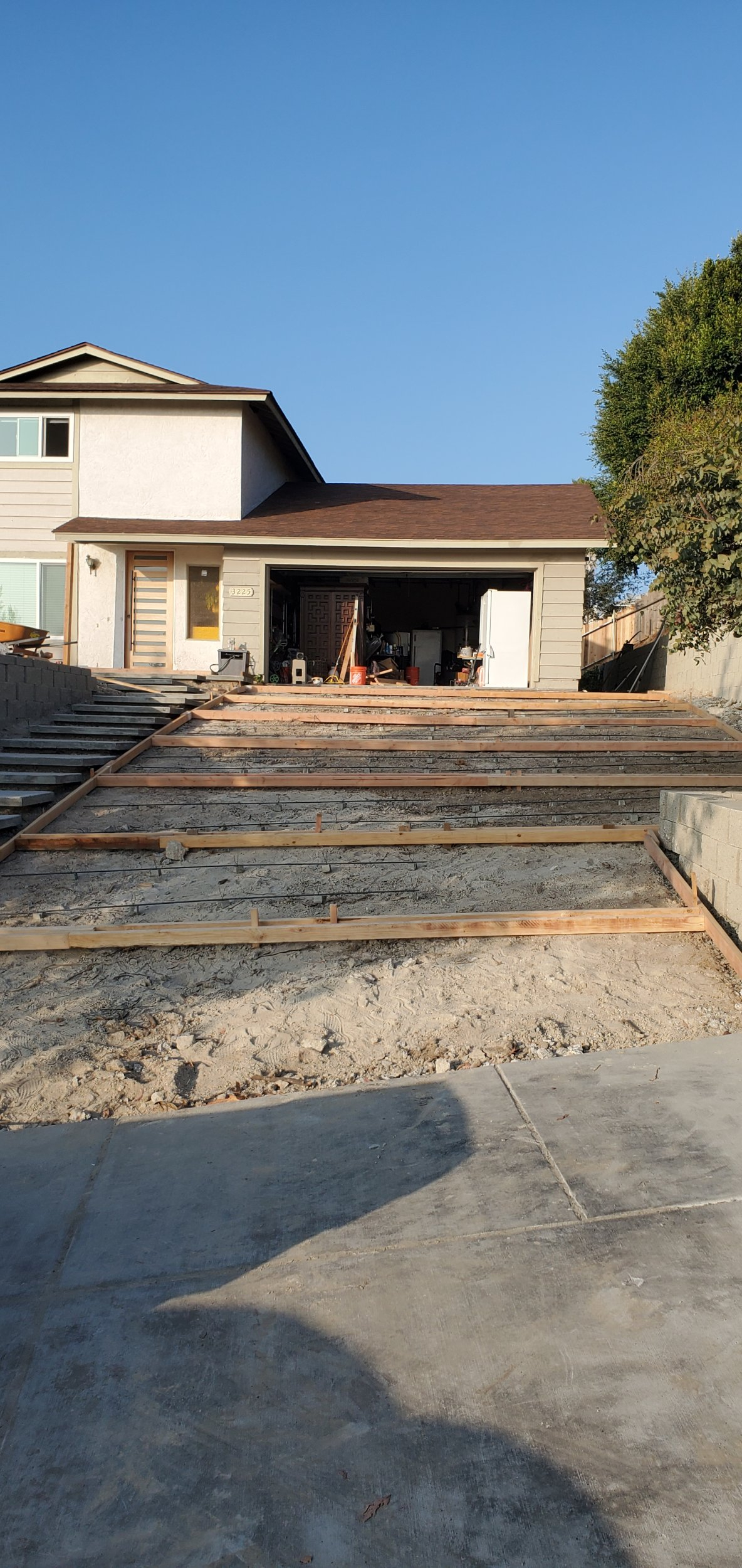

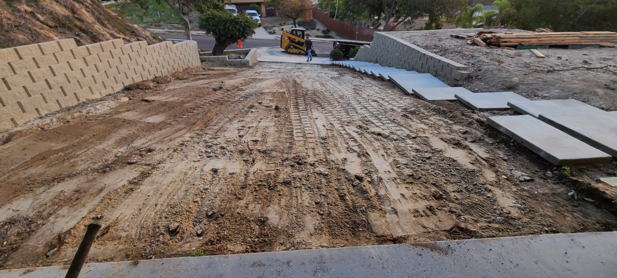

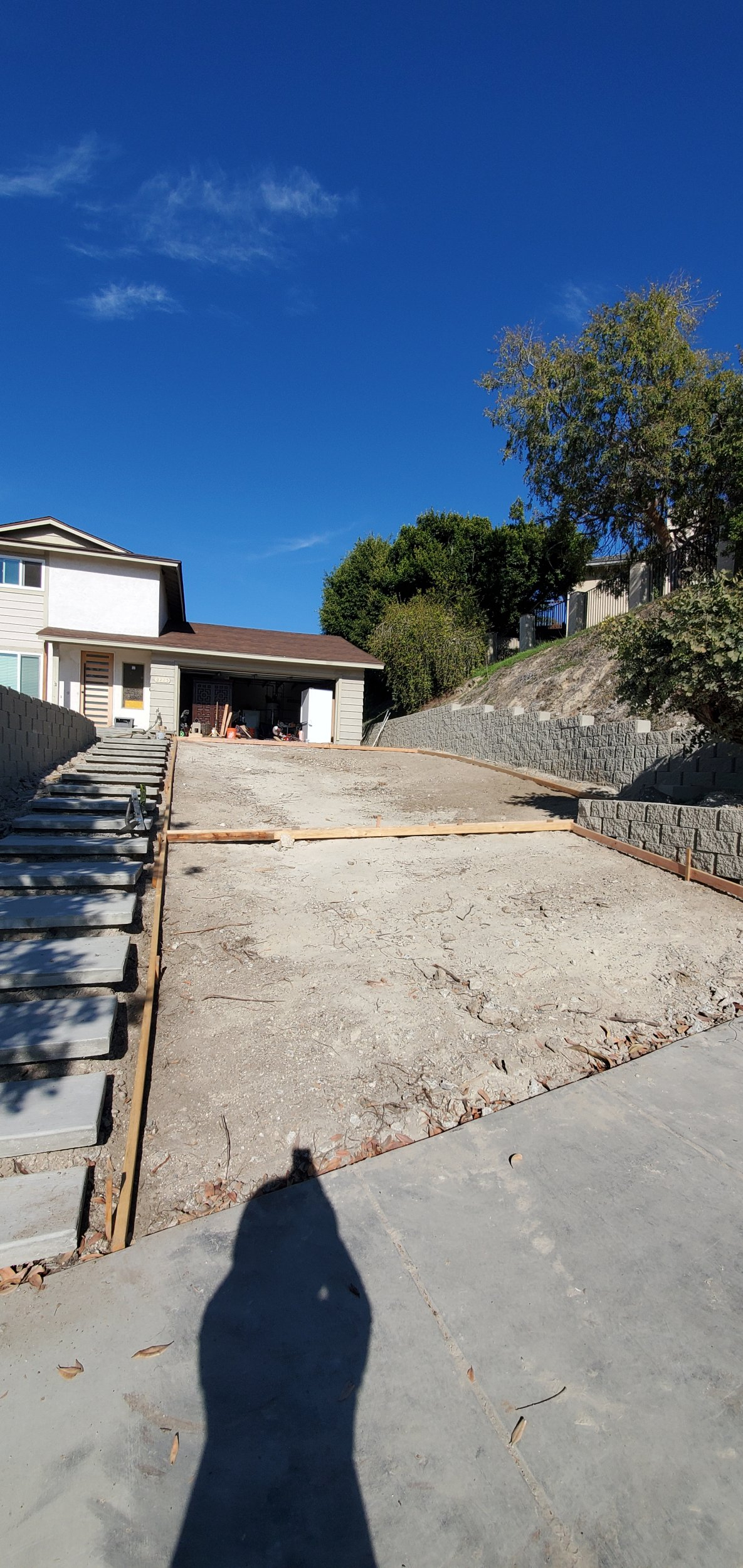

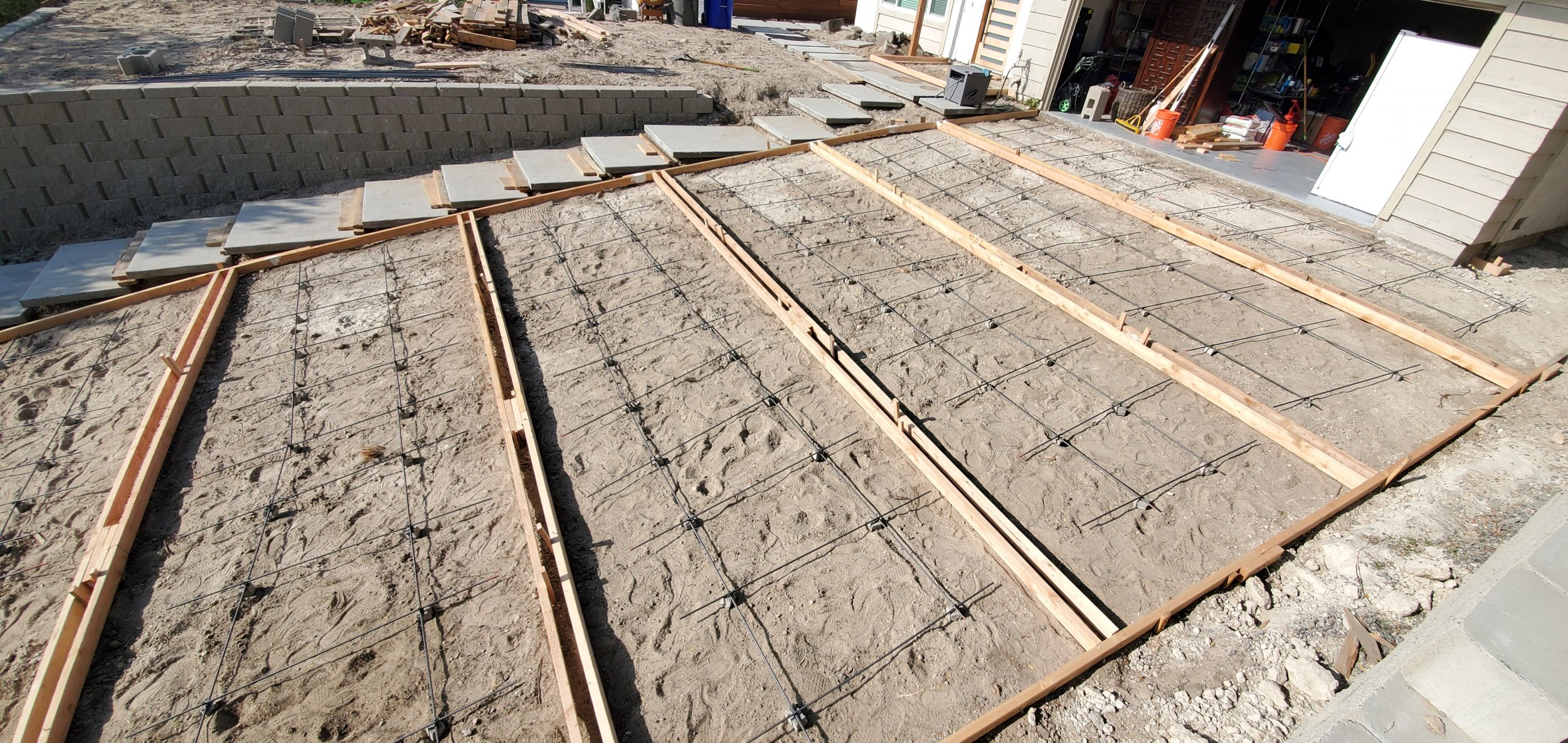

The unnecessary driveway is ready to pour.

   / Retaining walls and patio #278
Nice! Great think about SD is you can pour concrete all year long! We stop in Dec and dont start again until late May!

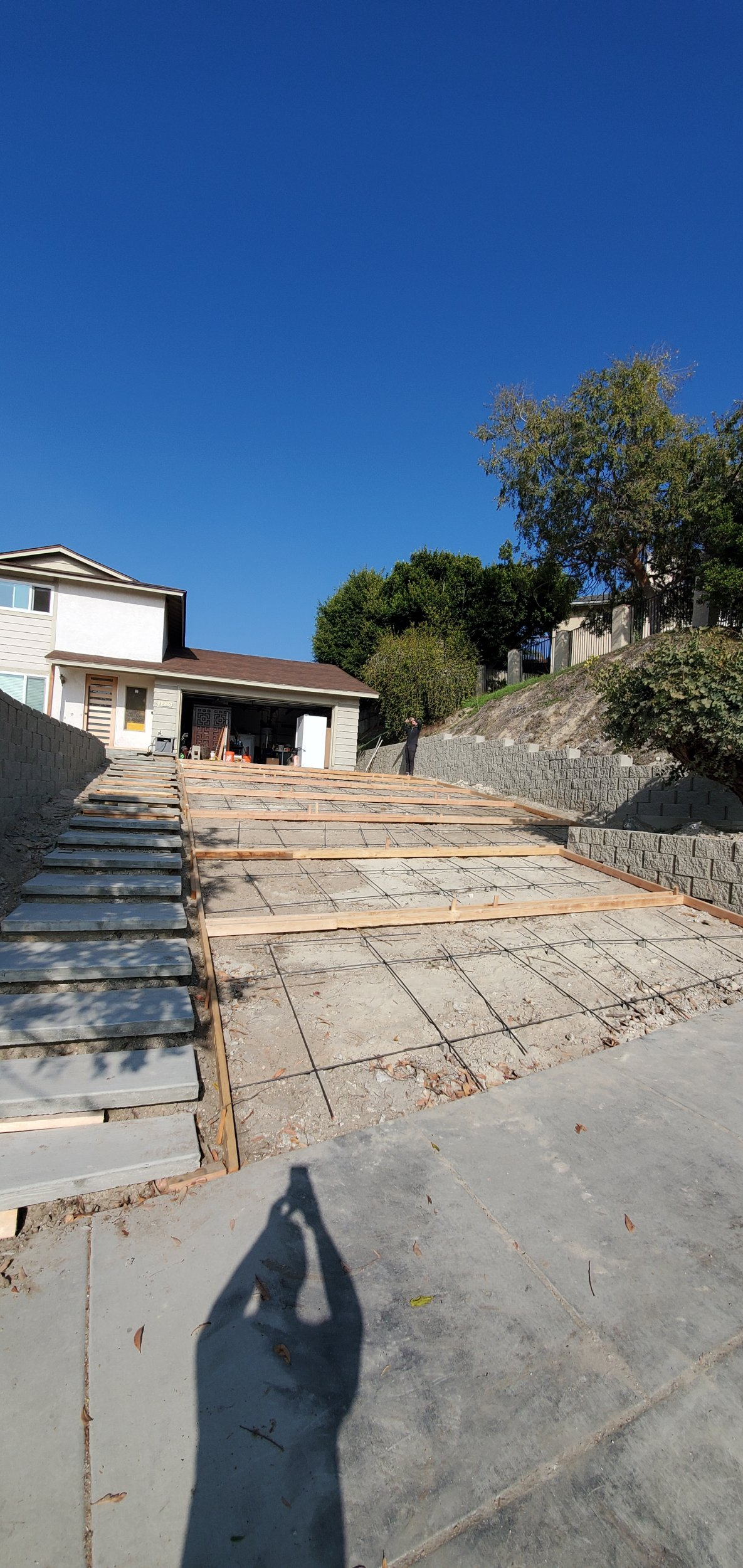

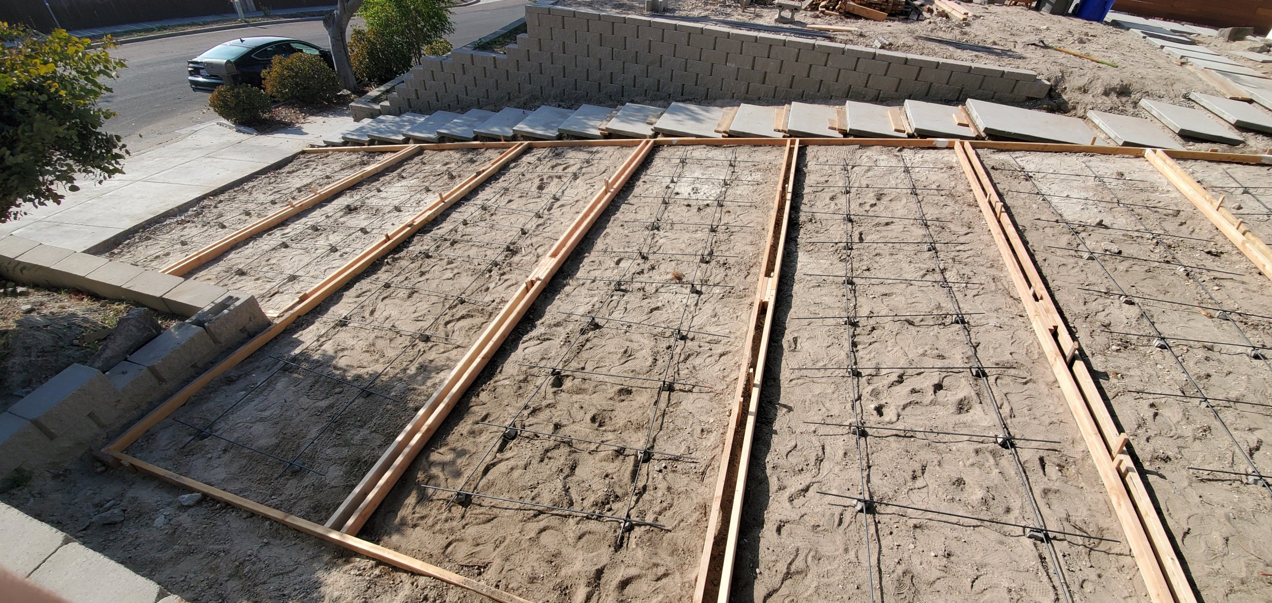

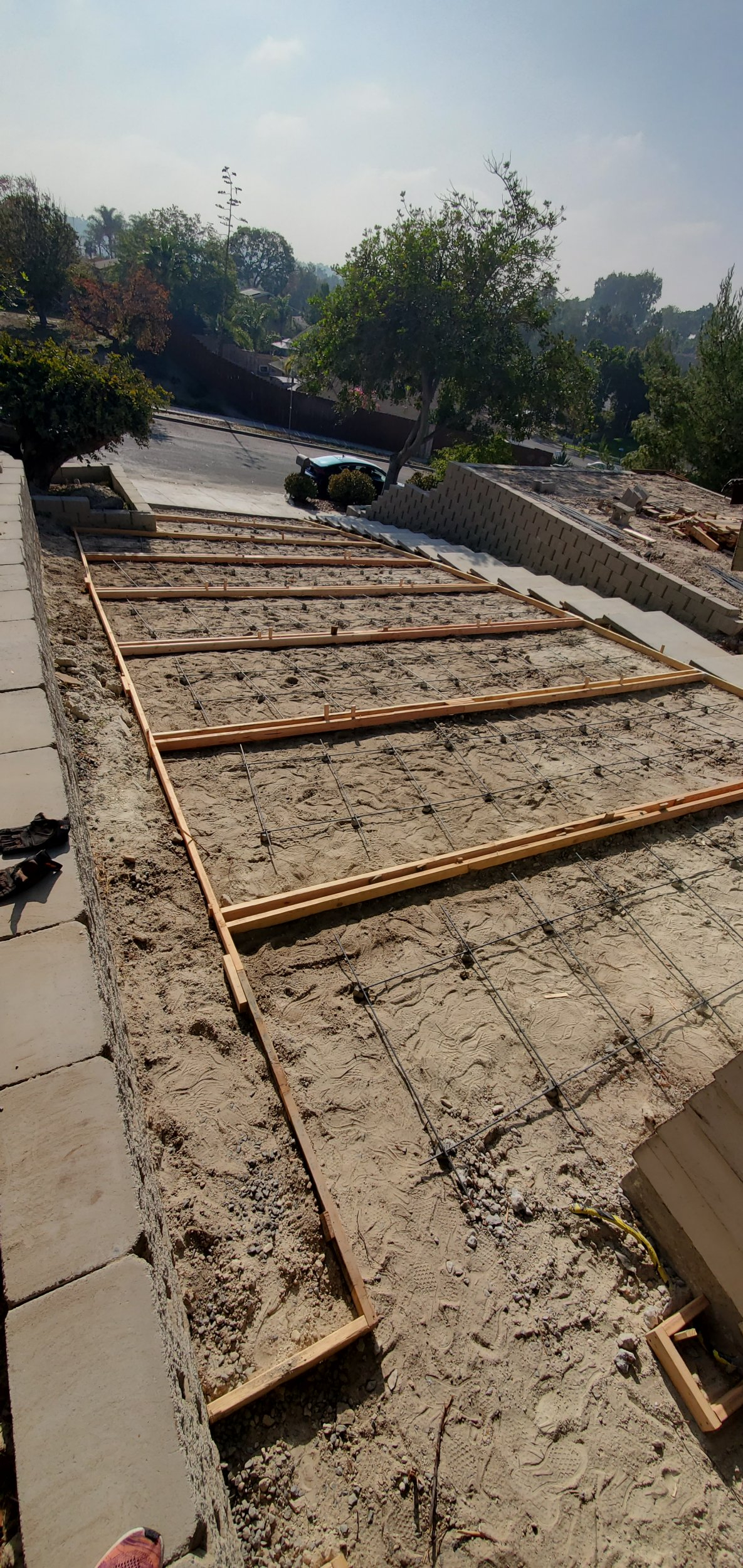

Pouring tomorrow morning.
Cost on this one is:
19 yards of concrete $2,805
Pump truck $500
Finish crew $1,200
Rebar $300
Lumber $180
Total $4985 for 1200 sq ft.
Add $1,950 for removal of the old driveway.
The first project with steps was about $4,200 including some discretionary stuff so all in we're up to $11,135 for 1,700sq ft.
Lowest quote was $13 per sq ft for the same spec so that would have been $22,100.
