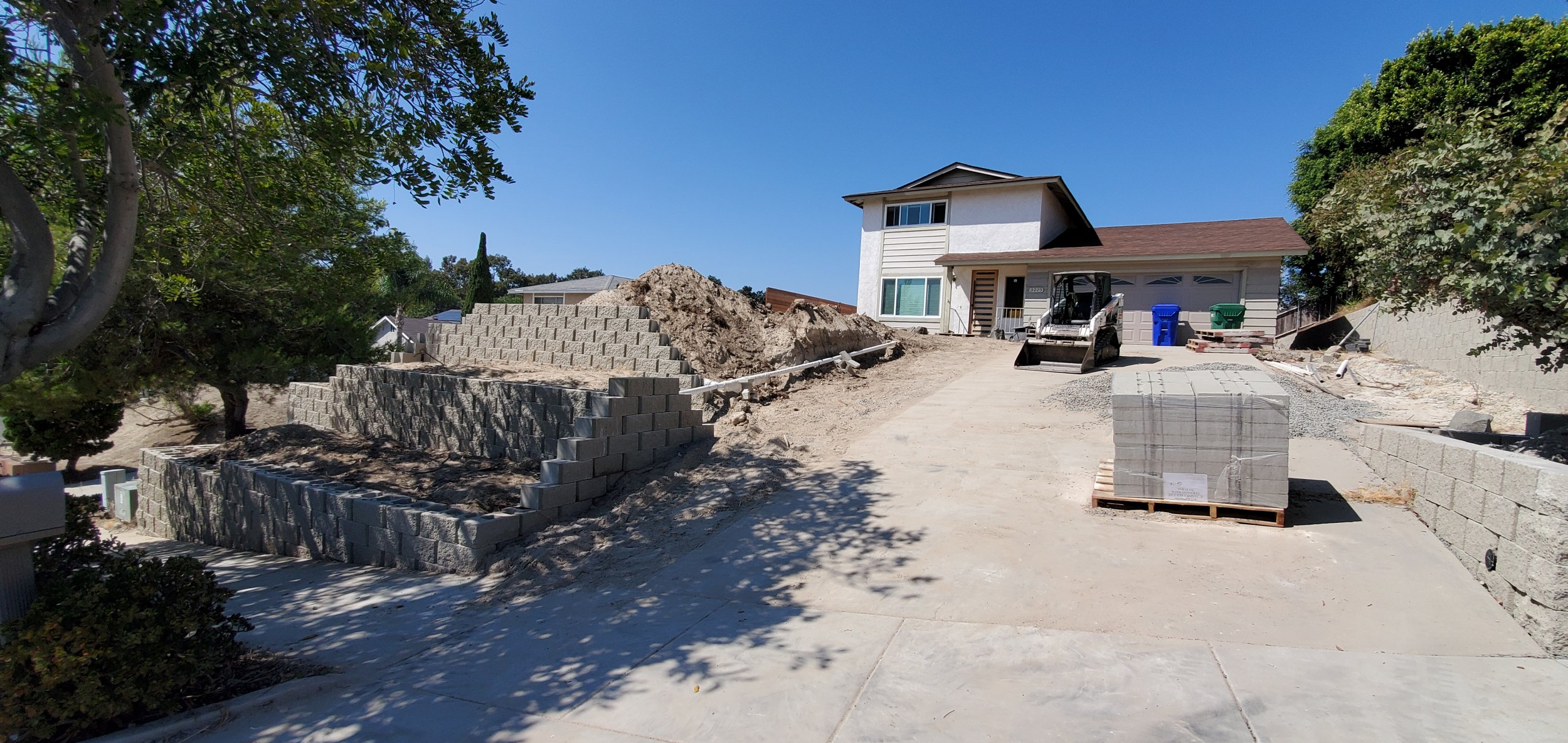

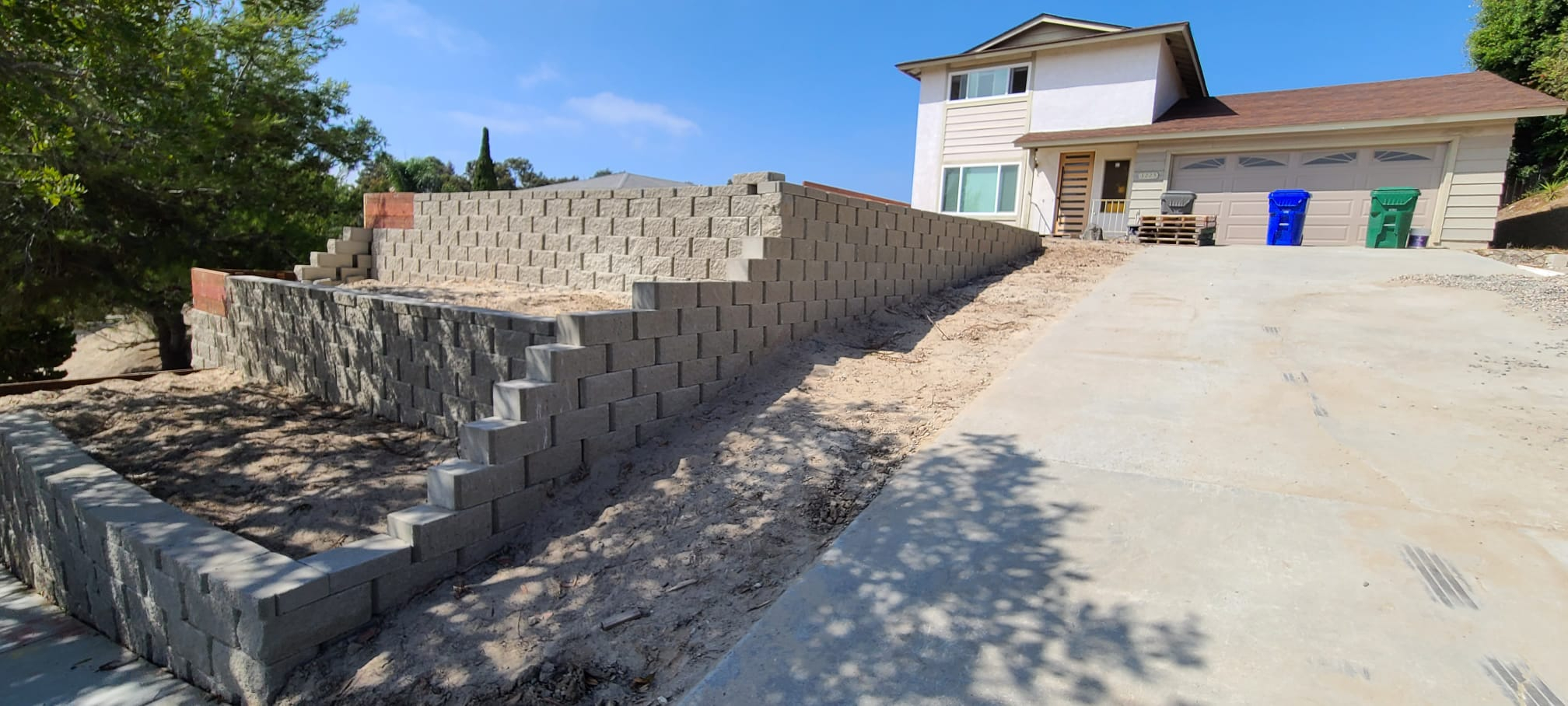

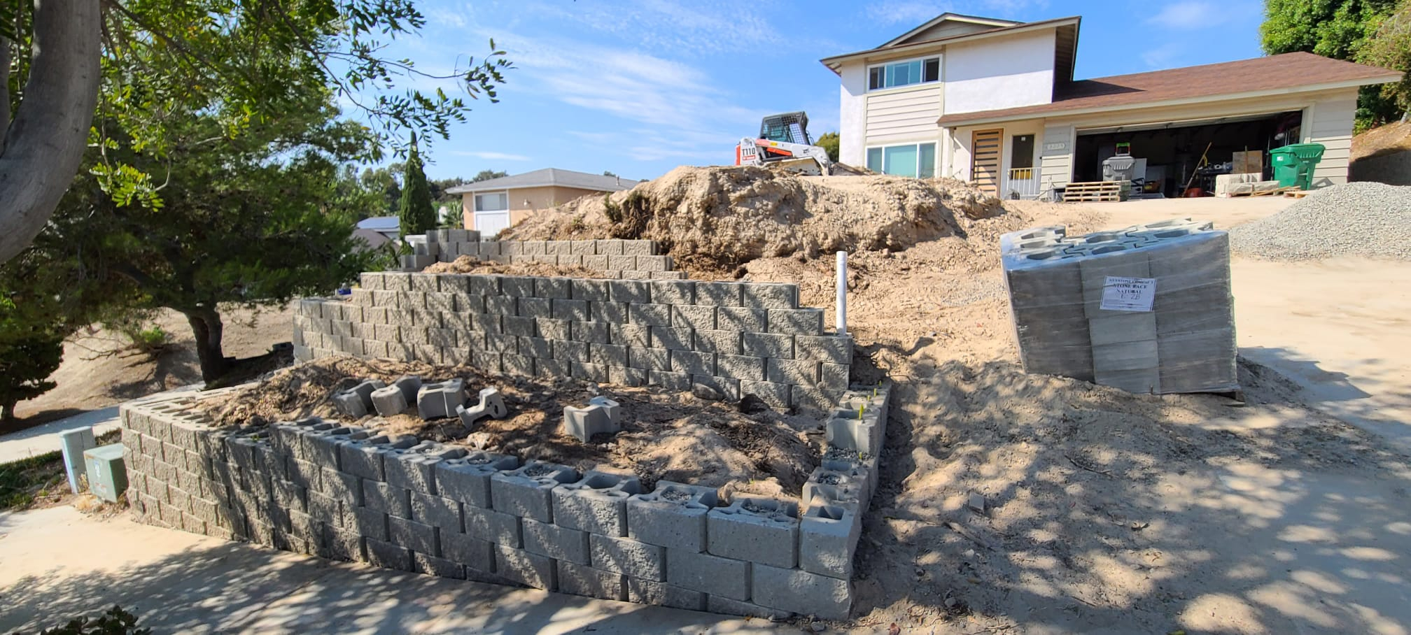

Finally something exciting to report. We were (well I was) backfilling the second tier with the bobcat and the ground was loose and the course of blocks below was not filled with crush rock yet and apparently I bumped the wall with the track and knocked the entrie thing out of alignment. So that was an hour of taking apart yesterday's work and fixing it. But in the end we got a lot done today, working on the third and final tier. Also made a decision to integrate planters on the ends of the tiers where we are already at the 4 foot height limit but wanted to add more height because of the downhill slope.
Overall it's coming together nicely. Hopefully tomorrow we can finish the blocks and backfill since my one week bobcat rental ends Friday morning. I think we'll get it done. And if not all of the blocks are closer to the walls now so it should be a lot less hauling than the first 5 pallets. Only 2 pallets left.

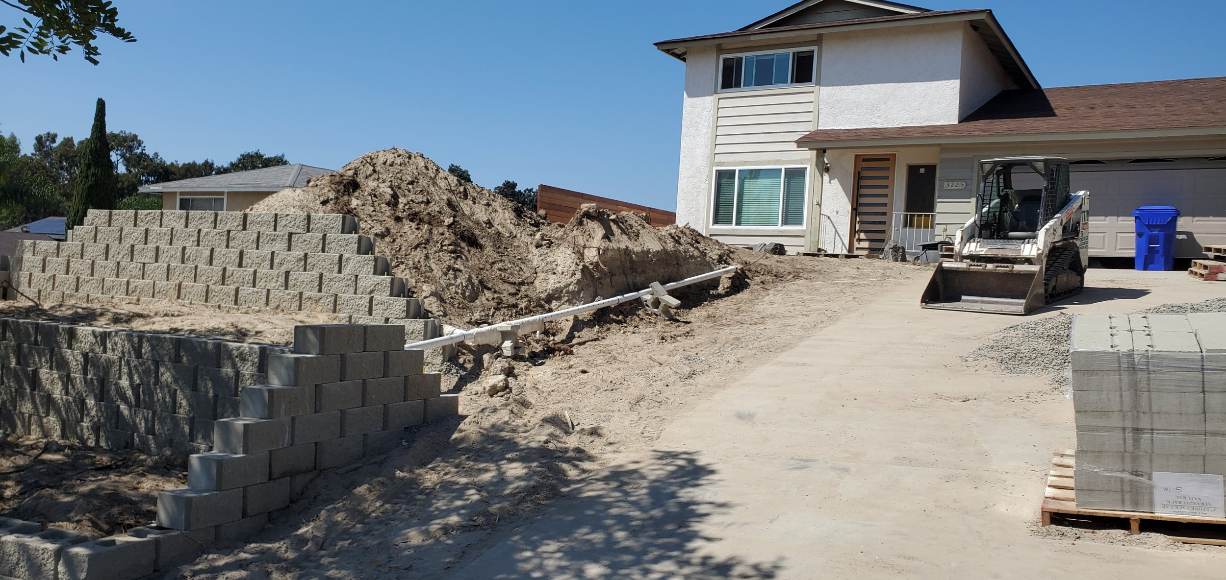

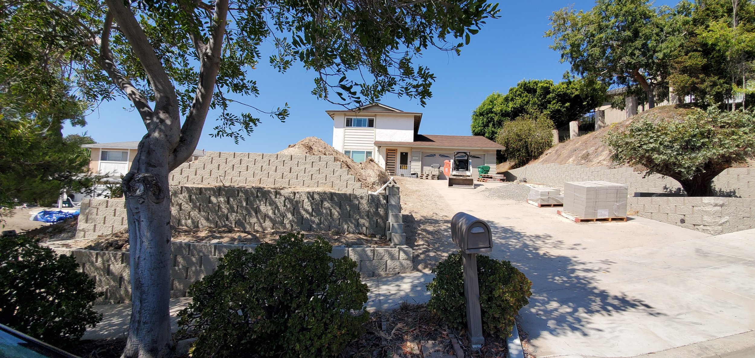

Got to the point of running out of blocks and the next delivery is coming on Monday so I'm done with the dust bowl for a while.
I have to say that the "little" Bobcat T110 impressed me. It packs the typical skid steer power but with better maneuverability thanks to a 48" width.
Also I had a chance to use two different T110s because the first one had a problem with the fuel system losing pressure and not starting without the system being primed. That machine was also running rough, and the hydraulic pedals were both very sticky which can be dangerous. Only 1460 hours on that one, but being a rental and a skid steer you have to figure that those are not easy hours.
The replacement machine had 1380 hours so not much less, but what a night and day difference. Everything was smooth and no issues at all.

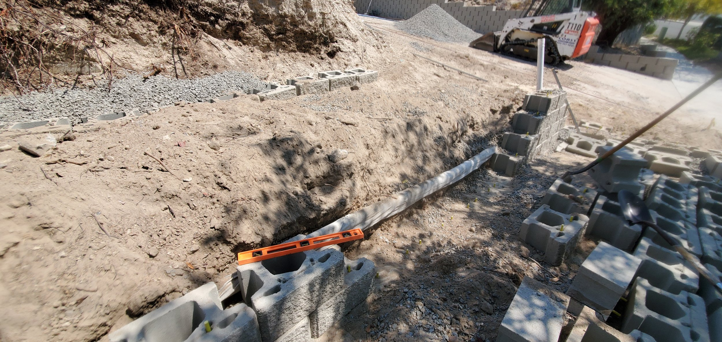

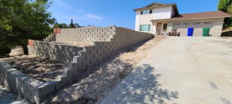

Another update!
Have a couple cuts left and need to wrap the planter boxes with pretty mangaris wood, but otherwise the walls are done!
We decided to add planter style trim on the outside edges to avoid stacking blocks above the 4 foot height limit. City trucks passed many times and never stopped so I think we're good.
Next step is some grading to do in preparation for lawn installation, sprinklers, landscaping, and a new driveway, steps, etc.
