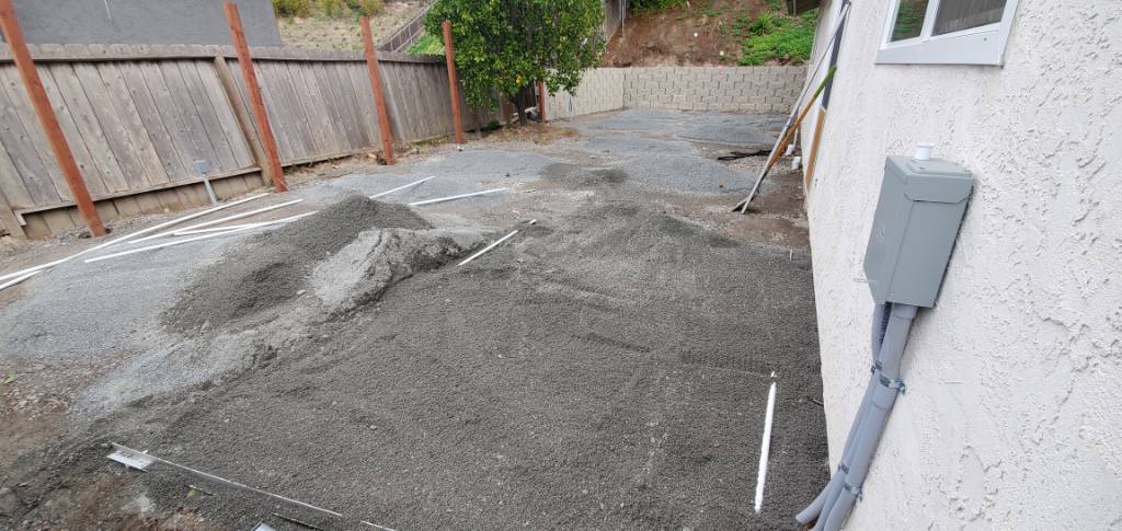

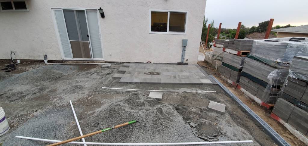

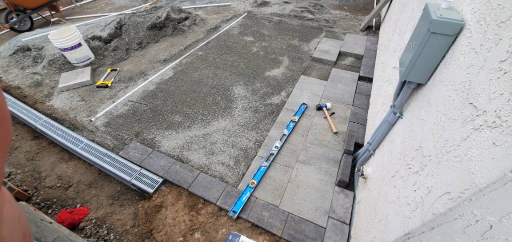

Muhammad, maybe I missed it, but what are you compacting the base with? I don't see a compactor in these recent pics. I hope you're being OCD about compaction..... I know you don't have frost, but still.
   / Retaining walls and patio
#162
We compacted the class 2 road base but the sand bed that the pavers lay on doesn't get compacted before the pavers go down. Instead we compact the pavers after everything is installed, and then again after the joints are filled with polymetric sand. That's the process the mfg recommended.
   / Retaining walls and patio #163
Ah ha! Thanks for the explanation.

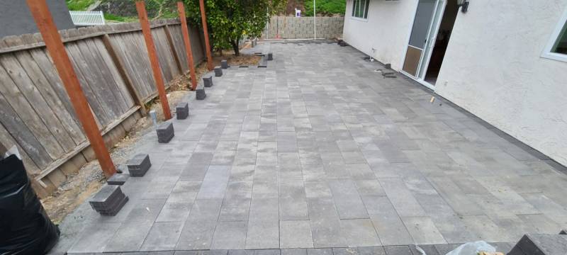

Before you know it the patio will be done.
Not pictured: All of the tricky cuts are saved for last. IMG-20210203-WA0000.jpeg
