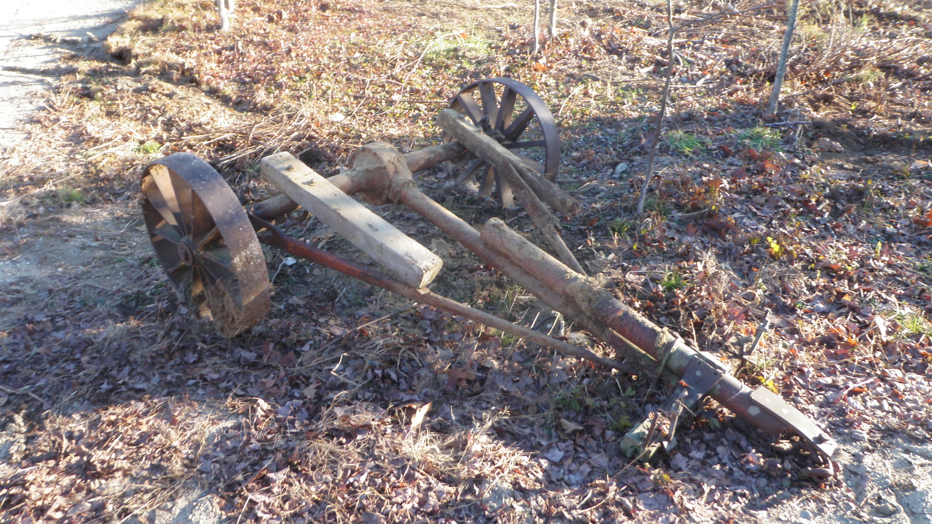

Resurrecting and old wood trailer my dad used 30 years ago. Dug it out of the field right where my mother said it would be. I was fascinated by how well he U bolted on the old timbers that he used to attach to the frame. He always believed in being frugal, so he made his own timbers. Yes I guess on this Thanskgiving day I owe a great deal of gratitude to a father that took the time to show me the value of hard work, and building things yourself.

Was the frame initially designed for a trailer? It looks like it may have been adapted from another use.

is it actually driven? it looks like it was made from something else or was designed to be drive shaft coupled to whatever was pulling it.

Probably some old car rear re purposed. I had an old wagon similar and one winter I was getting some wood and the tires were locked up. The pumpkin was full of water and it had frozen. Resealed and filled it with a mixture of a tube of grease and some old oil we had around.

The way the wheels are hooked on has me fascinated. Do they use the axle connected to the differential? It looks like the origonal wheels might have been removed and a different axle, wheels and all, bolted onto the existing housing.

I think that began life as a Model A Ford rear axle. Sure looks like it!
   / Resurrecting the steel wheeler #12

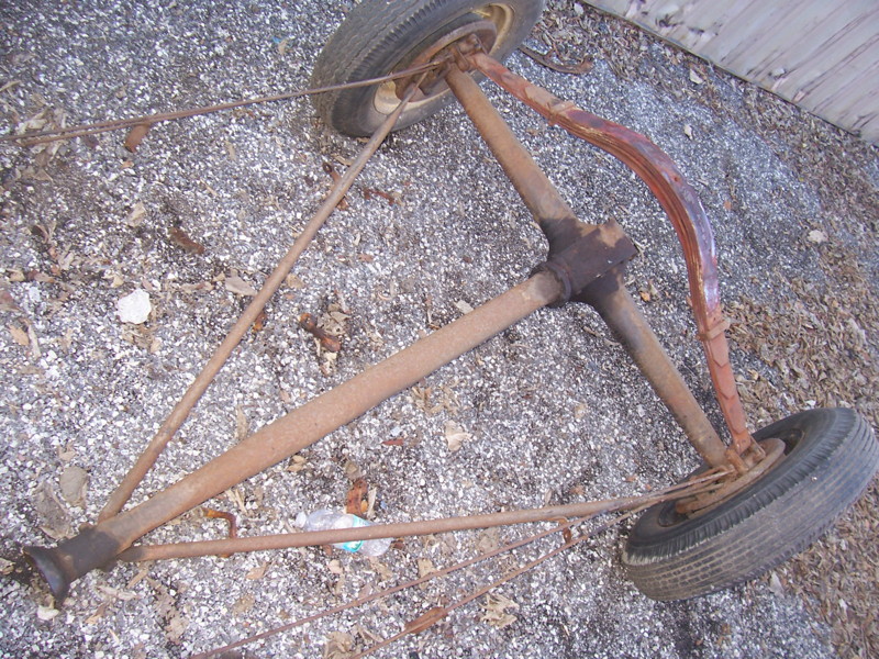

Looks like a Model A Ford rear end:

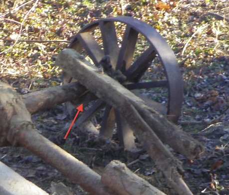

But the steel wheel centers do not line up with the Ford axle housings. On the right side of the first photo, it looks like another stub axle or spindle welded underneath the Ford axle housing.

Oh yes, you are right on. It is a collaboration, the rear axle from a model (t, or A) perhaps, the steel wheels from an old sickle cutter, welded onto a 4" pipe. yep a bunch of things put together.

it looks like Ford Banjo Rearend and were used up into the 40's,
wheels are off of some thing else, or home made,

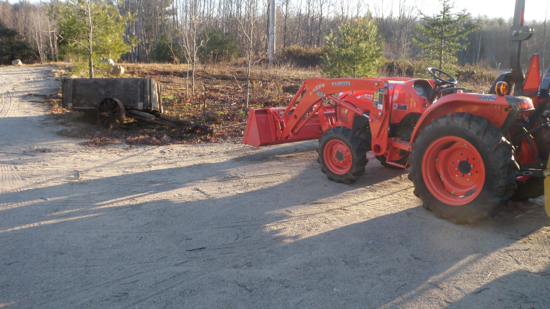

I am currently building a carry all from the frame bought out of TSC. I am using the same principle using all the scrap metal and such to bolt down and make sides and metal stakes for wood hauling on the farm. No metal on this rig will be new except for the frame that I bought. It takes more time for sure, but it's therapy for me as well.
