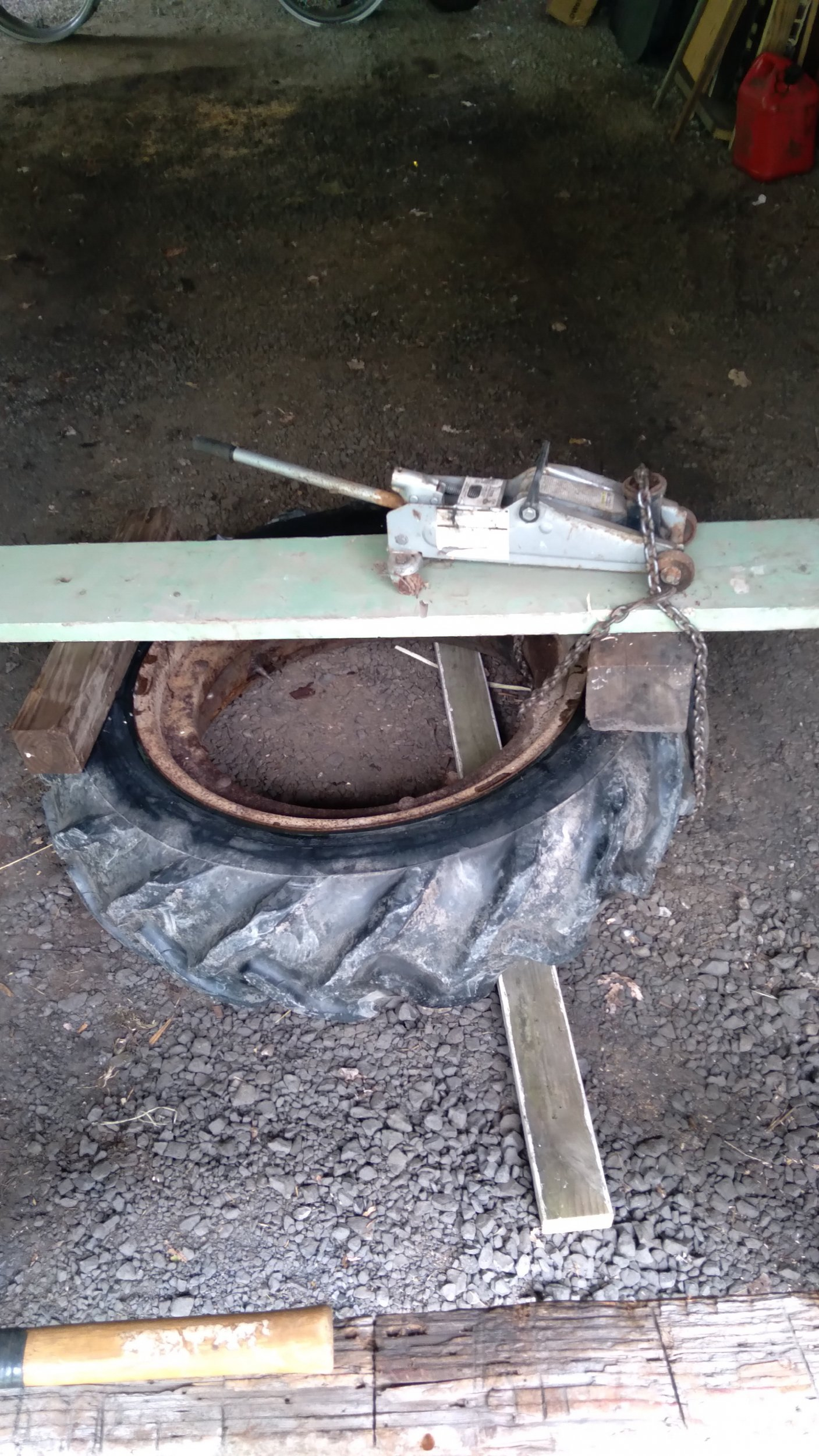

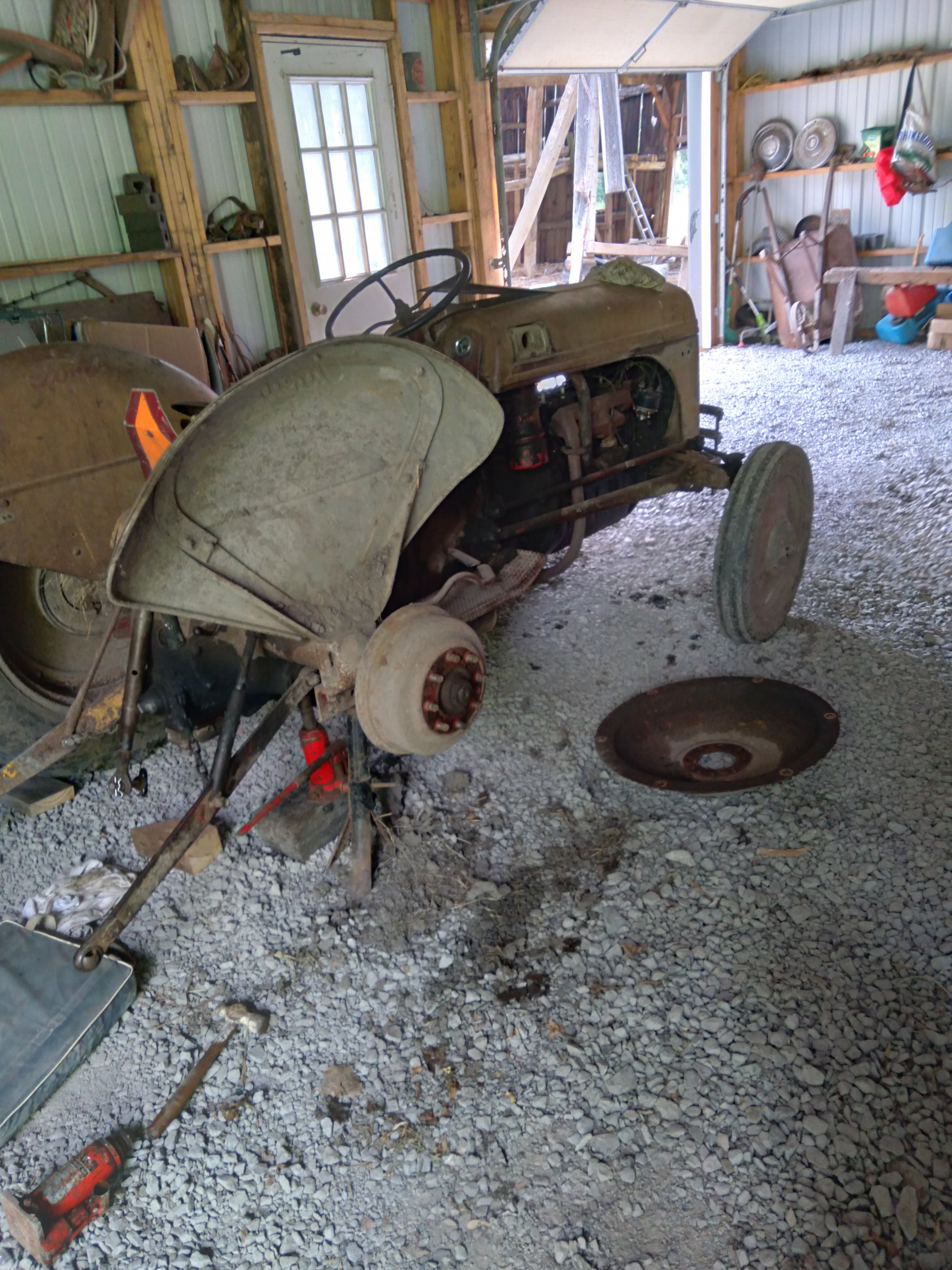

Changing the old rim was not that difficult, although I did have a few tough challenges to overcome. I needed a long pipe on the handle of a 3/4" breaker bar for leverage to break loose the (6) 5/8" fine thread carriage bolts that held the center section on the rim. I was able to salvage and reuse only (2) of those. I replaced the others with standard coarse thread nuts and bolts of the same length.
My little floor jack didn't have enough power to break the bread with a plain rectangular wood block and chain. Trimming that block with a chainsaw, to match the rim curve, allowed me to put the little jack force right where it was needed to get the job done.
One final challenge was getting the old tire off the back side of the old rim. I finally succeeded by sticking a long crowbar all the way across, and beating it off with the flat side of a splitting maul.

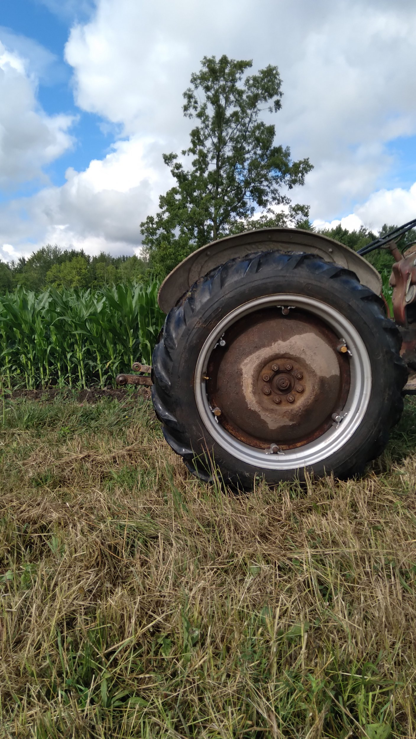

Here are some photos of the custom wood block that I trimmed (I will save that for when I need to do the other side), and of the finished job. The other one is the last time I had it on my corn planter.
   / 1951 8n rear rim change
Look at the size of the hole in the old rim. I cant believe that I made it thru my spring plowing this year with it like that. They must have used some strong natural rubber on the inner tubes back in the early 50's. A side benefit is that now my kids have a new, larger camp fire pit that they have been asking for.

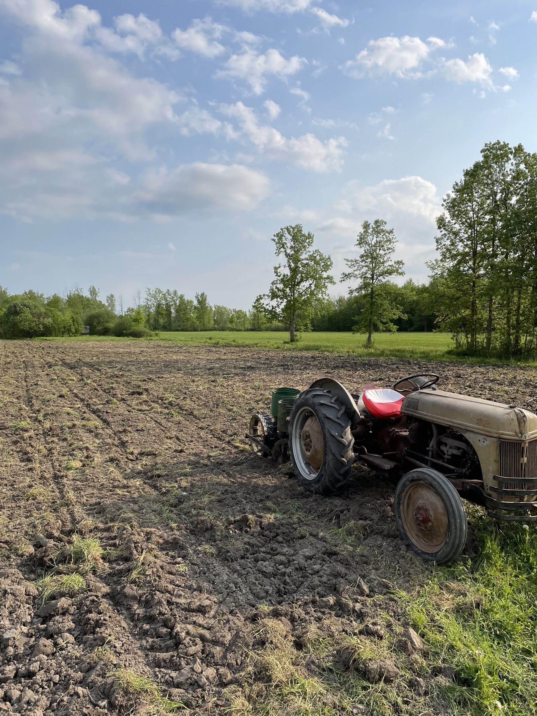

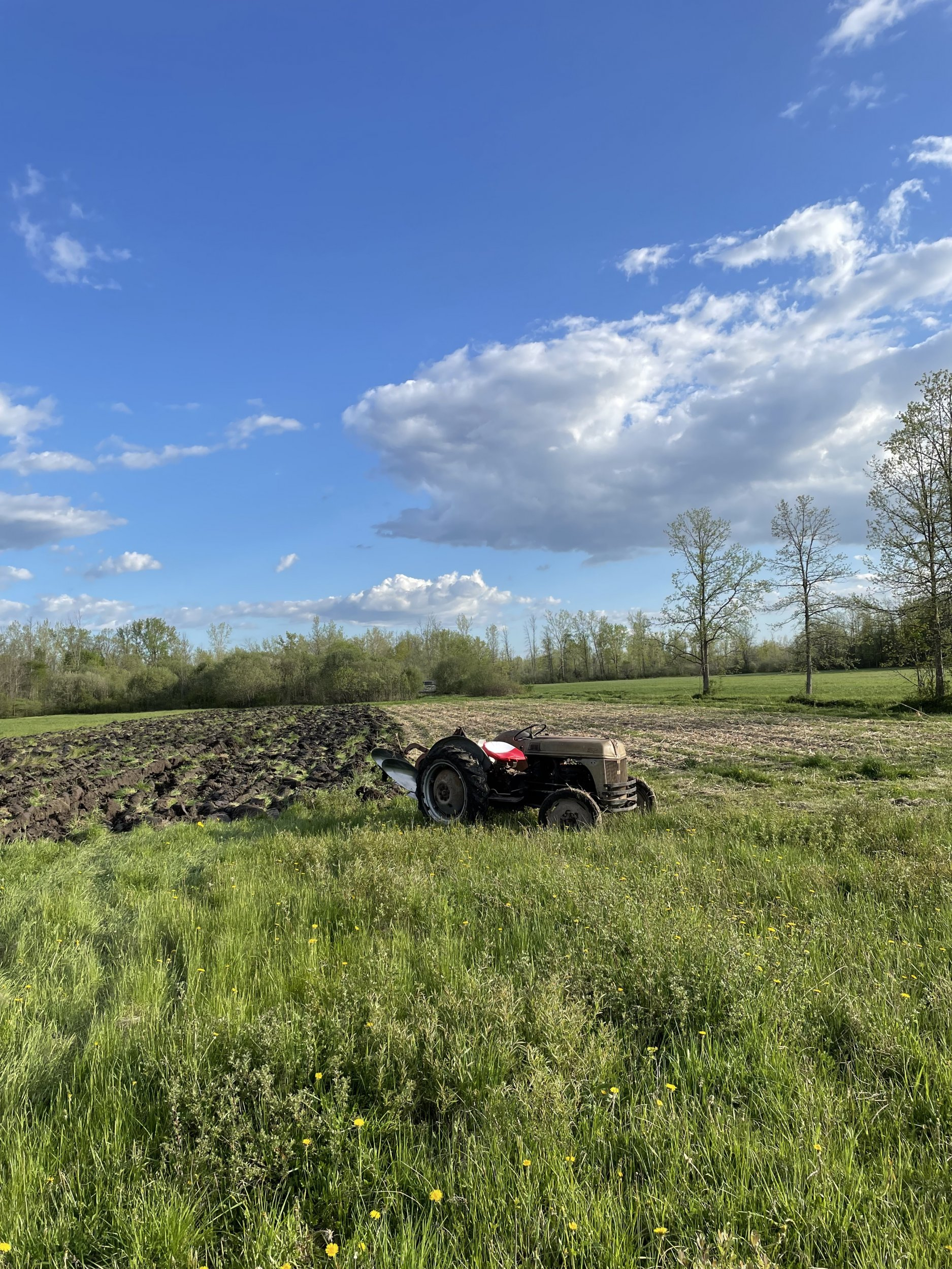

I finished up my spring plowing today, with just one loaded rim (the left - sod side). It worked almost as good on the 2 bottom plow as it always did with two loaded rear rims. The soil moisture content was just about perfect today, which probably helped out a bit.
