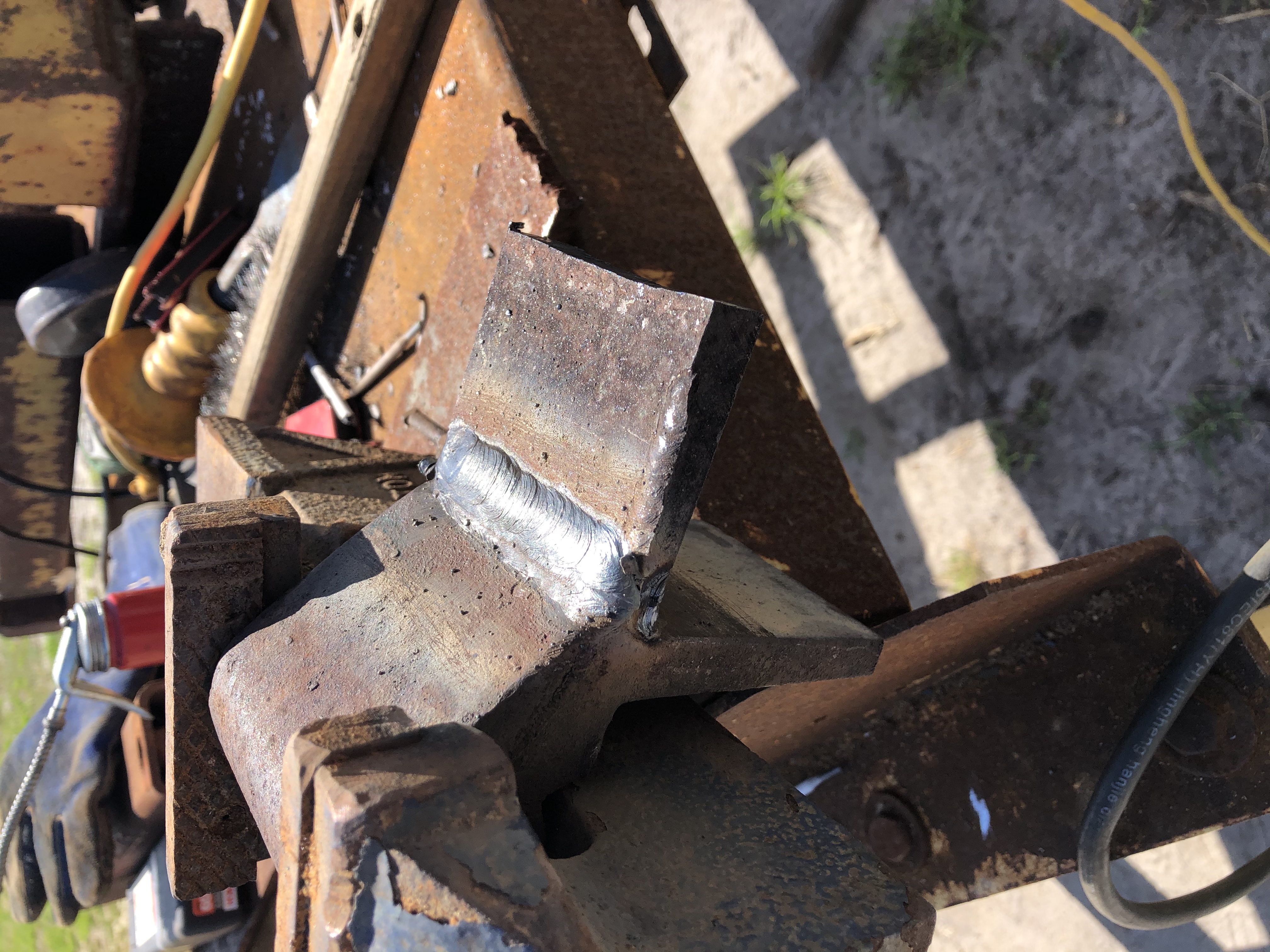

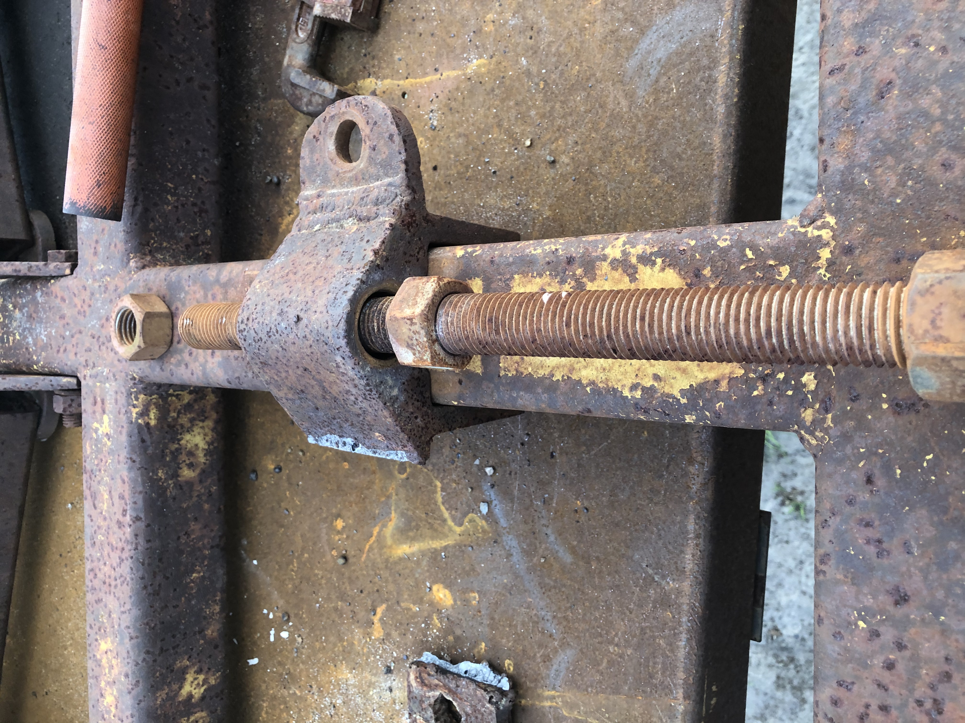

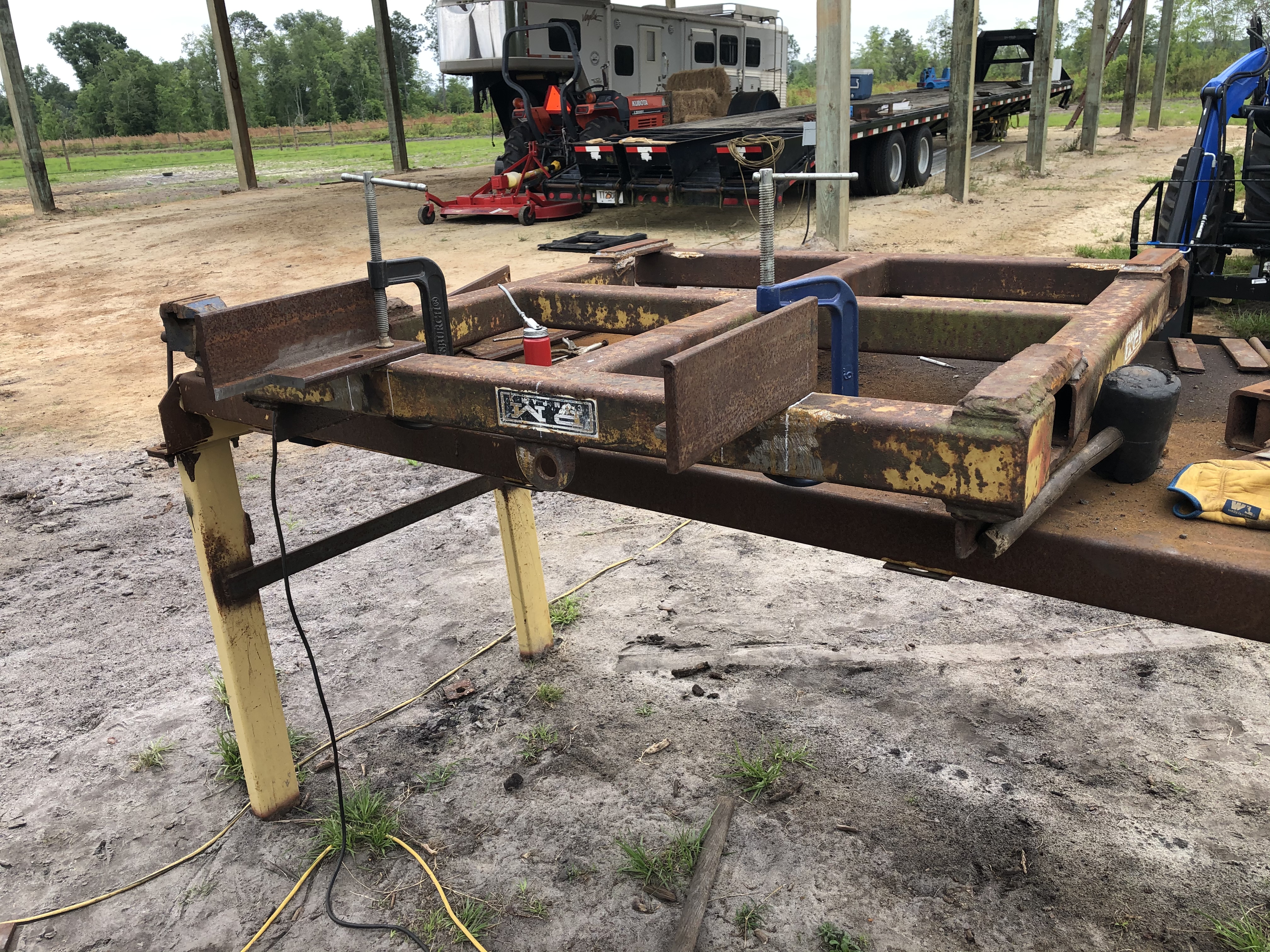

Happy Easter everyone!! I cut out and repaired a lot of stuff yesterday on the disk frame that had been previously fixed before and just looked horrible and waiting to fail, rewelded a few plates that had cracks, and added some new bracing. I removed the existing 3pt hookup yesterday also and going to weld in some new brackets and move the hookup 4” lower than it was so my 32hp kubota can use them also, brackets are to high for it to lift much.
/ Restoring PM disk harrows
#12
Cut out, added new plate, beveled both sides and welded back out.

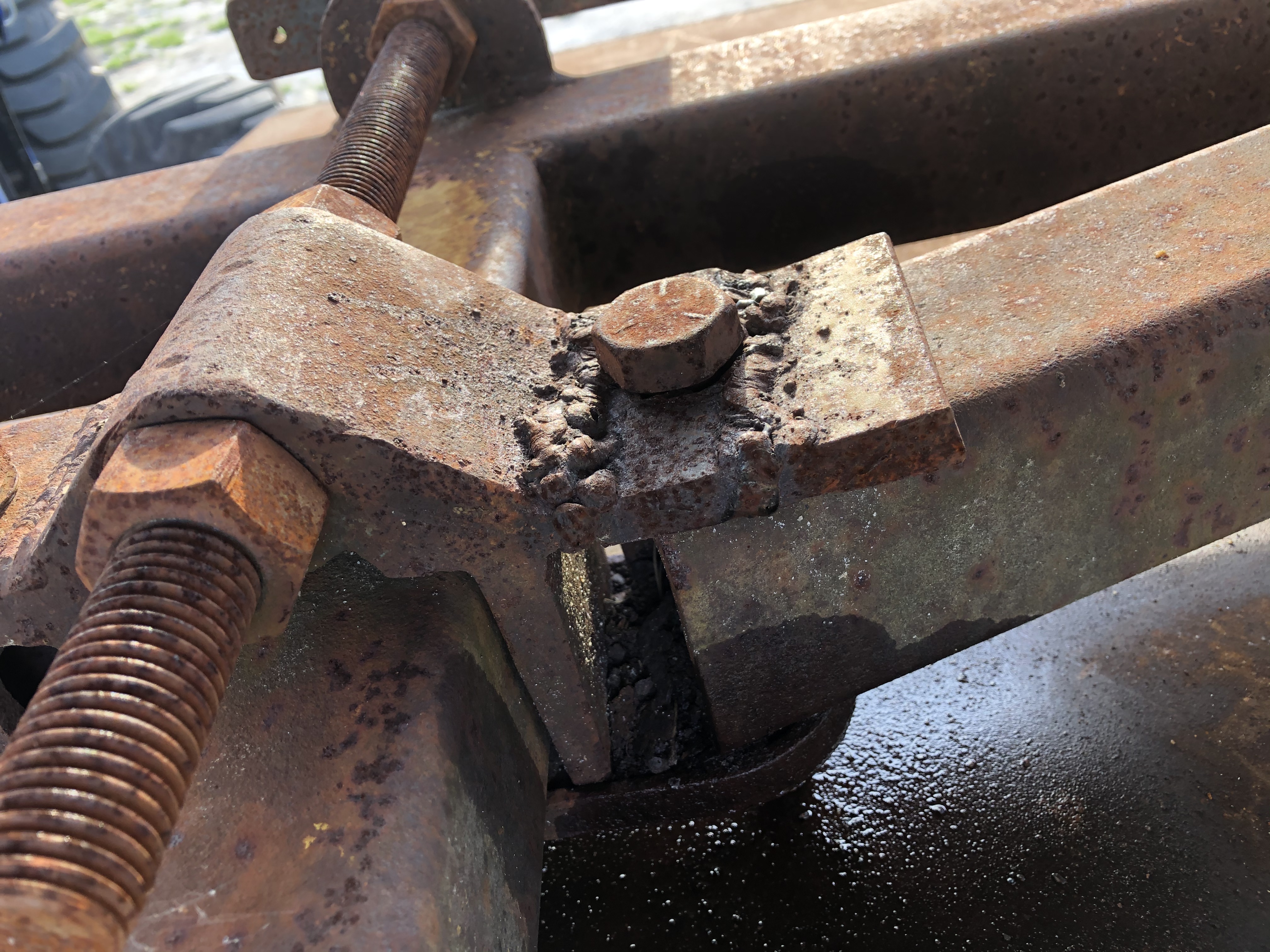

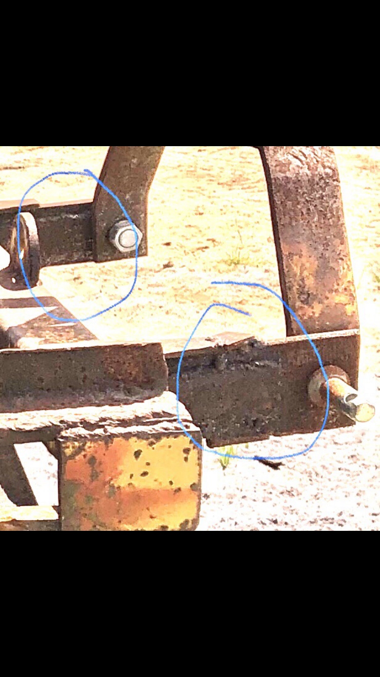

That is about the worst welding job (middle photo ) I have ever seen. Lucky I didn't just fall off after the original repair. Heck a blind beaver could have done better.
Your welding looks great!!
HAHA!! And I appreciate that man, I was a little rusty not touching my welder in over a year.
Here is another hack job on it, I completely cut these off and making new brackets.

#18

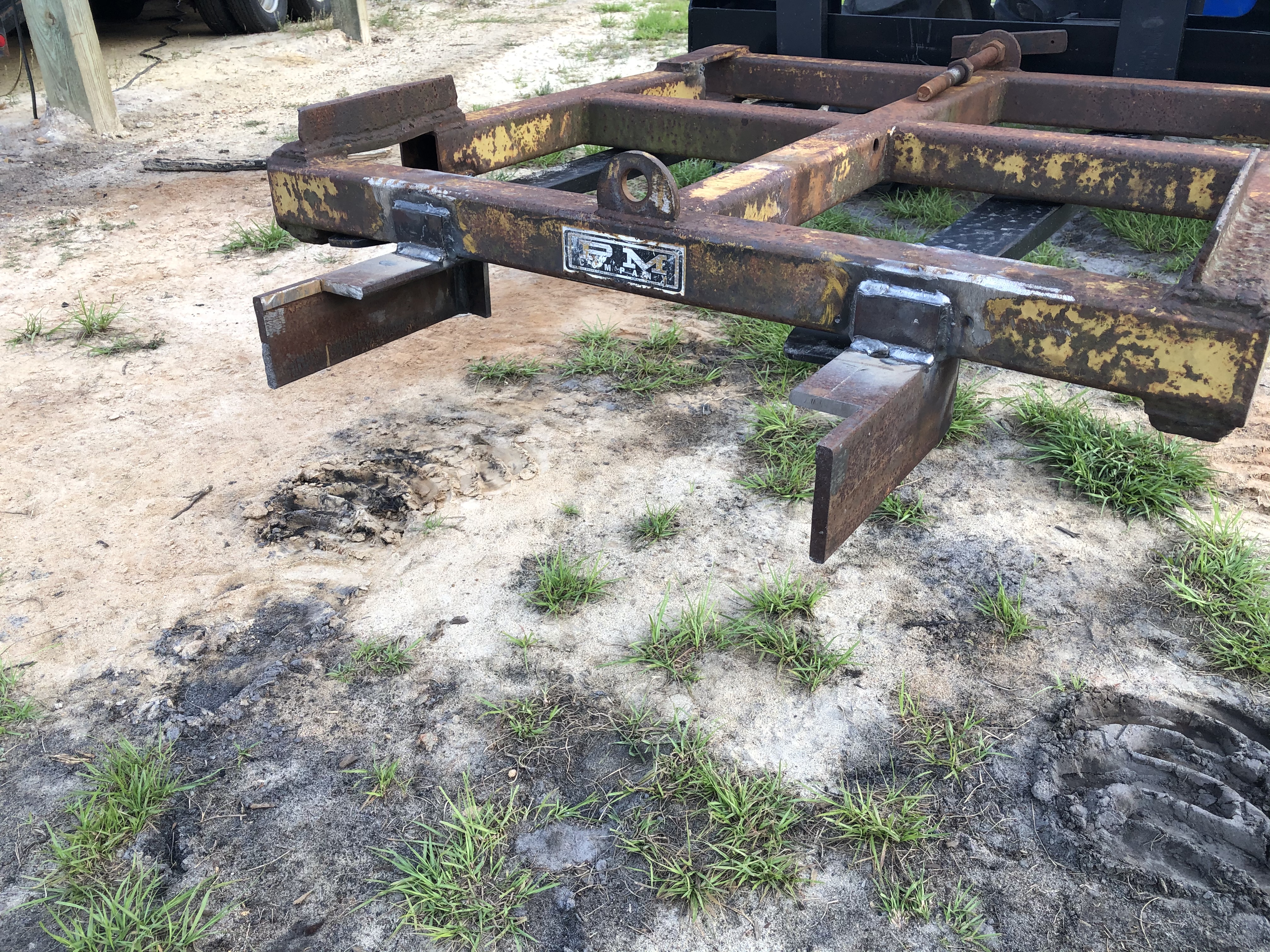

Cut, squared, and about to tack and weld the new 3pt hook up bracket

#20

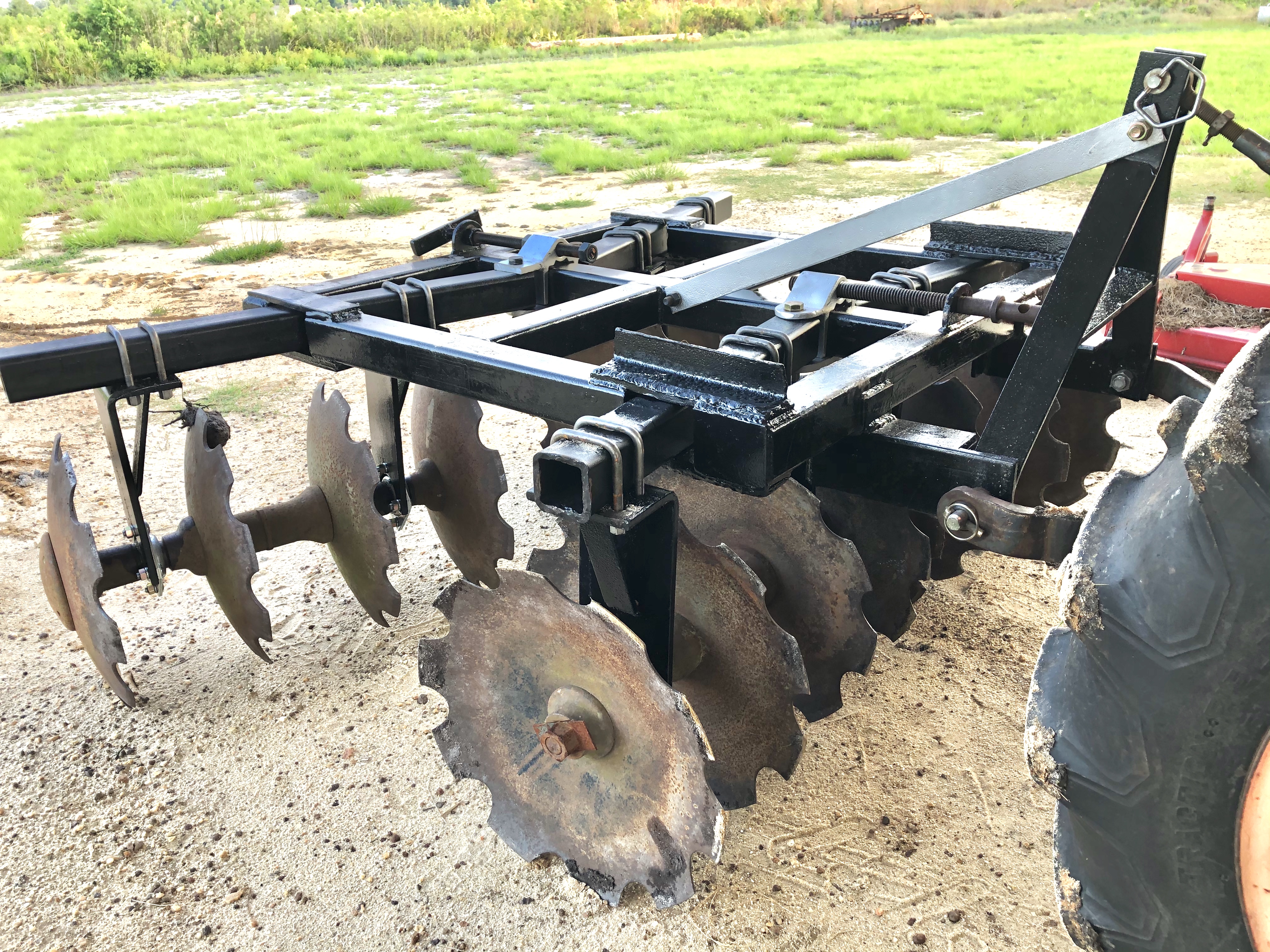

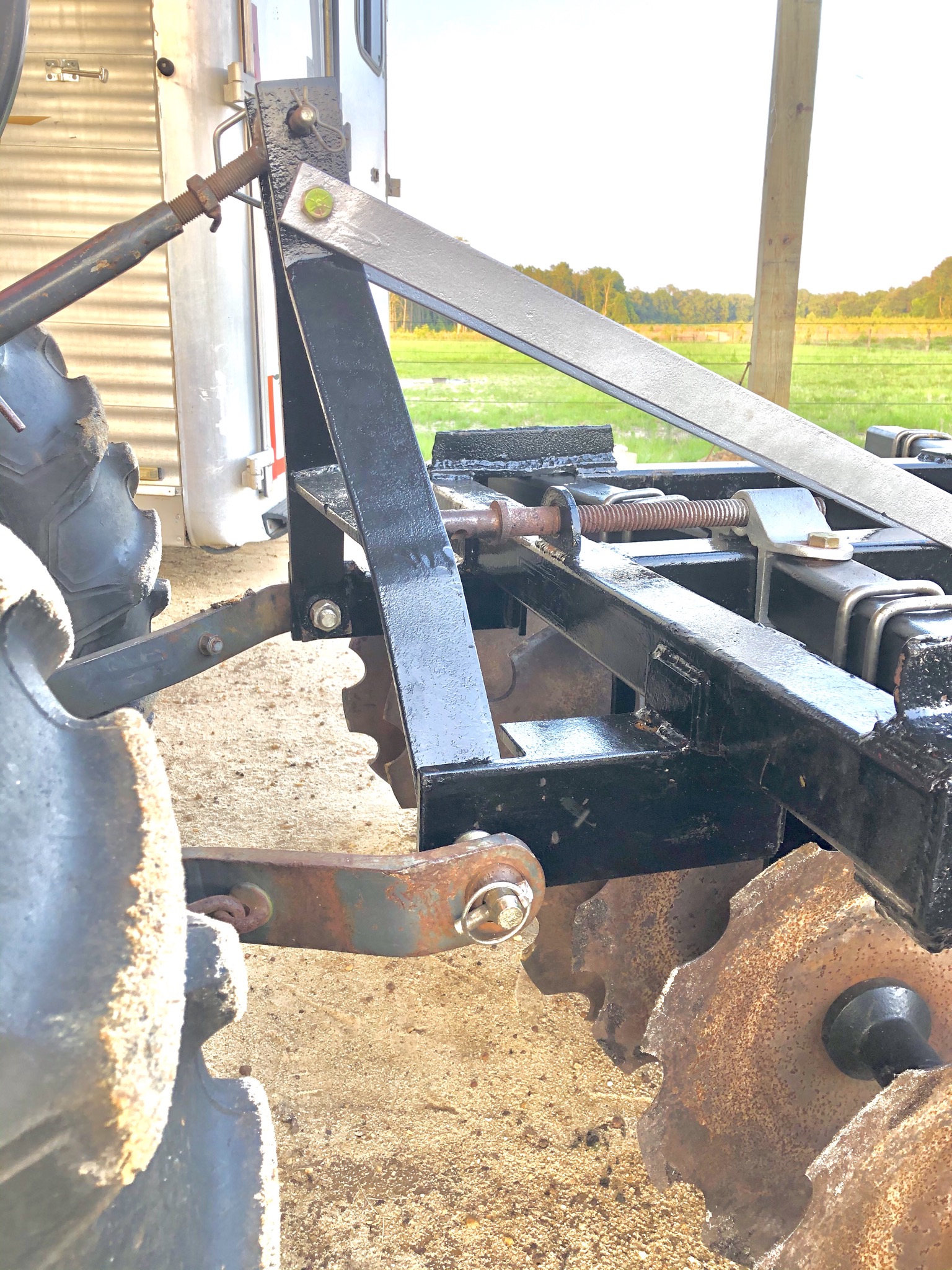

Need to drill holes for hitch pins and bolt in Top link frame hook up. I used 1/2” angle iron for the main hook up bracket notched for the top link frame, and 3/8” flat bar for added support to spread the load from the pins. Should be good to go I hope.
Now to sand, prime, paint, and put it all back together.
